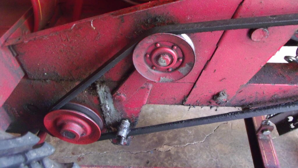

Belt looks brand new and is the detentions I was given

If the bearing is shot in that tension pulley, I think it can be fixed.  Take a good picture of it and post it here.  @WHX?? might be able to do that for you or tell you how to do it.  :thumbs:  Is there a tab on top of that bearing?  It should be positioned so as to keep the belt in place.  No tab on my 857.
Somewhatsober1
Yes there is a tab. When I depressed clutch belt hits the tab and comes off tensioner
stevasaurus
See if you can adjust the tab or tap it so it does not hit.  Try to close that gap a little. A hammer can be your friend here. :eusa-think:

All gears high and low are in working order now after I bent tab over a little more on tensioner pulley, the belt stays on now.
  It makes a pretty good whining sound from the pulley coming off the motor is that normal or does that need to be adjusted as well?

I'm going to guess that your pulleys are not all in the same plane. Since you have the cover off, you can check that with a good straightedge.
Remember that the belt is rotating counter-clockwise so it's likely something between the engine and the tensioner pulley that's causing it, but a bent transmission pulley can also be a problem. Of course, any excess wear spot on the belt or cut/crack can trigger it being thrown.

If it's the tension pulley, try a few DROP of 3 & 1 oil.  It appears to be OK.  Put the guard back on and take her for a ride.  You mean the hi/low range shifter works now also??  Remember to come to a complete stop when changing gears.  Check oil in trans.  :occasion-xmas:
   I'm thinking the guy that put a new belt on bent that tab to get the old one out and the new one in there.

Yeah I’m assuming that’s what he did as well with the tab and I think high range wasn’t engaging because the belt would come off as soon as I hit the clutch so it was never able to idle down enough for it to pop in just grind, and I checked tranny fluid it looks like it was just changed

The back of the drive belt should be 5/8" wide. In the photo it looks narrow and deep in the pulley.
:text-yeahthat:
Just looked closely at the belt. Cracked and rough and smooth-sided. Candidate for replacement in my book.

@Somewhatsober1  that whining noise is probably idler  pulley , you can get the same thing if you want , or if you have a local bearing distributor  near , bring it with you and get the same type and size with a bigger bearing , probably with wide rubber side shields , that can be removed , cleaned out and refilled with lucas xtra heavy duty grease . pick up a bronze insert for  the bigger bearing, with a 3/8"  ID . bolt it right back in place , no noise or failures . just an idea , pete
