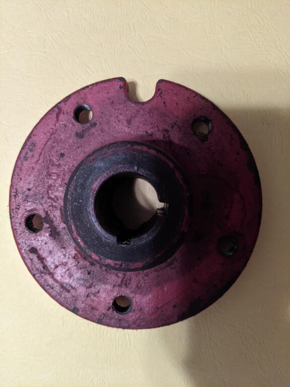

Wheelhorse#1 1,712 #1 Posted November 7, 2021 (edited) Hello all When removing the hubs to inspect them I noticed some play,I added a vid to view .I’m not sure if this is something like bearings or something els or normal ? I’m going to replace the seals ,there on order.One hub is worn at the keyway so I’ll probably replace that as well as a extra thumb screw with jamb nut and thread locker on both. It’s a sunstrand auto and seems to work fine otherwise.It does make some noise when off the ground and in forward gear..normal? It’s strong when up against a object and put in gear, it will dig in and spin tires. I changed the trans fluid and filter with proper type.Is it difficult to replace the outer needle bearings? I guess someone replace a hub at some point as it looks different,more beefier than the other . Thanks Ill need a hub so I’ll look in the wanted ads here. Edited November 7, 2021 by Wheelhorse#1 Share this post Link to post Share on other sites

Wheelhorse#1 1,712 #5 Posted November 7, 2021 5 hours ago, stevasaurus said: That play is perfectly normal...in and out 1/8". You are just butting up to the other axle. It is the side to side and up and down that indicates a bad bearing. It looks like your outer bearings are just fine. It is not hard to change out the outer bearings...drain the transaxle, drop the transaxle, split the case and pull out the differential, tap out the bearings, place the new ones and put everything back together...add back fluid. Not something you need to do yet. Thanks for all the advice .I should of added the reason I may need a another hub is the keyway is somewhat worn.I the previous owner used a bolt in place of a thumb screw in a effort to tighten down the hub and the key was mashed all the way down. I may just give it a shot and see if it will hold first,Hubs aren’t cheap. Share this post Link to post Share on other sites
ebinmaine 68,642 #6 Posted November 7, 2021 40 minutes ago, Wheelhorse#1 said: may just give it a shot and see if it will hold first,Hubs aren’t cheap Excellent used ones are about $40 or so. You may be able to get away with using what you have if you use a new key and set screw. Possibly could even repair your existing hub with careful use of J. B. Weld. Share this post Link to post Share on other sites

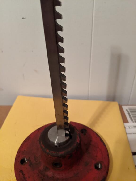

Howie 898 #9 Posted November 9, 2021 If the inside diameter of hub is okay. just put the keyway on the other side. Think I did that to one on my Raider twelve. Drilled a new hole over keyway and tapped for a bolt. Share this post Link to post Share on other sites
Wheelhorse#1 1,712 #10 Posted November 9, 2021 (edited) On 11/7/2021 at 5:42 PM, ebinmaine said: Excellent used ones are about $40 or so. You may be able to get away with using what you have if you use a new key and set screw. Possibly could even repair your existing hub with careful use of J. B. Weld. Yes AtoZ tractor has them for 50 that’s with shipping. Ill just try using the damaged hub for now.The keyway inside the hub has been chipped away closets to the screw.Luckily the shaft is still good. I bought new keys and screws and jamb nut from Mc Master.I bought a dozen this time.I’m seeing if your going to be working on or restoring these fine tractors the hubs will almost always need attention. Edited November 9, 2021 by Wheelhorse#1 2 Share this post Link to post Share on other sites
Wheelhorse#1 1,712 #11 Posted November 9, 2021 (edited) 18 hours ago, Howie said: If the inside diameter of hub is okay. just put the keyway on the other side. Think I did that to one on my Raider twelve. Drilled a new hole over keyway and tapped for a bolt. Interesting .How did you make the keyway cut for the key ,inside of the hub? Edited November 9, 2021 by Wheelhorse#1 Slow Share this post Link to post Share on other sites
Howie 898 #12 Posted November 10, 2021 Like this. 1 Share this post Link to post Share on other sites
Wheelhorse#1 1,712 #13 Posted November 10, 2021 Howie This is great ,how does it work, something you put together yourself ? 1 Share this post Link to post Share on other sites
pfrederi 17,930 #14 Posted November 10, 2021 1 hour ago, Wheelhorse#1 said: Howie This is great ,how does it work, something you put together yourself ? You have to buy a broach set and have a large hydraulic press I us my harbor freight 20ton press 1 Share this post Link to post Share on other sites
ebinmaine 68,642 #15 Posted November 10, 2021 8 minutes ago, pfrederi said: You have to buy a broach set and have a large hydraulic press I us my harbor freight 20ton press A video or pics of the process would be neat. 1 Share this post Link to post Share on other sites
Howie 898 #16 Posted November 11, 2021 I only have a small press, has an 8 or 10 ton hydraulic jack on it. Press it down thru the hub. There are shims with the broach, add one and push back thru. Repeat. Enough shims to cut it to the proper depth. I bought the broach and the bushing for the 1 1/8 axle. My press is not all that big, has an 4 ton jack on it. found the frame and added the jack to it. Had a screw deal in it so kind of primitive. 2 Share this post Link to post Share on other sites
