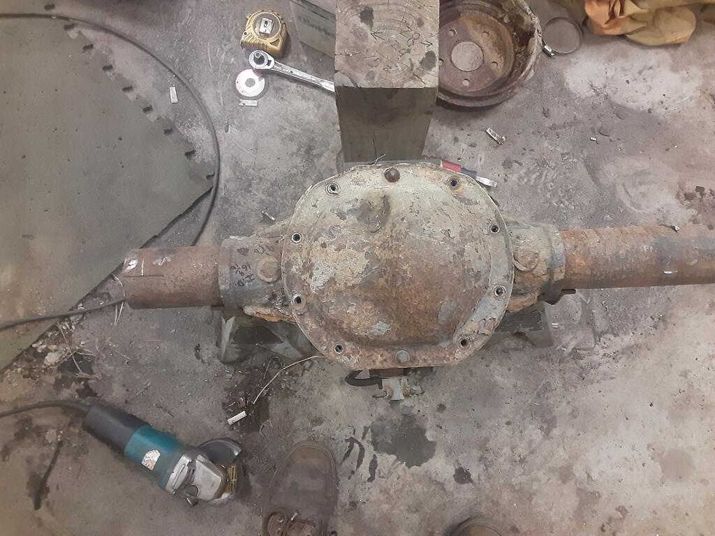

Oldskool
Getting ready to narrow things down a bit.
Revised measurements say the pinion is off center so recalculated is in order.
Also an unforeseen obstacle of there being a double step up/down in the axle tube.
  • Like 2

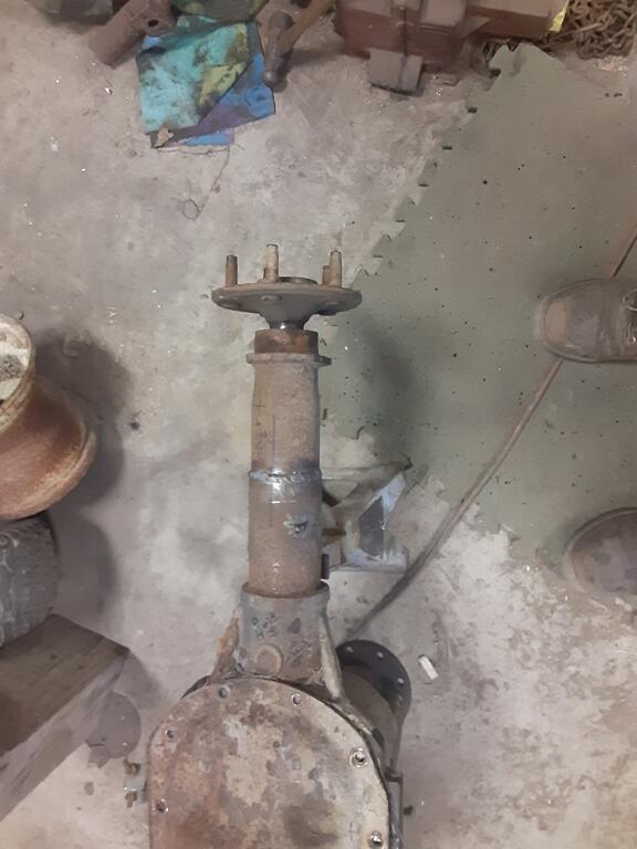

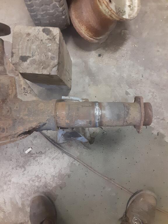

Oldskool
The rear axle narrowing is going somewhat according to plan.
It won't be long and I'll have a rolling chassis.
7-1/2" removed from this side.
  • Like 3

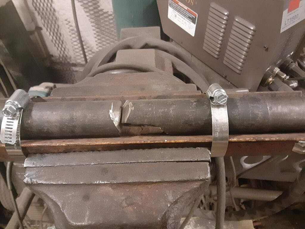

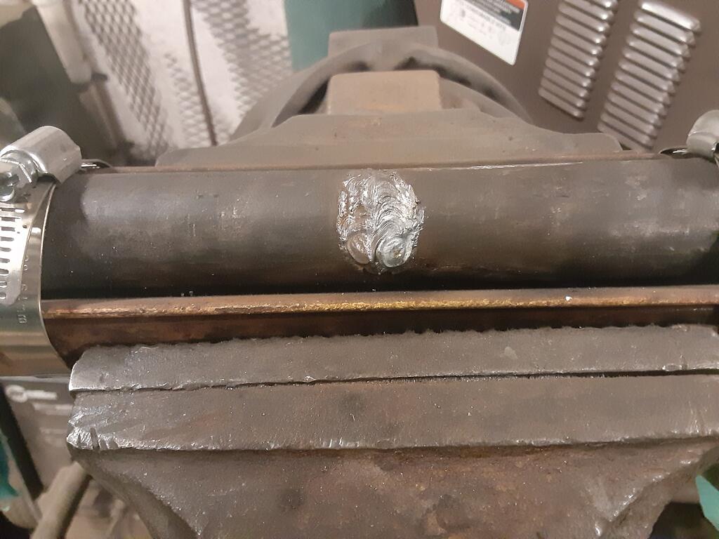

Oldskool
Halfway there.
I put the shaft in the lathe to spin test.
It spun out nicely.
Maybe the other half later today.
  • Like 4
  • Excellent 1

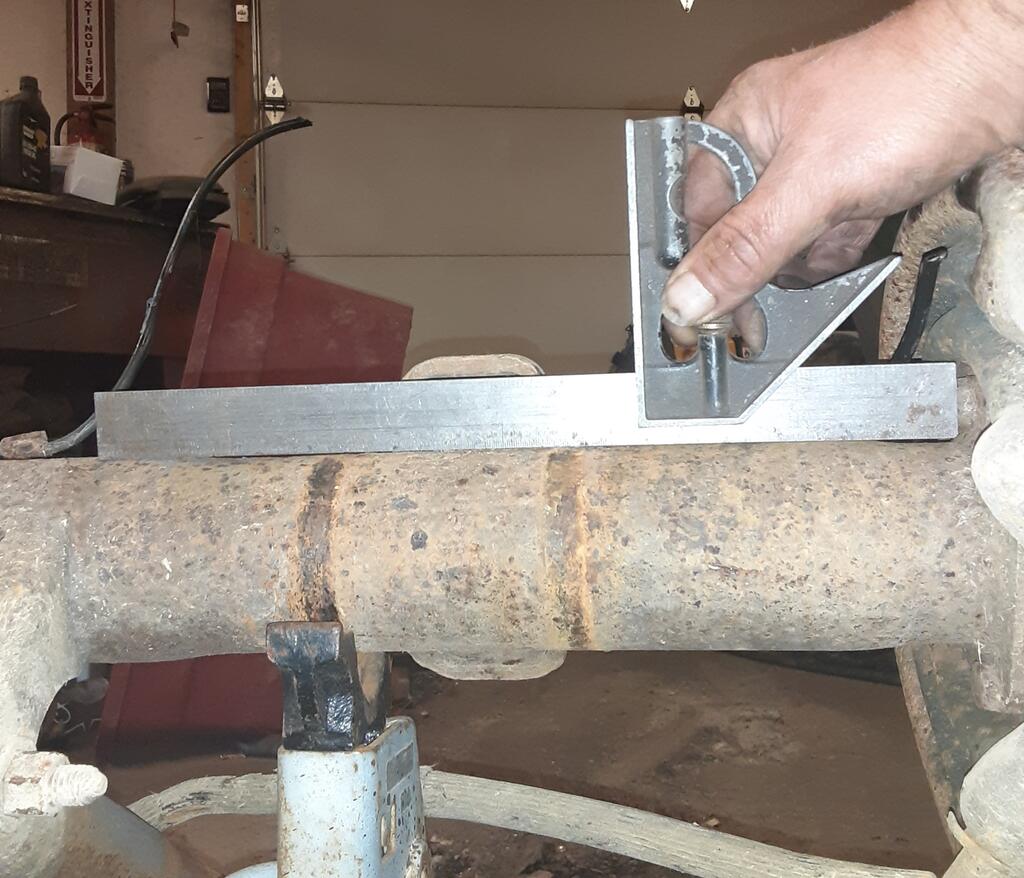

8ntruck
Interesting process.  I have the rear axle out of a Monza Spider that is slated to go into a MGB with an Olds 215.  It will need to get narrowed.  Nice to see the process you are using.
How are you keeping all of the bearing centers in line?
How are you going to shorten the axles?
  • Like 2
Oldskool
Sounds like a cool little project you have going.
As far as keeping the bearing centers in line welllllll.......
With this being a fairly modern housing I'm hoping the factory tolerances were close enough that the axle tubes were round,squared, and centered.
Because all I did was make sure what I did was squared and centered.
I did tack weld the axle end on then tacked my axle shaft together. Then I fit it back into the housing to make sure it slid together.
Lastly, clamped everything in place and alternated my welds.
You can see in the 3rd picture back that I overlapped the axle shaft halves the beveled all my edges. Again clamped in place and alternated my welds. Not letting it get to hot in the process.
For the amount of torque and horse power I will have it should be adequate.
I hope.

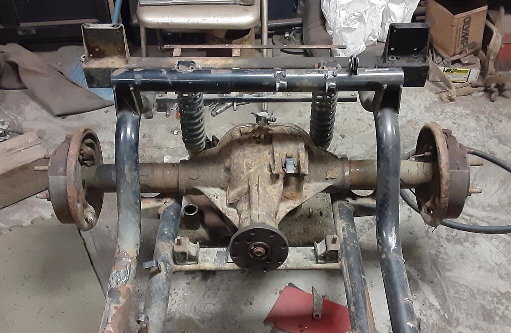

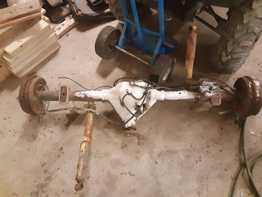

Oldskool
The other half is done.
It's resting in its forever home now.
Maybe some mounts later today along with some shock relocation brackets.
  • Like 4
  • Excellent 3

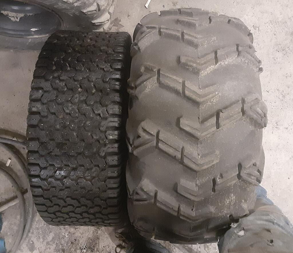

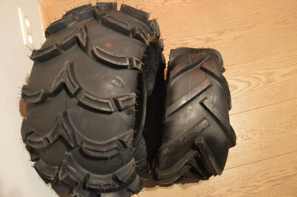

Oldskool
Time to start getting the rear tires ready.
 26x12x12 tires going on.
  • Like 2

Maxwell-8
Great size: DSC_0699.JPG.aa86d0fcf8127617f8981c85a091bd4c.JPG
That rear axle will be more then strong enough! Great work!
  • Thanks 1
Oldskool
Oh ya I won't have to worry about breaking anything on the rear. I hope.
Those must be new sneakers for a tractor?
  • Like 1
Maxwell-8
My C141D, atv tires are softer then a AG, and are made to fit on 7" wide rims, even 12" wide.
  • Like 1

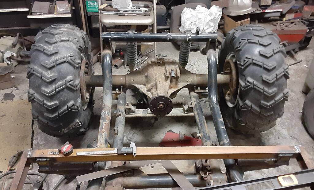

Oldskool
I had just enough time after work to get them mounted.
I even have enough room to run duals if desired.
  • Like 2
  • Excellent 3
Handy Don
Are you thinking about "reactivating" the rear drum brakes?
