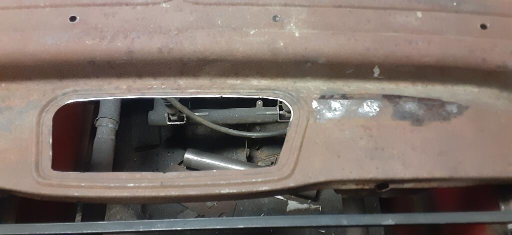

A bit of work on the dash this morning.
Removed the old gauge holes to make room for the new dash panel.
Also welded in 4 old unneeded holes using a brass backer on front and welding in from the back.
Started making the back panel for the cab and had time to dig out the bedliner for the roof panel.
Hoping later this afternoon to get back to this.

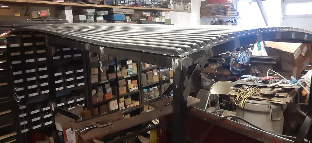

So I cut the center section of that bedliner out and set it on.
It fit well for what it was going to do other then several inches to long.
It had a nice rolled front. (Pic1&2)
While it was there I slid it ahead. I must say I'm diggin the full hard roof. The liner formed from the curved back to the flat front flawlessly. It also would have the flexibility as the cab and body move separately on rough terrain.
To top it all off the wifey likes the hard top look as well. Now I need to get a liner from a long bed truck. This one is to short to make the full distance

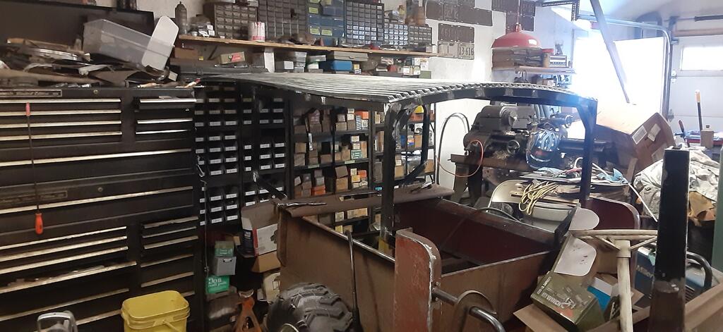

Finally some shop time again.
Working on the back of the cab today.
Maybe onto the rear valance and/or tailgate as well.

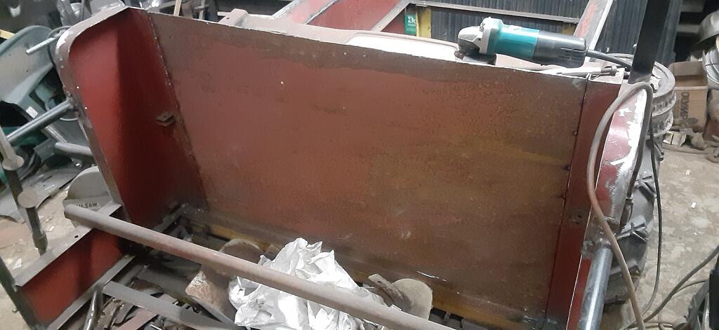

Paid my mun to have my fun.
Got my name in the red again.
The cab back is clamped in place.
The lower valance is tacked together and the tailgate is half done.
I dug around and found something to use for running boards.
Also ordered some trailer fenders to use for the rear fenders.
Getting close to having all the big panels done.
