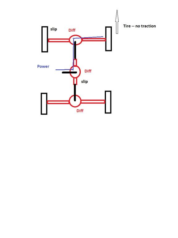

This is what I was imagining. Say the whole thing is driven into deep slippery mud. Guessing about the possibility of only one tire getting power because of the diff slip.
Locking the transfer diff would put power to both front and rear but if it's open it has the potential to power only 1 tire.

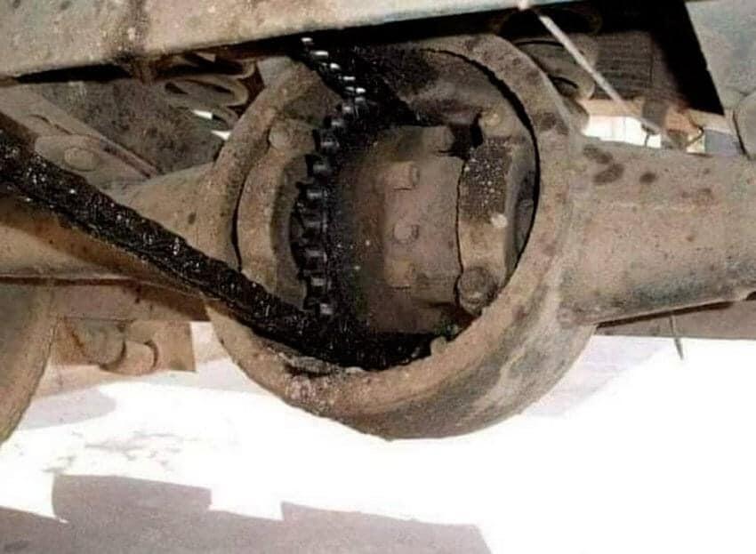

cafoose
What about this idea :scared-eek:

Did you do that cafoose? That kinda stuff is right up my alley

cafoose
No, it came up on my Facebook feed
