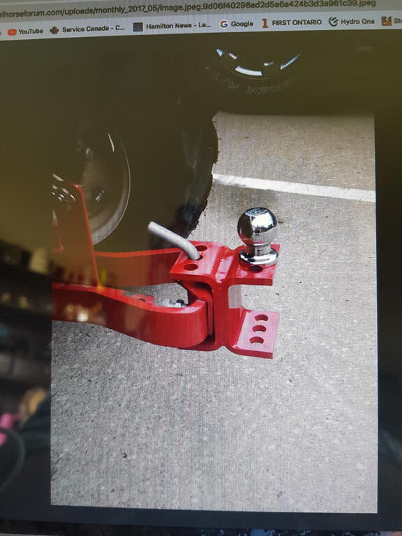

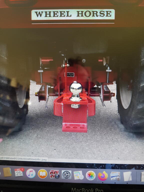

Poppa Bear 15 #1 Posted October 28, 2021 Hello all and thank you for allowing me to join. New Horse owner here - recently purchased a 417 - 8. Looking to put it to work doing some gardening and lawn care. Have been searching for a Clevis Hitch for my unit to attach a Brinly plough and/or culivator. Seems they are as hard to find as hens teeth - up here in Ontario, Canada. While browsing this site a few weeks back I saw a few photos of this hitch. Wondering - where does a guy find one like this or the plans to build one? Looks like a sweet hitch that would fit my needs. If you have any other suggestions on what to use I am open to all suggestions. If you can advise where I could find one - again - open to hearing from you. Given I am in Canada - would much prefer to find one somewhere in Ontario as shipping costs to bring across the border I am sure would be prohibitive. Many thanks for your assistance! Cheers, Poppa Bear 3 1 Share this post Link to post Share on other sites

Pullstart 64,599 #3 Posted October 28, 2021 that looks like it might be two different pieces. The normal clevis hitch is the welded part that is hooked to the tractor and lift cable. The back to back piece looks like an option maybe? Share this post Link to post Share on other sites
ranger 1,782 #4 Posted October 28, 2021 (edited) 1 hour ago, Poppa Bear said: Hello all and thank you for allowing me to join. New Horse owner here - recently purchased a 417 - 8. Looking to put it to work doing some gardening and lawn care. Have been searching for a Clevis Hitch for my unit to attach a Brinly plough and/or culivator. Seems they are as hard to find as hens teeth - up here in Ontario, Canada. While browsing this site a few weeks back I saw a few photos of this hitch. Wondering - where does a guy find one like this or the plans to build one? Looks like a sweet hitch that would fit my needs. If you have any other suggestions on what to use I am open to all suggestions. If you can advise where I could find one - again - open to hearing from you. Given I am in Canada - would much prefer to find one somewhere in Ontario as shipping costs to bring across the border I am sure would be prohibitive. Many thanks for your assistance! Cheers, Poppa Bear Welcome to Red Square. Take a look at the ‘Implements and Attachments’ section, 2nd post down ‘Some Drawings’ there is a 3D image and dimensioned drawings of what you are looking for, by courtesy of one of the mods. @T-Mo Doug. Edited October 28, 2021 by ranger Share this post Link to post Share on other sites
Handy Don 13,340 #6 Posted October 28, 2021 (edited) 2 hours ago, ranger said: Welcome to Red Square. Take a look at the ‘Implements and Attachments’ section, 2nd post down ‘Some Drawings’ there is a 3D image and dimensioned drawings of what you are looking for, by courtesy of one of the mods. @T-Mo Doug. 4 hours ago, Poppa Bear said: If you have access to a welder (your own or a friends?), that hitch can be made with two sleeve hitch brackets welded back to back with one drilled out to handle the bolt on the ball, plus the sleeve pin. The parts are sold by Wheel Horse Parts and More (which also sells other styles of rear hitches) for sure and possibly by K and B or even AtoZ. All in the Vendor section. And WELCOME to Red Square--keep coming back. Edited October 28, 2021 by Handy Don Share this post Link to post Share on other sites

Lee1977 7,044 #9 Posted October 29, 2021 21 hours ago, SylvanLakeWH said: https://wheelhorsepartsandmore.com/product-category/hitches/ Lowell is a vendor on this site. He’s great to work with… The clevis hitch from Wheelhorse Parts and More is made from 1/2" steel, the stock Wheel Horse one is 3/8" thick. I have bent and twisted my stock clevis, It still works but I had to weld a couple of braces in it. 1 Share this post Link to post Share on other sites
cschannuth 3,817 #10 Posted October 29, 2021 (edited) 18 hours ago, Handy Don said: one drilled out to handle the bolt on the ball, I think that’s my hitch. I actually was able to find a ball with the correct size bolt so I didn’t have to drill out the hole. It works really well though. I just flip it over when I want to haul a cart that doesn’t have a ball hitch. Edited October 29, 2021 by cschannuth 2 Share this post Link to post Share on other sites
lynnmor 7,575 #11 Posted October 29, 2021 For those that want to use a trailer hitch ball on a clevis hitch, remember that the cable is holding up your trailer tongue so you don't want a heavy trailer attached. 3 Share this post Link to post Share on other sites
