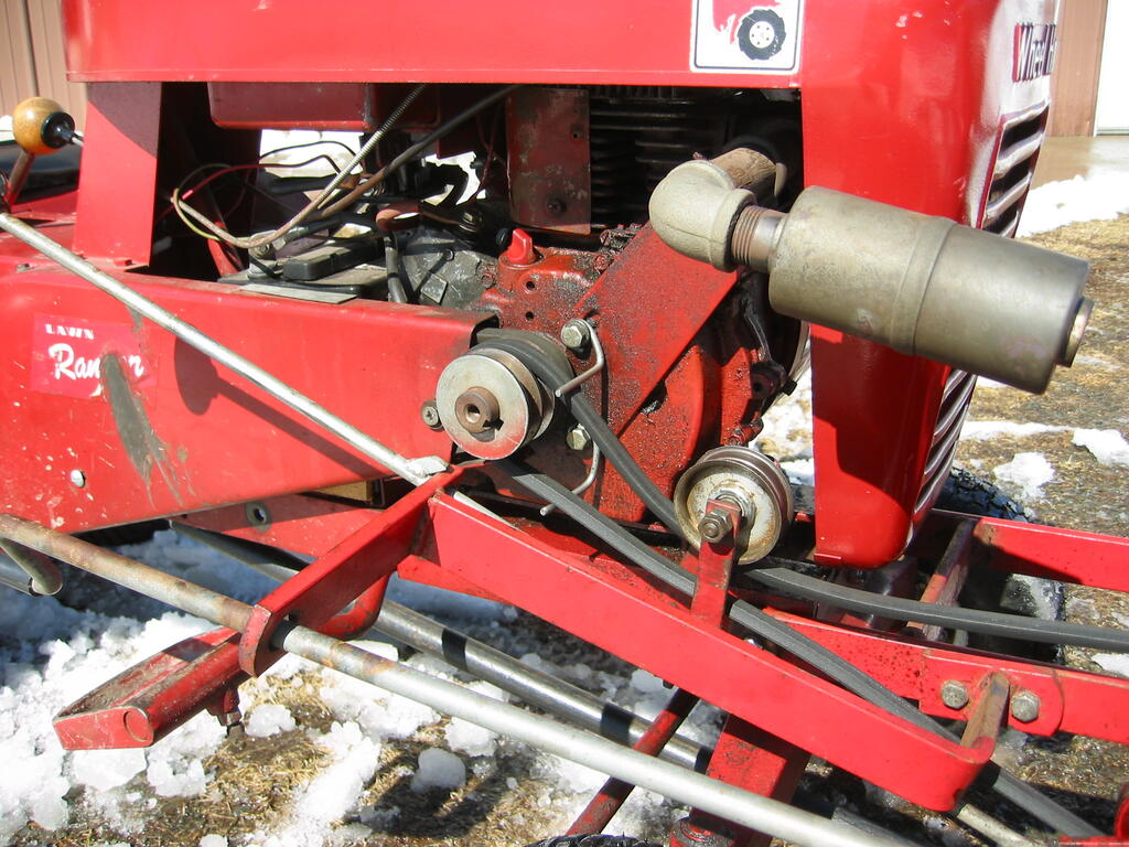

Garry says it's for a Ranger Jeff.  So it could be made to work.    The blower drive pulley would probably have to be moved to the right to align with the 314s wider PTO.    This would require a new driveshaft and possibly a spacer to move the bearing to the right
pfrederi
Bigger issue would be drive pulley diameter 314 pulley is way bigger than a lawn ranger

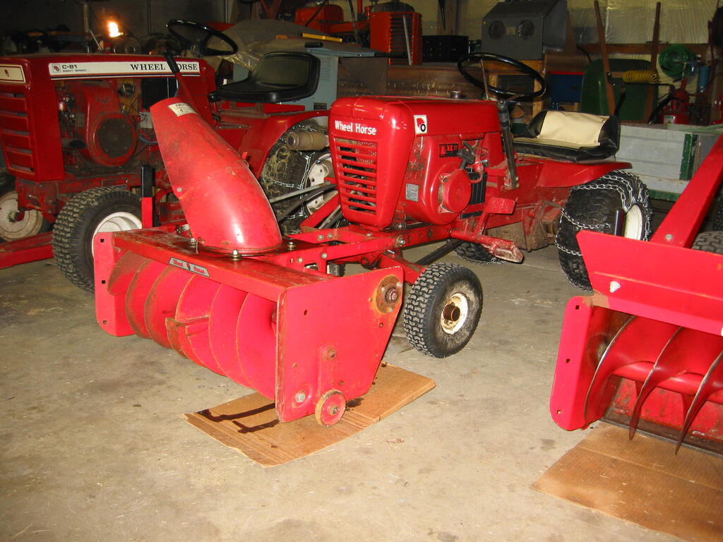

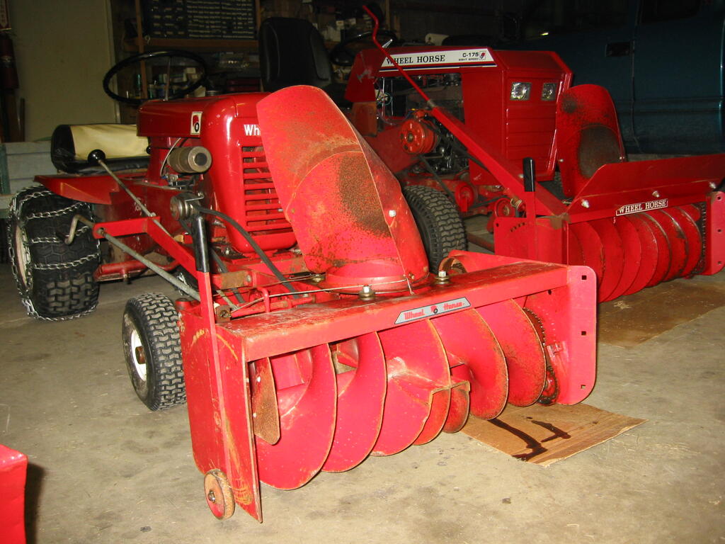

peter lena
@JDEVO just asking , were you trying to run that thrower in the picture?  note the auger drive chain set up on the  c175 sitting along side ? that chain should be on the front side of the driven gears , your picture is showing the wrong set up . am i missing something ? pete
pfrederi
  Pete  My pictures of my rigs
Lawn Ranger blowers are different no top idler.  It is chained correctly per the manual.  I am missing the guard but it is hard to find as it is different also....
peter lena
@pfrederi thanks for the heads up on that , was not aware on that blower difference , but when I  did not see the front chain drop , must have been in the twilight zone , pete
