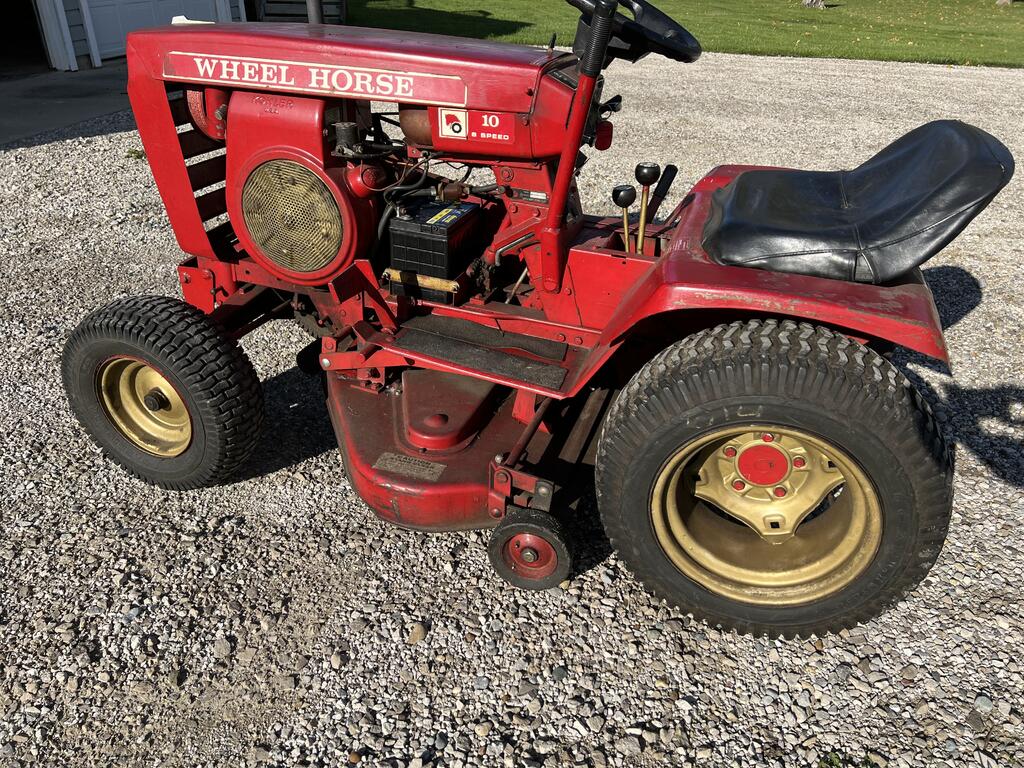

Sharp08 43 #1 Posted October 27, 2021 I think I’ve decided on chains vs AG tires since I have a limestone driveway and want to plow snow this year. I was looking for opinions on the best 23x8.5-12 tires. I have a 1973 10 no name. It has undersized rear tires now as you can see from the pictures that it’s sits lower in the rear than the front. 1 Share this post Link to post Share on other sites

Sharp08 43 #4 Posted October 27, 2021 (edited) Well yeah, that’s why I say 8.5. I guess I wasn’t clear. The current tires are short. Around 20x7-12 I think. I was asking more about tread pattern. Edited October 27, 2021 by Sharp08 Share this post Link to post Share on other sites
Maxwell-8 4,366 #5 Posted October 27, 2021 the front tires seems to be higher then stock maybe part of the way it's sitting My raider has way less sidewall Share this post Link to post Share on other sites

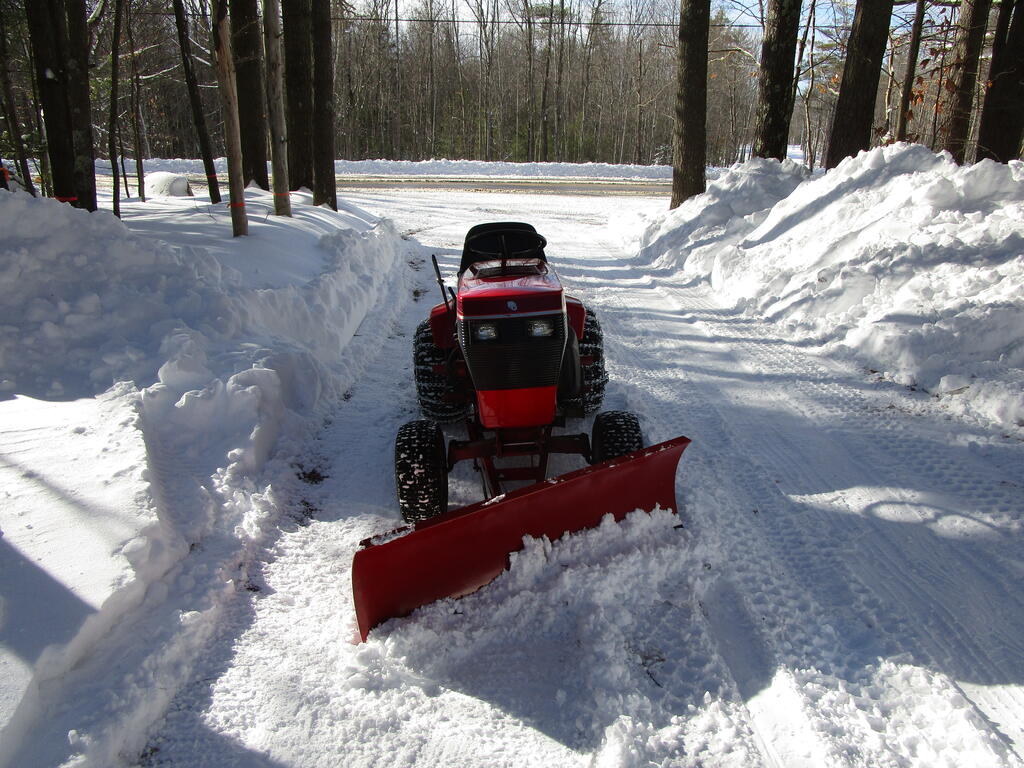

ebinmaine 70,794 #6 Posted October 27, 2021 6 hours ago, Sharp08 said: Well yeah, that’s why I say 8.5. I guess I wasn’t clear. The current tires are short. Around 20x7-12 I think. I was asking more about tread pattern. I run 23x 10.5 x 12 in the snow with two link ice chains and don't have any problem. My tractor is very heavy. Fluid-filled tires and steel weights added and me. The more weight you can add for traction in the snow the better off you'll be. 1 Share this post Link to post Share on other sites

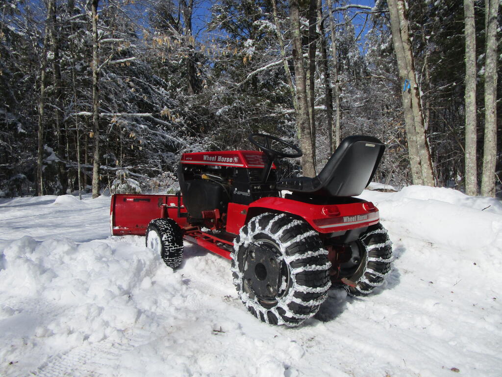

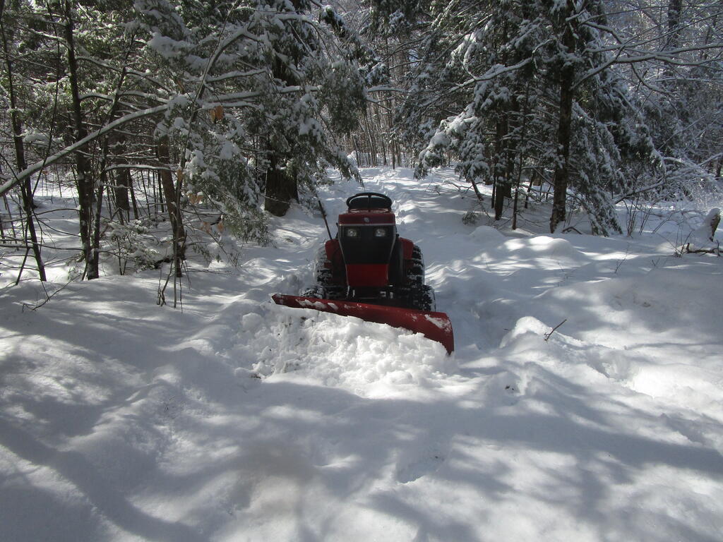

JCM 10,023 #8 Posted October 27, 2021 to @Sharp08 I have had very good luck with stock turf tires 23 x 9.50 -12 , weights and chains. I have a gravel drive way with an incline from the road 200' long with no issues. Also a few wooded trails I like to keep open for recreation. Good luck with your decision. 1 1 Share this post Link to post Share on other sites

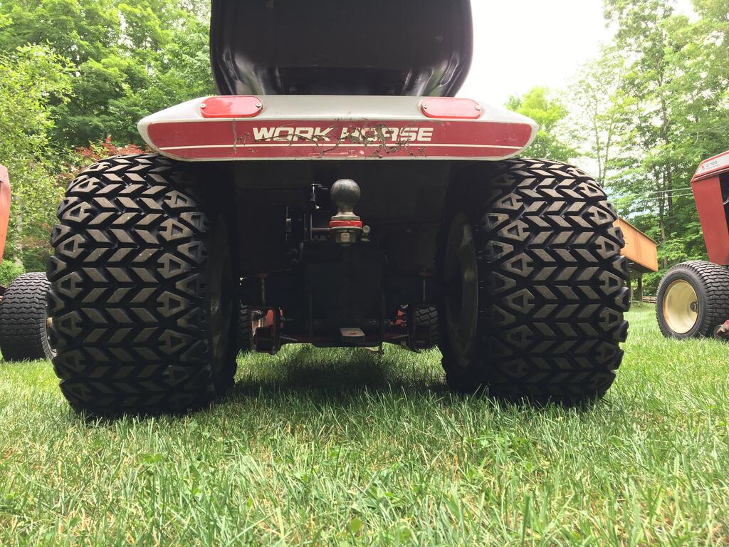

Sparky-(Admin) 22,157 #13 Posted October 28, 2021 I’m a huge fan on the Carlisle All-Trails…installed these a few years ago and they have been great! I don’t use chains, but there is a 50# outside weight and a 25# inside weight on each rim. 5 1 Share this post Link to post Share on other sites
kasey54 305 #14 Posted October 28, 2021 Sparky, what size are those tires? They look great. Share this post Link to post Share on other sites
kasey54 305 #15 Posted October 28, 2021 How heavy are the front weights? That must help a lot with the steering. Share this post Link to post Share on other sites
Sparky-(Admin) 22,157 #16 Posted October 28, 2021 8 hours ago, kasey54 said: Sparky, what size are those tires? They look great. Mine are 23x10.5x12 mounted on a pair of wide rims off a 520H. The next size down was 23x8x12. Yes, the front weights help with steering, can’t recall what they weigh. Share this post Link to post Share on other sites
