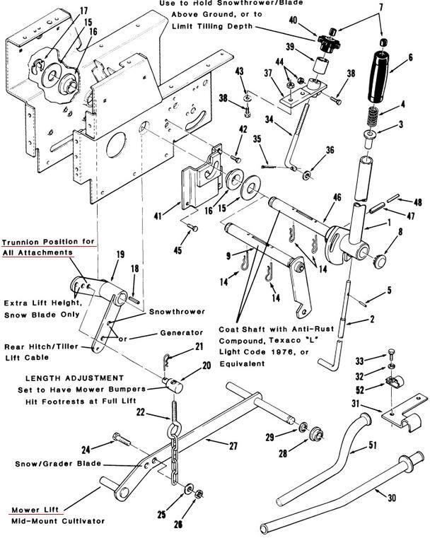

You could give Lincoln at https://a-ztractor.com/ a call, he should have what you need. Here is a blown up drawing of the system. Shaft 9 and associated parts are for a hydraulic lift and wouldn't be used on your :wh:

You may want to rethink that post Richard not even close to what he has.
That is the only IPL I have of the lift system, please post a better one if you have one.
Do you know the year of the one you posted Richard?
Looks like maybe 78 or newer?
The OP's tractor is in the mid 60s but has been modified with a side plate.

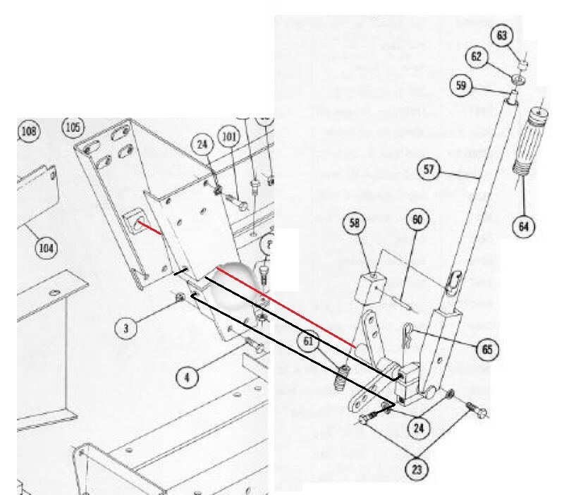

  • Thanks 2
WHX??
Yep my bad Richard... Garry has us covered.
You would need these parts also to stop lift handle @jim v
