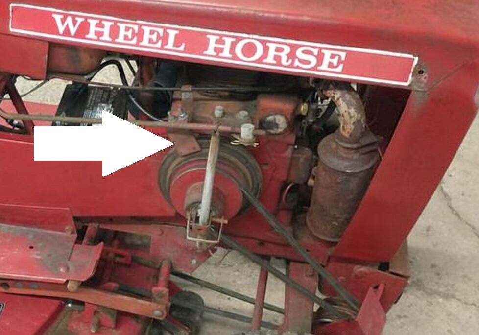

Do you have the PTO brake on the tractor? Metal arm extending over the PTO bell in this pic.

Achto
The PTO brake probably needs to be adjusted. It should rub when the PTO is disengaged.
pfrederi
You need to adjust the PTO brake.
Engage clutch loosen the two 1/4" bolts holding the brake Put a .012 feeler gauge between brake pad and PTO pulley. Hold the brake pad against feeler gauge and tighten the two bolts.

This is a close up of what that brake looks like for the PTO which is "probably" still on your machine.. Adjust as suggested above
oldlineman
The friction material on the brake could be worn down and need replaced just another thought. Bob
