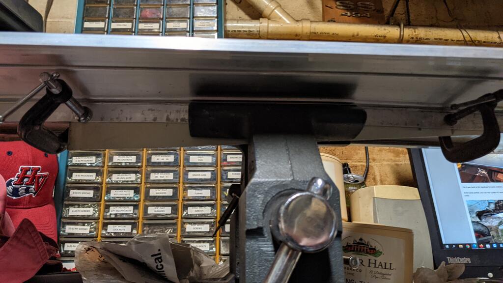

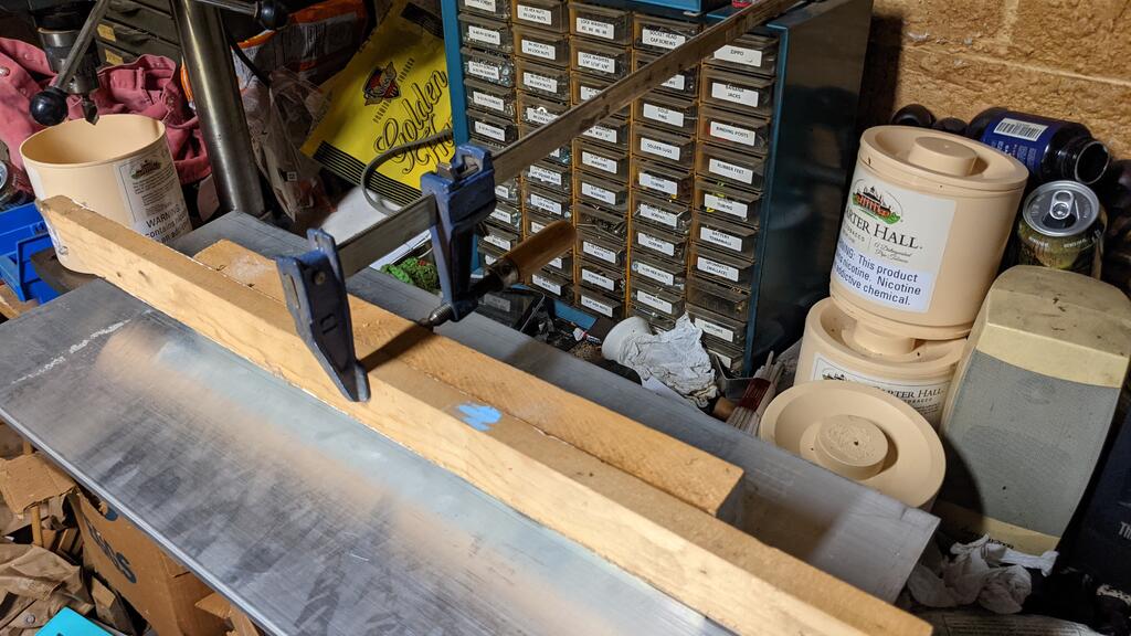

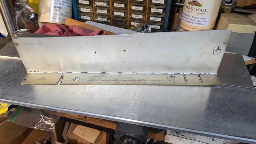

echris 1,425 #1 Posted October 24, 2021 While making a mulching cover for a 42SD the other day, I needed to make a 90 degree bend in a 1/16" anodized aluminum sheet. I don't have a brake, so I hunted around the shop for something to do the job. For years, I've just used my vice and hammers/mallets for smaller jobs. In this case, it's brittle aluminum and around 18" long and I wanted a nice even bend. I found these pieces of aluminum chassis sides from some old electronic equipment, with nice gussets on the back and a hefty right angle on top. I slid a pair of them into the vice, and clamped the workpiece in between and then added two c-clamps underneath to keep it nice and tight together. I wanted to get the bend as even as possible, so using a 24" bar clamp, I clamped it to the top side of the workpiece with a couple of pieces of wood and used the bar clamp as a handle to bend the aluminum around 45 degrees or so, moving the "inside of the bend" block of wood upwards a few times during bending to gain more clearance. Then using a rubber mallet, I flattened the bend gradually from either end towards the middle. This is the result. I REMEMBERED TO DRILL THE HOLES FIRST! Shocking, I know! hahahaha But this worked great. I'm going to have to assign a tool number to these parts with a Sharpie and stick them in a box. 7 3 Share this post Link to post Share on other sites
