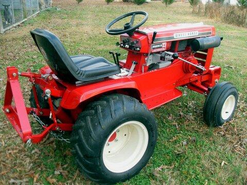

c-series don 9,263 #3 Posted October 24, 2021 Only a D series or a C-195 will have a three point hitch, and not all of them came with it. I believe it was optional. Welcome to Red Square, where you’ll meet the nicest people. 2 1 Share this post Link to post Share on other sites
AMC RULES 37,144 #4 Posted October 24, 2021 (edited) IIRC, super C-195's had had a 3pt as an option. Edited October 24, 2021 by AMC RULES 5 3 Share this post Link to post Share on other sites

kpinnc 13,106 #8 Posted October 24, 2021 All these machines are relatively easy to modify and build the way you want to, and tough enough to take it! My Bronco 14 has been modified to have a functional 3-point. It is a Beast! No rear PTO though... Yet. Welcome to the sickness! 4 1 Share this post Link to post Share on other sites
pacer 3,174 #10 Posted October 24, 2021 As already mentioned the "D" family and the C195 were offered the 3 point & PTO as an accessory (I'm not to up on the 195) But on the 'Big D's' it was definitely an option. I have 4 of them and 2 have it and 2 dont! The PTO was also an option, but (in my opinion) there isnt very much that will work/fit them. The category 0 three point and the 2000 rpm on the PTO really limits what is available. But, the 3 point has to be one of the handiest accessories on a tractor! I'm always finding some new/different situation where it saves the day. Youre gonna love them horses even to the point where theyre almost dangerous!! The dern things are ADDICTIVE 2 Share this post Link to post Share on other sites

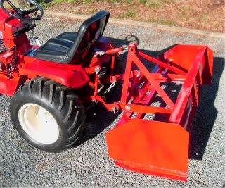

lynnmor 7,479 #11 Posted October 24, 2021 You might be better off skipping the 3 PH idea and use something like this: Scraper There are hitches and lift kits available for most models of WH tractors for the light duty implements. 2 Share this post Link to post Share on other sites

Snoopy11 5,717 #14 Posted October 24, 2021 If you want a grader box... you could buy any Wheel Horse, and buy a sleeve hitch from Lowell at Wheel Horse Parts and More. This would allow you to buy an agri-fab box scraper... Just another option buddy! Don Share this post Link to post Share on other sites
Snoopy11 5,717 #15 Posted October 24, 2021 Or the scraper that @lynnmor mentioned... which is ...almost... identical to the agri fab... Don Share this post Link to post Share on other sites

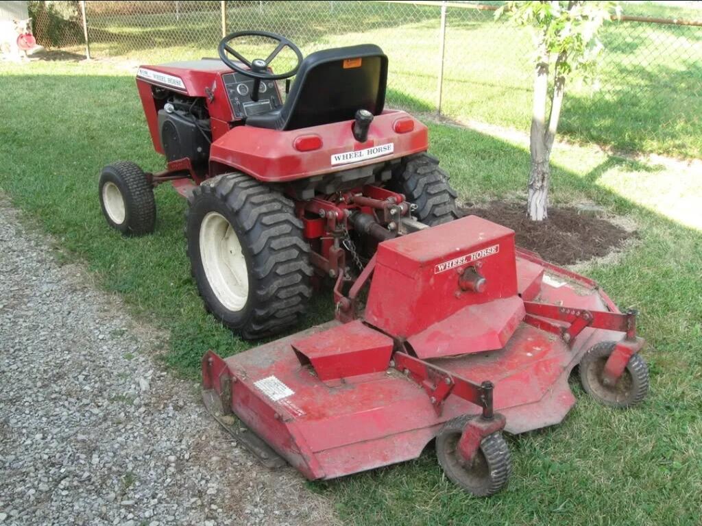

953 nut 56,755 #21 Posted October 25, 2021 The GT-14, C-195 and D Series are all heavy duty garden tractors with a three point category 0 three point hitch as an option. A snow plow can work on any model and the mid mount grader blade will do a great job on a gravel driveway. Just click on the picture below. 1 Share this post Link to post Share on other sites

oliver2-44 10,079 #23 Posted October 25, 2021 @Heffe34 All of the Wheelhorse can have a slot hitch or a Sleeve Hitch on the rear. A Sleeve Hitch works well and there are more attachments for it that a Cat O 3 point hitch. I have a Sears Sleeve Hitch rear blade and a Brinly Sleeve Hitch Box Blade. I find the Brinly box blade works better. For final grading I have a Center Mount Grader Blade. Its a blast to use and I go out of my way to blade neighbors drives when I have it on, just to get more seat time with it. I have also moved a lot of dirt with a front dozer blade. Rear weights, chains or AG tires sure help with traction when moving dirt. 3 Share this post Link to post Share on other sites
