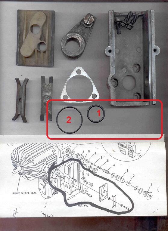

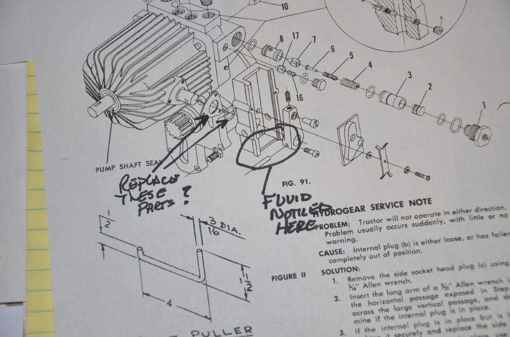

By Purewater Jon
Hello! I have been reading posts for a few years as I’ve tinkered with my two great wheel horses. I have a 1968 Charger 12 auto with a leak coming from the motion control linkage, as well as the tow valve being seized up, lastly, the parking brake is not locking up the transaxle. My primary concern is the leakage though. Do I need to remove the pump and motor to get at this, or can one replace it with them in place and just remove the linkage pieces? I suspect if I have to remove them, then fixing the parking brake makes sense, and maybe I can find a way to free up that tow valve. I have it soaking in PB blaster per a comment on that issue from a few years ago. By the way, my other horse is a C-81. Attachments include a grader blade, a dozer blade, 2 decks and a cultivator. Looking for a tiller for the Charger.
