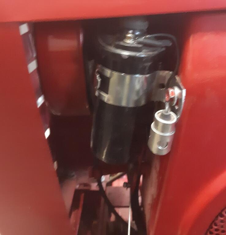

RetroMower 349 #1 Posted October 23, 2021 About a week ago I posted a question about my k241 intermittently misfiring and it was suggested I investigate the vent on my gas cap and the condenser which the cap was fine and after swapping the condenser, the problem persisted. Today I thought the carb may need cleaning so a in a quick test I took the carb off my perfectly running B100 and put it on my c100. Ta da it ran great at first but when I tried to drive it it sputtered and stopped. Frustrated I lifted the hood and it fired right off. I closed the hood and it immediately shut off. Now my frustration was turned to confusion. The culprit was the hood just barely touching the negative terminal of the coil. Pushed the coil down and problem solved. Perhaps I should keep my stupidity to myself but if it helps anyone avoid changing parts for nothing or worse buying new parts which thankfully I didn't do, it's worth it. Please see exhibit A below. 10 8 1 Share this post Link to post Share on other sites

echris 1,425 #10 Posted October 24, 2021 That's an easy problem to cause and difficult to diagnose. Real easy to install the coil a bit too high in the bracket so it grounds to the hood. Intermittent electrical problems are always the toughest to solve. Great job! 2 1 Share this post Link to post Share on other sites
