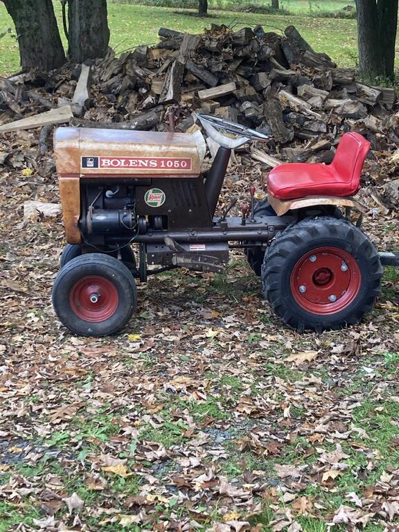

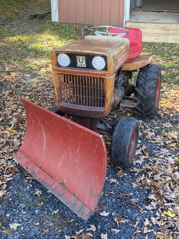

I know we usually like “red” tractors here, so I put my red plow on.
anyways, this tractor got me into this whole hobby. Pretty much every rusted old tractor that followed me home can be blamed on this thing here.
I got it off a close family friend who bought it new in 68, and only ever used it for plowing. It came from a dealership right around the corner from my house as well. It’s always been well taken care of.
I figured it’s about time to service it again so I’m gonna get some 10w30 in its motor for winter time. And maybe toss a new spark plug it’s way. The issue is I can’t find the torque spec for the spark plug anywhere. I know “hand tight” and then “snugged” usually does the trick but I’d like to do it right. Does anyone happen to have the owners manual handy?

D1CFAE63-E245-4A5D-BD7B-DECCFD0B2129.jpeg.36a1fce342cc79e92919b8d208094e78.jpegThe guy who used to own it made some homemade solid lead weights for plowing. At this point I just leave them on all year round. 80lbs a piece is too much to be taking on and off constantly. And the nice “regal red” paint goes nicely with the patina.
The thing that surprises me the most though about these bolens is they feel so much heftier than all the wheel horses I’ve tinkered with. The horses are far easier to work on, but I feel like the 1050 would pull a wheel horse around like nothing.
