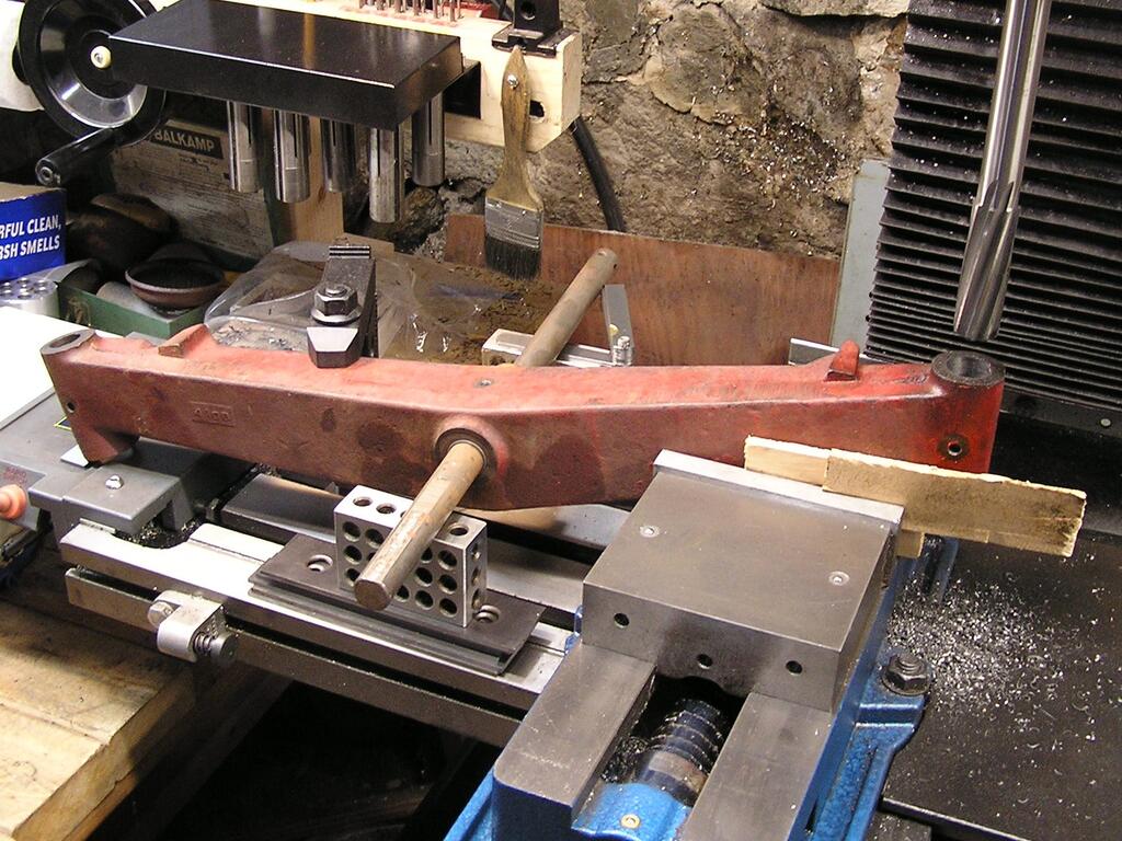

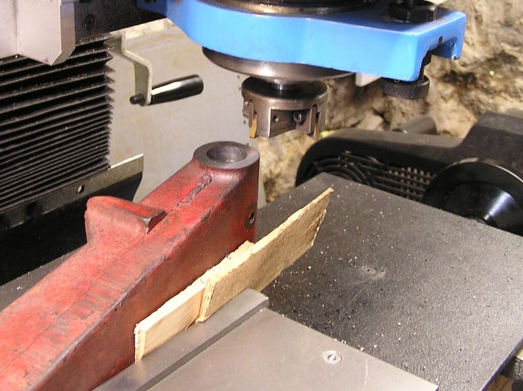

ri702bill 8,749 #13 Posted October 16, 2021 Lowell sells reproduction axle pins for under $25. What condition is the axle itself in? Are the spindle and pivot bores all worn out too?? I have posted this a while back where I machined the three bores to accept pressed in sleeve bearings and machined the lower bosses to make room for thrust washers. No more play. You can see the pivot bushings installed in the first picture. Bill 1 Share this post Link to post Share on other sites
