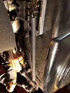

peter lena 9,092 #1 Posted October 13, 2021 added pull springs to my throttle / choke spring pull point , found this to be the easiest way to control throttle creep , also added one to my carb throttle plate , just tempers setting enough to make for easy quick starts . have this set up on 3 kohler magnum 12 engines . lots of hours , with no problems . just an experiment that works , pete 5 3 Share this post Link to post Share on other sites

peter lena 9,092 #3 Posted October 13, 2021 @ebinmaine spring will maintain any setting you put it at , like the fact that you can really dial in what you want , makes the control more secure. another thing is that it assists the slide function on the cable , solid and smooth . the delicate tension on the carb throttle plate is just enough to assist starting . just something i tried when i had a constant erratic start , since trying the spring , instant starts and less choke . have lots of hours on this set up , when i change or correct anything , i road test it for quite a while , and continue to improve it , till it constantly works , pete 5 1 Share this post Link to post Share on other sites

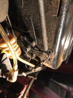

peter lena 9,092 #5 Posted October 13, 2021 @Achto , also installed a 10 / 12 ga wire ground to the , spring mount , rectifier bolt , off the lower corner of engine to frame , ground point , die electric grease . that perforated steel at the base area is a good spring mount point . while you are there , why not ? good for you , pete 2 1 Share this post Link to post Share on other sites

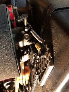

peter lena 9,092 #6 Posted February 14, 2022 @kpinnc note the delicate soft look of that top spring on the throttle plate , thats what i came to on control of that , the other heavier spring is to pull assist the cable control , really makes the cables respond in the lightest increments , have that set up on my 3 engines . experiment , find its gain / improvement , verify consistency , add it to other engines . scary to think that we both came up with that throttle plate control point . regularly use a small piece of prorated metal sheet for a spring go to point for a spring grab . another off the grid experimenter , love it , pete 2 3 Share this post Link to post Share on other sites
peter lena 9,092 #7 Posted July 18, 2022 when first starting on a throttle cable related issue , cable is rusty , never lubricated with correct lubricant , linkage / levers have no lubrication , until you add a light spring to pull back on its intended motion , it will not work like this . is cable mounted ina binding spot ? like forced in there ? should be very smooth / easy on its own . thay spring pull on return , is the answer, also typically tweek / improve related mount points , regularly check action , gain / loss. super lube oil is the stuff, made for it . that very light big loop spring that I have on my throttle plates ,is just delicate enough to enhance plate closure , for instant starts . yet at start is quickly moved to open throttle , think that spring came from a ceiling bucket light tension spot , just the help a cold engine needs for quick starts . lots of hours and starts , the combo works , pete 1 2 Share this post Link to post Share on other sites

peter lena 9,092 #11 Posted September 24, 2022 @Wheelhorse#1 those springs do not have , heavy pull , they are small . experimented with a few for effect , once the cables started to easily / smoothly function , it just retained that change , another thing, top photo , first throttle plate spring , just had a few of those in my spring box , extremely light , think they were for a ceiling light box retainer clip, look around . bonus shot , note the yellow electrical lug , on spring mount to rectifier ? that goes to my engine ground point , from battery ground bolt , enhances electrical grounding . of course every related movement spot , has super lube , instrument oil on it , local H/W store , small bottle , pete 1 Share this post Link to post Share on other sites
peter lena 9,092 #12 Posted September 24, 2022 @Snoopy11 snoop , surely you can see the opportunity while you are right there , have numerous pieces S / S perforated metal from the scrap bins at work , we used to make salt water filter strainers on tank cooling areas , change overs , pull out strainers and steam clean blast , bombproof stuff . just attach a small piece for intended spring assist , the other thing is that you are not counting on the electrical ground point , you are verifying it , going from start to finish . always snoopin , ha ha , around , pete 1 Share this post Link to post Share on other sites
