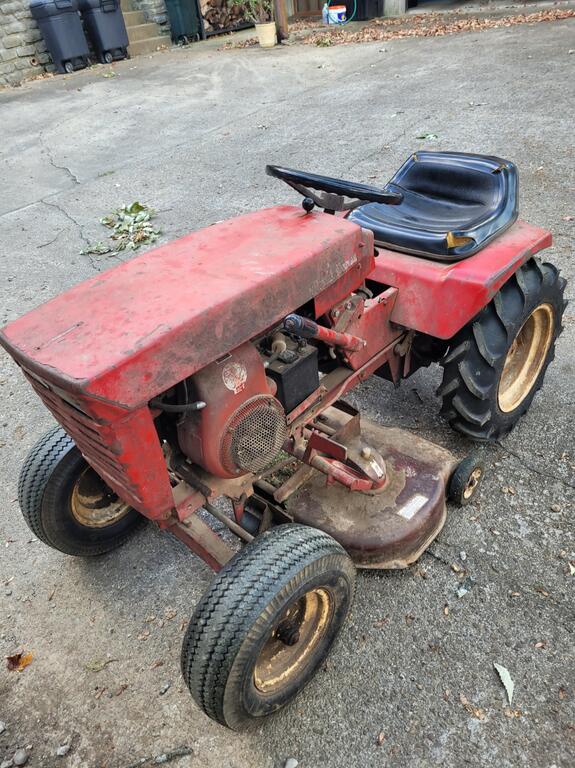

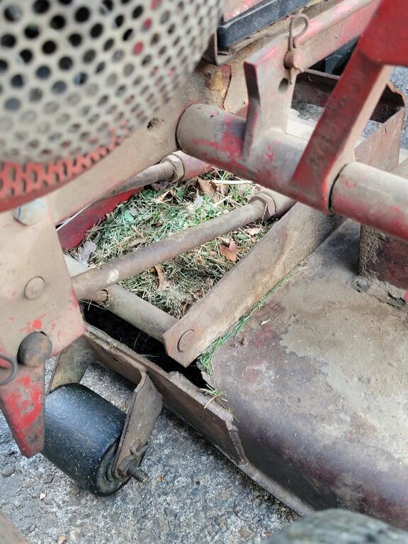

Ben444 9 #1 Posted October 12, 2021 I have a 1965 Wheel Horse 655 tractor I have had since 1980. When I bought it I had the engine rebuilt and it still runs like a top. However, the mower deck is probably on its last leg. It still works but is pretty noisy and has a hole in the front of the housing (see pic). A guy said he could fix that with a weld for $100 but I would rather find a replacement that is in good shape. I have looked high and low and cannot find one. The deck is an RM-324. I have been told that If I want to go to a 36" deck...RM-36 (4,5,6,7) will work also. Would also be interested in any info on rebuilding my RM-324 as a last resort. Thanks, Ben Share this post Link to post Share on other sites

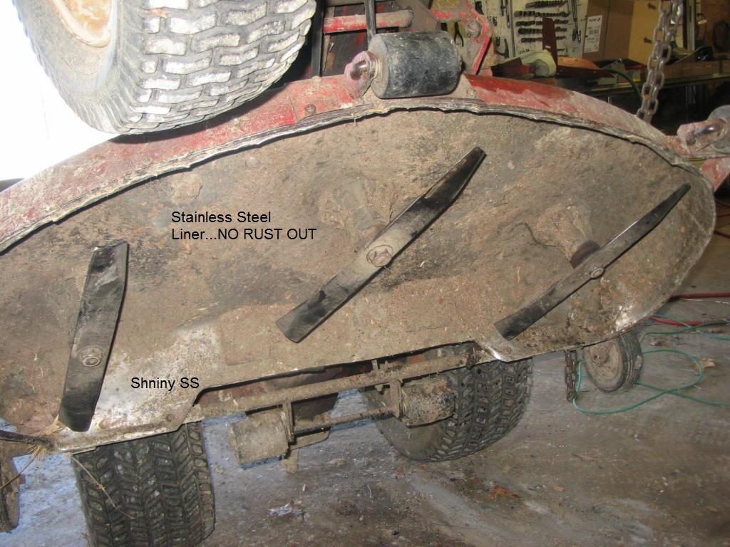

daveoman1966 3,772 #2 Posted October 12, 2021 I have a 48" deck and it was in worse condition than yours. I welded it up (braze welded) and made a STAINLESS STEEL liner for it, using cardboard as a template. It took some time and effort...but it'll last until the end of this century...or longer. I don't recall the gauge of SS I used, but it was malleable and easy weld the 'front' apron to the flat body. 4 1 Share this post Link to post Share on other sites

Jennifer 1,877 #6 Posted October 13, 2021 (edited) 13 hours ago, Ben444 said: Your back wheels look to be on backwards.? I might have that very deck your after. At work can check this week, let you know if you like? Edited October 13, 2021 by Jennifer 2 Share this post Link to post Share on other sites
