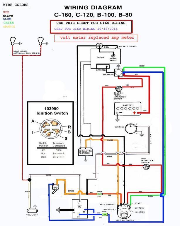

Gregor 4,847 #2 Posted October 12, 2021 (edited) You can by-pass the ammeter without doing any harm. In fact, you can by-pass everything for the short term. Use one side of your jumper cables to go from battery + to post on starter, just be certain trans is in neutral. For the ignition system, you can clip a jumper wire from Battery +, to coil +, and see if you have spark. If you get it to spin over, and you get spark, it's time to backtrack, and see where the problem lies. "That leaves the solenoid, the ammeter, the safety switches,....................." Looking at the wiring diagram, I don't believe the solenoid, or safety switches have anything to do with the ignition circuit, The ignition circuit and start circuit are COMPLETELY seperate. Click on the file below to open. With the key in the on position, using a volt meter, check for 12V DC at coil +. Edited October 12, 2021 by Gregor 1 Share this post Link to post Share on other sites
Gregor 4,847 #3 Posted October 12, 2021 To me, this drawing in the wiring diagram, is a bit convoluted and confusing. Ignore the black lines going around each terminal. I guess they were trying to depict the plastic plug going into the back of the switch. 1 Share this post Link to post Share on other sites

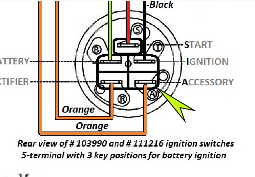

ebinmaine 70,699 #4 Posted October 12, 2021 Did you check the new switch to confirm the correct terminals? It's very easy to get the wrong switch. To bypass ammeter just remove one terminal from it and put it one the other terminal. Check PTO switch carefully. That's a popular wear out item. 1 Share this post Link to post Share on other sites

gwest_ca-(File Mod) 11,243 #6 Posted October 12, 2021 I guess they were trying to depict the plastic plug going into the back of the switch That is exactly why the connector was added. One can probe the back of the switch and know which wire is what using the unique shape of the connector. Wires are usually covered with dust and/or faded in color making identification impossible. 1 Share this post Link to post Share on other sites

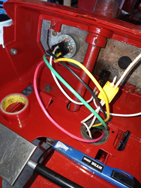

DarylJ 49 #12 Posted October 12, 2021 Trying to test both ignition and start systems, but this afternoon focused on the start system. But….I am now in the 7th level of wiring purgatory with this beast. Turns out that a PO had been in there and disregarded the rules of maintaining correct wire colors. So that makes it interesting right from the start. When attempting to trace everything according to the diagram, the PO again worked some sort of magic by re-routing the red wire from the solenoid that should have gone to the ammeter to the light switch instead! This dead-ended as the tractor has no lights, front or rear. Cool. Next, the wires going into the switch block are mostly wrong. The only wire that is correct is the red one. Orange, black, green go to the wrong terminals. Tomorrow I will descend from purgatory straight to wiring hell. New wires will be run of the correct color, then testing can resume again. The better news is: by doing some jumpering, was able to determine the solenoid is okay, the starter is okay, the clutch pedal switch is okay, and the switch is okay. I suspect the PTO switch is okay as well, but that ammeter, being it has been bypassed in the past, is definitely suspect. I did a third inspection of existing wiring to check for bare or broken wires. None found, even though they are incorrectly colored and running every which way. So, here’s the punch line to this whole thing: Despite the hornet’s nest of wiring, it actually functioned prior to two days ago!!! The evil genius who performed some black magic on this tractor actually made it run in his own diabolical way. Not everything likely was functional, but it started and ran fine. Tomorrow is a new day. I will have a new outlook on this thing and get it sorted out eventually. I have no replacement ammeter should it be needed, but despite that should be able to get it back running once everything is wired back to original. Pulling wires out of 5 wire receptacle blocks may be a challenge. If I recall from past similar encounters with them, they don’t give up the wire ends inserted into them without a fight. Sometimes the receptacle blocks break, too. It’s always something unplanned for. Will update this thread once I’m back out of wiring hell again. 1 Share this post Link to post Share on other sites

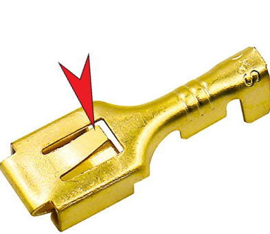

Gregor 4,847 #13 Posted October 12, 2021 13 minutes ago, DarylJ said: Pulling wires out of 5 wire receptacle blocks may be a challenge. They will come out quite easily if you stick a very small flat screw driver into the top of each terminal, and push down the little tab that holds them in. That being said, if you don't have new ones, with the proper tools to put back in, why take them out? Share this post Link to post Share on other sites
DarylJ 49 #14 Posted October 12, 2021 Not sure how many will need to be replaced, but surely the wires with colors other than correct. I may end up clipping them a couple inches from the block, then using splice connectors to connect wires of the correct color headed to the correct locations. For future reference, having the correct wiring in place will help whomever is looking at it. 1 Share this post Link to post Share on other sites
Gregor 4,847 #15 Posted October 12, 2021 (edited) 4 minutes ago, DarylJ said: then using splice connectors to connect wires Not a big fan of those, but a guys gotta do what a guys gotta do, As long as he does it correctly. You can also use simple 1/4" insulated, female spade terminal ends, push them right on the switch, and forget about the plastic block altogether, until you get the proper ends and wire crimper. Edited October 12, 2021 by Gregor Share this post Link to post Share on other sites

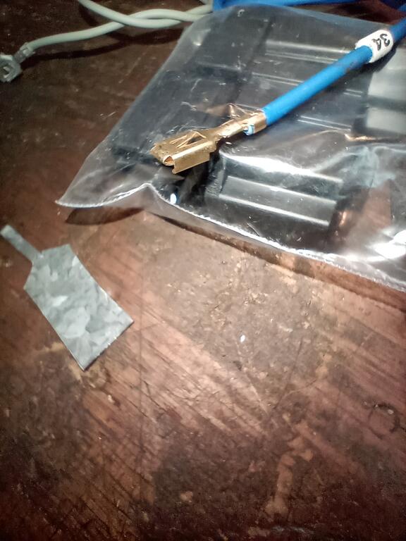

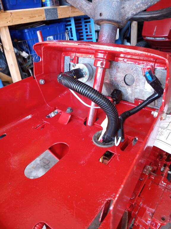

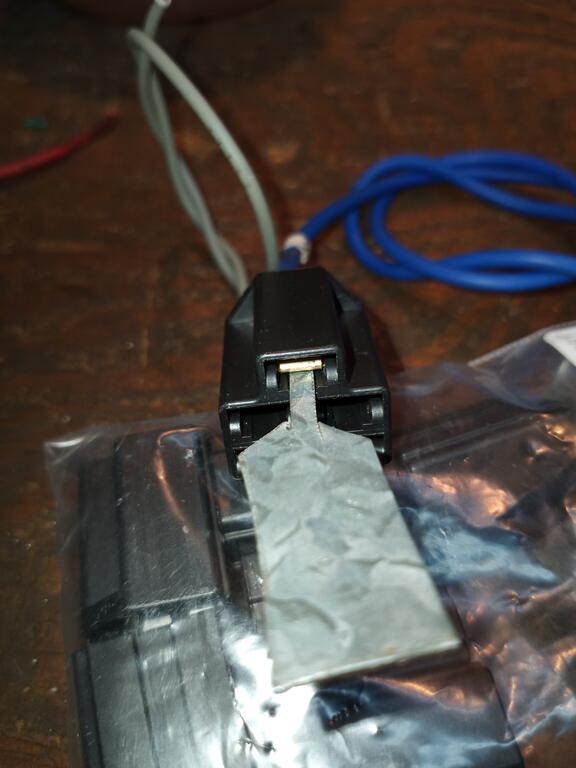

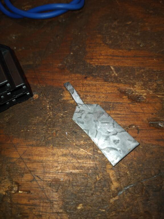

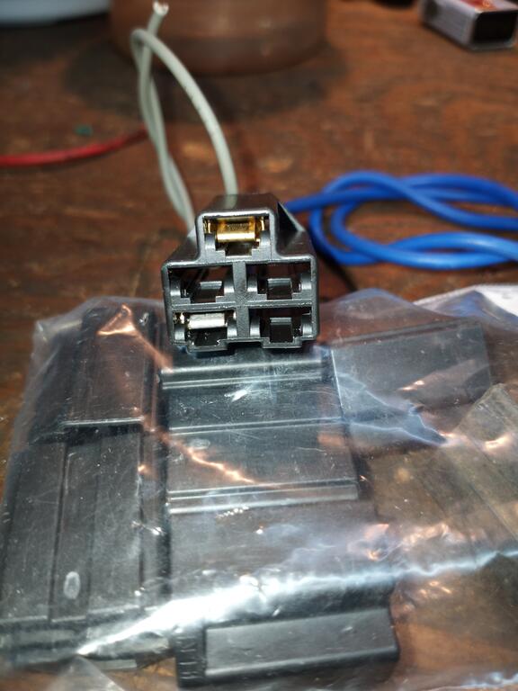

BOB ELLISON 2,981 #16 Posted October 12, 2021 I just replaced all the wires on my c160 which is the same as the B80. The 5 wire switch plug is easy to remove the wires. Its just knowing what to use to release the wires. I made the tool out of a piece of galvanized steel. Just cut it so it fits in the slot . I bent it up just a little at the tip and insert it and push and the wire will slide out. All that holds the wire in is a little tab as in the last picture. Piece of cake. If for some reason it refuses to come out just bend the tip of the tool up a little. The 5 wire switch plug can also be used for the regular/rectifier if you have a 3 wire one up two below regular 1 Share this post Link to post Share on other sites
BOB ELLISON 2,981 #17 Posted October 12, 2021 If you do the right way you'll probably never have to do it again. I did mine last week. But I really like the electrical part . Don't rush and double check your work. 1 3 Share this post Link to post Share on other sites

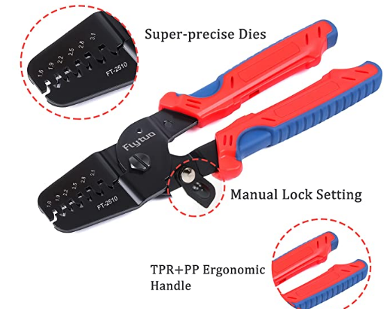

Gregor 4,847 #23 Posted October 13, 2021 To properly crimp the wires to these connectors, you will need an "Open Barrel" crimping tool. Your auto parts store should have that also. $10 - $20. 1 Share this post Link to post Share on other sites
