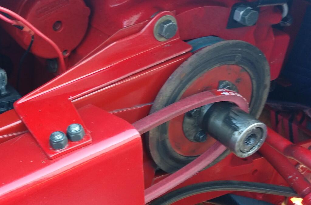

This tractor is wearing on my nerves... It's my fault of course, so I guess it's better to say my own stupidity is wearing on my nerves.
I never questioned the engine I used on this machine because I've seen it run recently. But- it used a fixed throttle before. And it ran great, but seemed far more "stubborn" to start cold than most Kohlers. And also I only have two machines with coil/ points that I've never had to make adjustments to... Well this one had a flaky plug wire, a bad condenser, and the governor was set weird. I added all the variable throttle parts, so nothing was adjusted correctly. Did I mention stupidity? This tractor would choke off just trying to pull the mower deck if it wasn't even down on the lawn... So now after swapping parts and two evenings of test drives, it appears to be running as it should, and cranks on the first turn over. The governor is now set properly as well.
I also removed all that clackity clack tension release garbage from the tranny drive belt. The purists can smirk at it, but it at least runs smooth and quiet now without having to hold that T-handle still. It now has a strong single spring for belt tension and is so much better in my opinion.

The park brake is part of it of course, but very few of those even still work. The paws or brackets (depending on model) are usually broken or worn down to the point they no longer engage. The oldest Hydrogears have no other form of braking. Later Sundstrands had traditional band/ drum brakes similar to Eatons and 8 speeds.
None of the "newer" hydros have a release. Albeit they aren't Sundstrands, lots of other machines do not use a release regardless. My 518-H had (emphasis on had) the release, but none of the 520-H models that I have use them. I also have a Toro groundsmaster with no such device on a Sundstrand.
The Charger runs much quieter now without all those links rattling around under the belt cover. The belt also slaps less on the guard.

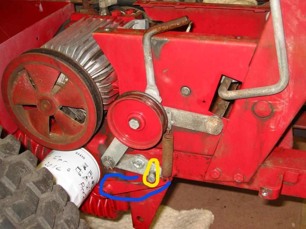

Jeff-C175
14 hours ago, ebinmaine said:
disengaged position is where the park brake is.
Not sure I get this...  I can engage or disengage the drive idler with or without the parking brake on.  Talking about either my C-125 or 175.
Are there other models on which one must disengage the drive belt before applying the parking brake?
One reason that I'm considering doing this is because on my 'new to me' C-125, the idler doesn't stay firmly DISengaged, making for some rather unpleasant experience if the hydro lever is NOT in neutral and the idler decides to 'snap to attention'.  It's happened twice now.  Once I stopped just inches away from my wife's car door.  The other time was outside so no big deal except I wasn't in the seat. Luckily it was just idling at the time. The Treasurer didn't like that shrubbery anyhow.
Edited by Jeff-C175
Oh yeah yeah.
I don't know what year they came out ... the older Sundstrand transmissions do not have a park brake drum.
"Park brake"  is a pawl that gets engaged by an arm that catches a gear.
That's attached to the engagement mechanism for the belt.

The brake in my original post (and on the "hydrogear" Sundstrands) was designed to simultaneously engage the park brake paw when the drive belt was disengaged. There are no other brakes of any form in these transmission- but they are only park brakes, and have only two modes: on and off. They originally held the tractor from moving while at rest.
The pic below is not mine, but shows the hydrogear parking brake circled in blue. It is connected to the tensioner release. The brake arm goes inside the tranny and locks the gear from turning- though they are often broken.
The newer Sundstrands (B/C/D series) have traditional brake drums, and are typically actuated with a brake pedal. Those models likely use an integrated park brake and pedal.

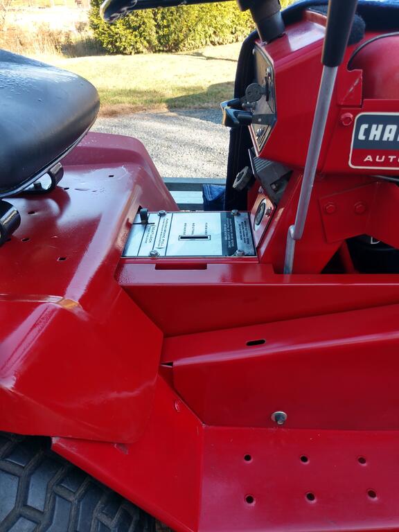

Now this Charger has a cleaner look at the center console with the disengagement lever now gone.
I also made another brace for the PTO belt guard.
