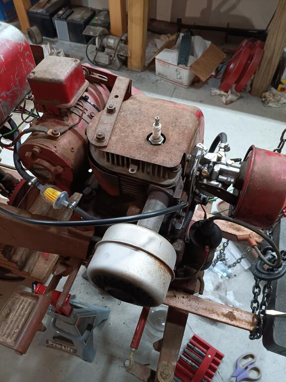

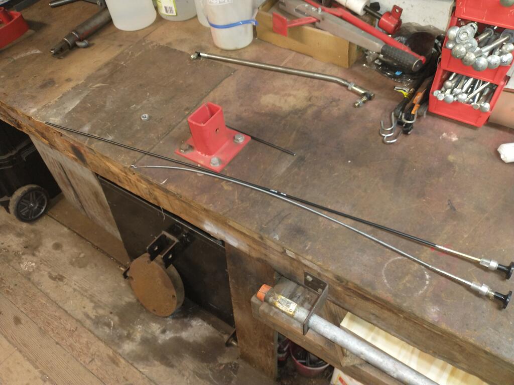

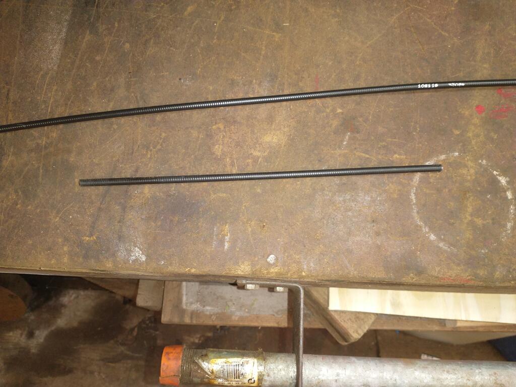

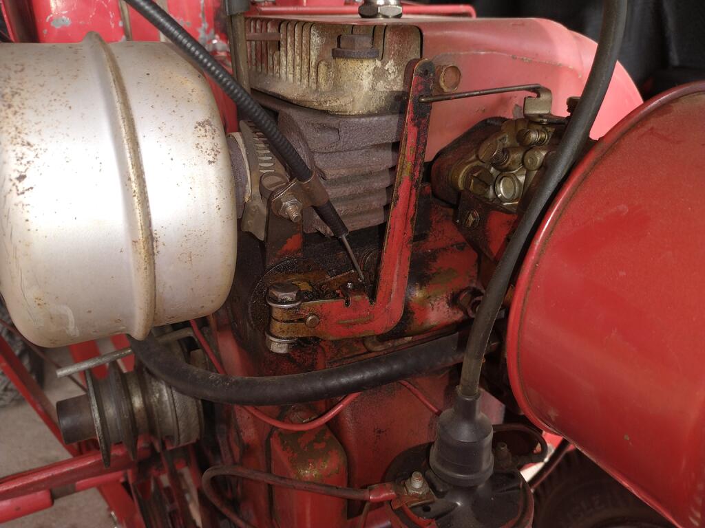

squonk 44,860 #1 Posted October 8, 2021 For @ebinmaine. Heard lots of complaints about a "hard to work throttle" "Idle or fast nothing in between" ect on the short frame small block tractors. I had the same issue on HHHOOOWWWAAARRRDDD!!!. I've messed with it and messed with it some more. Couldn't come up with an answer. Cable was free. Throttle wheel was free. I bought a pair genuine Toro 102118 throttle cables at the show. These cost close to $30! But I have had trouble with the crimps coming loose or the knobs falling off of the aftermarket ones. I came up with the idea if maybe I made the cable a little extra long, it would " Give" a little when pulled and maybe work smoother. Picture of the new cable compared to the one that was on the tractor. New cable was 45" OA length. I installed the entire cable on and then played with the length of the conduit in the clamp to where the cable didn't stick out too far when the hood was closed.I wanted the conduit a bit longer than the old one. I cut 10 1/2" off. So the new cable will be approx. 4" longer than the old one. I installed the cable with 3/4" of conduit on the throttle side of the clamp. With the knob pushed in the cable extends out of the conduit 1 3/4" 4 2 Share this post Link to post Share on other sites

squonk 44,860 #6 Posted March 1 Another thing I found is the angle of the pull. The lever or disc is going to move in a semi circle. If you have the angle of the cable at one extreme or the other it will fight the assembly moving smooth. You want the angle of the cable pull to be some where in the middle that the cable hole arc will travel 1 Share this post Link to post Share on other sites
ebinmaine 75,747 #7 Posted March 1 10 minutes ago, squonk said: Another thing I found is the angle of the pull. The lever or disc is going to move in a semi circle. If you have the angle of the cable at one extreme or the other it will fight the assembly moving smooth. You want the angle of the cable pull to be some where in the middle that the cable hole arc will travel Agreed. The right zone is very different. Share this post Link to post Share on other sites
