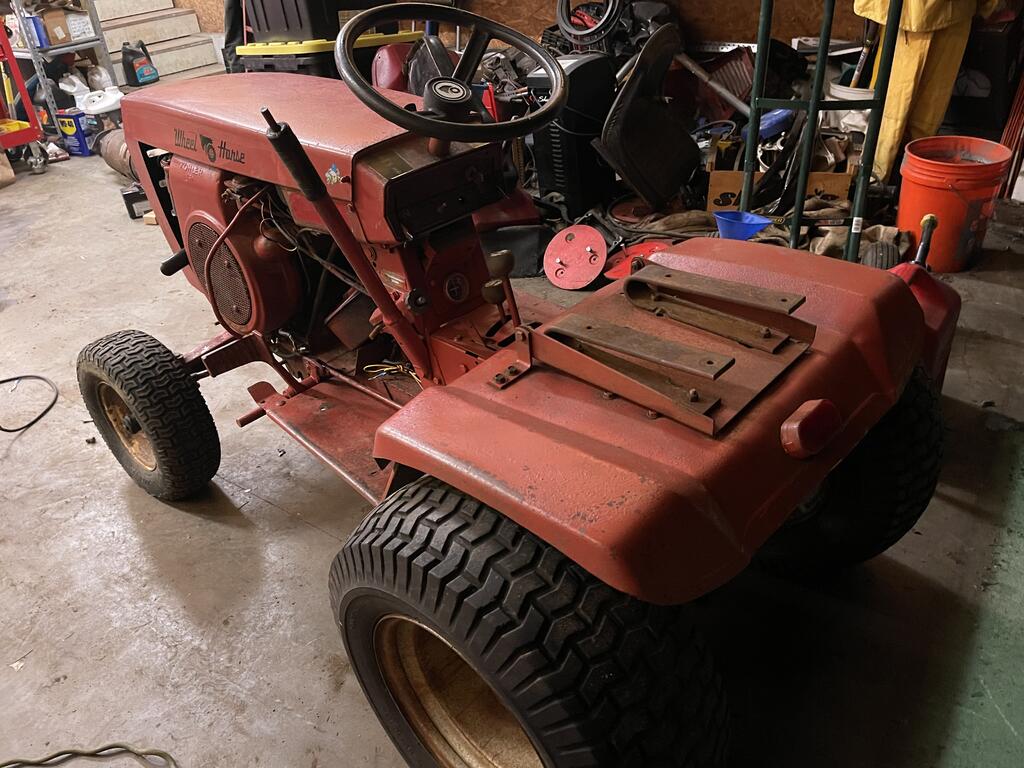

Bens vintage tractors 1,542 #1 Posted October 5, 2021 Well I think this is going to be the next project. The engine in the B-60 smokes pretty bad so I figured I might as well make a C160 out of it with that spare 16 horse I bought then I’ll just rebuild and do a nut and bolt restoration on my original C160.. 7 Share this post Link to post Share on other sites

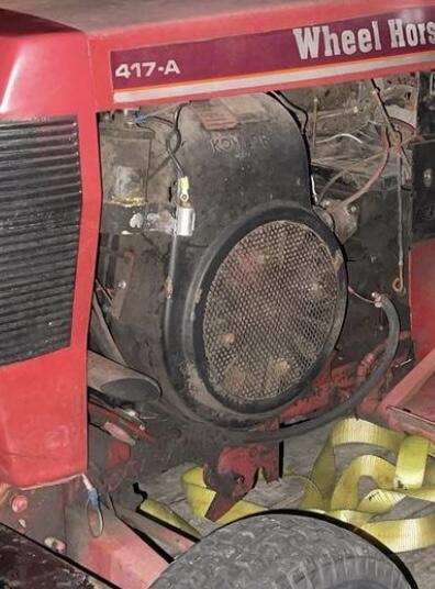

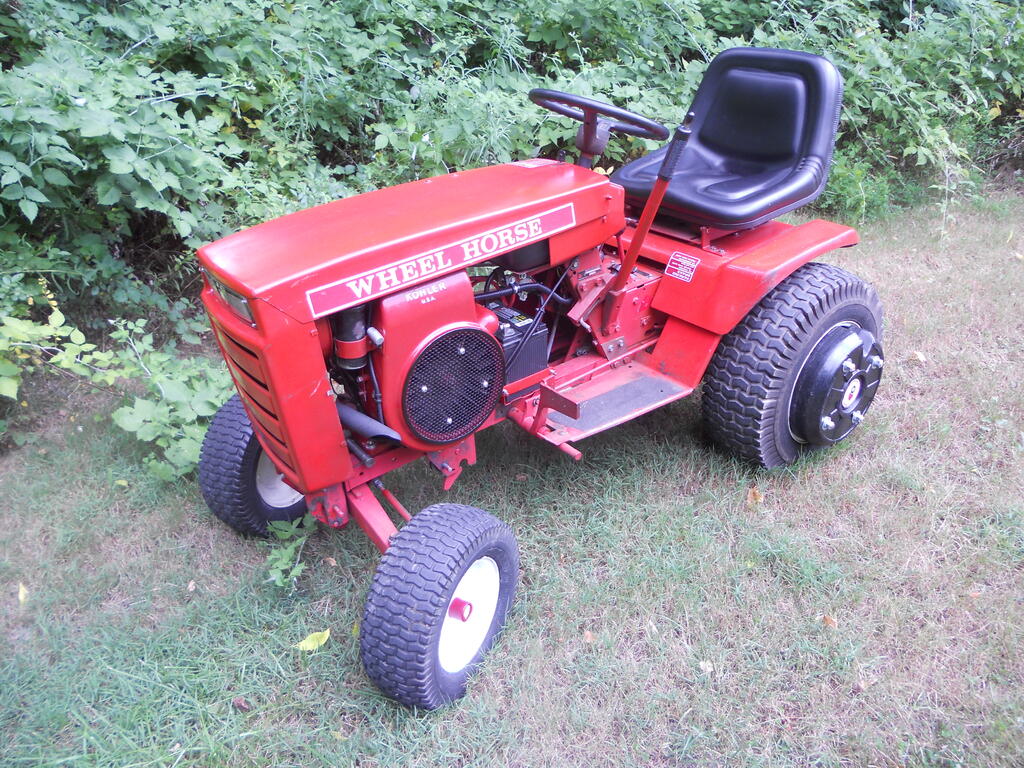

Racinbob 11,432 #10 Posted October 6, 2021 I've been calling this my B-160 for years. It started out as a 1976 B-80 that I purchased brand new. As mentioned already the 76 & 77 B's are identical to the C's save for the horsepower, low back seat vs high back, 22.750-12 rear tires vs 23.850, 13" steering wheel vs 15", headlights optional on the B's. I bought the headlight kit with the tractor and a couple years later WW Grainger was closing out the Kohler K's and I latched on to a crate K-341 for around $250.00. Easy peasy swap and the B-160 was born. Years ago this was used to mow, push dirt, snowblow, till and plow. Today it mows in the simmer with my wife piloting, in the winter it runs a snowblower. I prefer to push snow with the 05 Classic just because it's more fun than using a blower. 2 2 Share this post Link to post Share on other sites

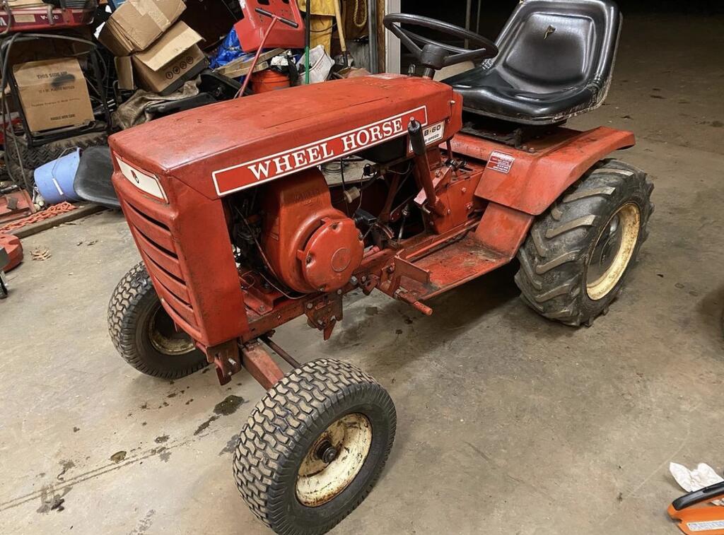

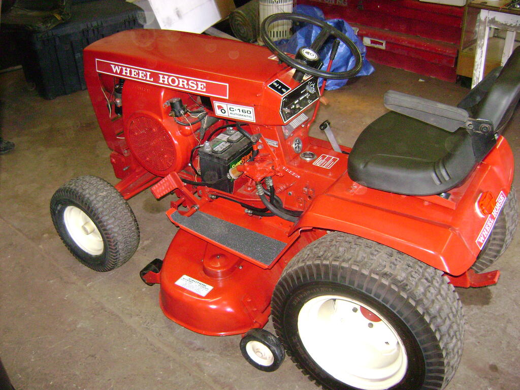

sparkie333 265 #14 Posted October 6, 2021 Here is a true C160 2 3 Share this post Link to post Share on other sites

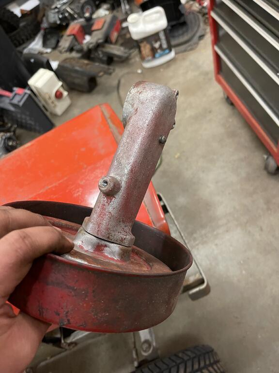

Bens vintage tractors 1,542 #18 Posted October 14, 2021 I also think I will be putting this gt14 intake on it! 1 1 Share this post Link to post Share on other sites

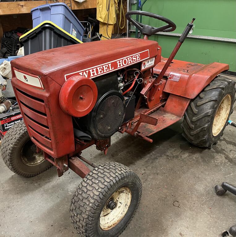

Bens vintage tractors 1,542 #19 Posted October 14, 2021 Well just like that the b-60 is ready for the k341! 4 Share this post Link to post Share on other sites

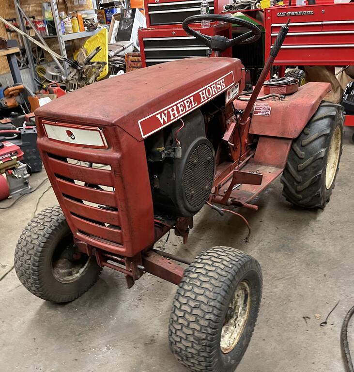

Bens vintage tractors 1,542 #24 Posted October 15, 2021 The engine is sat on the chassis now already love the look of it lol. 3 Share this post Link to post Share on other sites
Bens vintage tractors 1,542 #25 Posted October 21, 2021 Engine is in and everything is hooked up. Just redid the wiring and threw a newish belt on. 2 2 Share this post Link to post Share on other sites
