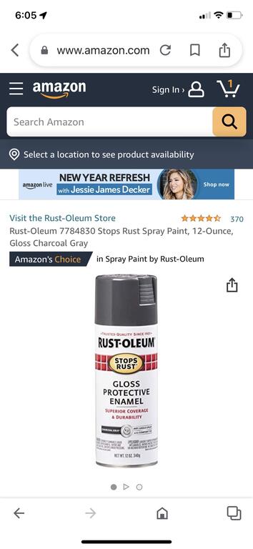

Horse Newbie 7,202 #701 Posted January 25, 2022 (edited) Gloss Charcoal Gray ?… I think this is definitely too dark . Edited January 25, 2022 by Horse Newbie Share this post Link to post Share on other sites

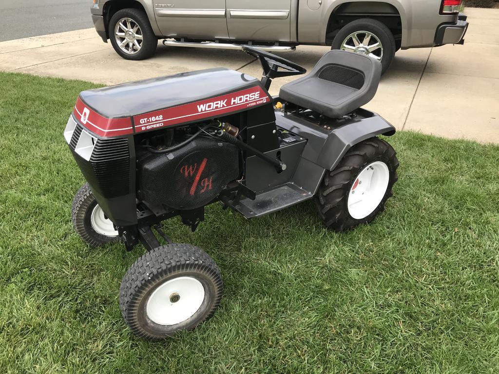

SylvanLakeWH 27,594 #702 Posted January 25, 2022 (edited) Either of first two would look great! Go with what you want!!! Personal preference but I prefer satin to gloss… just seems more fitting for a tractor… But again go with your preference… Gonna look great! Edited January 25, 2022 by SylvanLakeWH 2 Share this post Link to post Share on other sites
Horse Newbie 7,202 #703 Posted January 26, 2022 41 minutes ago, SylvanLakeWH said: Either of first two would look great! Go with what you want!!! Figured that’s what ya’ll would say ! 1 Share this post Link to post Share on other sites
kpinnc 13,789 #704 Posted January 26, 2022 I like the pewter or light gray... But it's your machine, and if you like it, it's all that matters! The only foothold into the "correct" red for other tractors is Mike Martino's book that said Mr. Pond always tried to get his paint as close to IH red as possible. Otherwise there were multiple "WH RED" versions over the years. There were at least two distinct grays for the Work Horse line, and no reason not to expect more. Paint it like you want it, and enjoy! 1 2 Share this post Link to post Share on other sites
Horse Newbie 7,202 #705 Posted January 26, 2022 15 minutes ago, kpinnc said: I like the pewter or light gray... But it's your machine, and if you like it, it's all that matters! The only foothold into the "correct" red for other tractors is Mike Martino's book that said Mr. Pond always tried to get his paint as close to IH red as possible. Otherwise there were multiple "WH RED" versions over the years. There were at least two distinct grays for the Work Horse line, and no reason not to expect more. Paint it like you want it, and enjoy! I heard dat ! Share this post Link to post Share on other sites
ebinmaine 70,802 #706 Posted January 26, 2022 46 minutes ago, kpinnc said: Paint it like you want it, and enjoy! Incase you ain't figured out... With our distinctive line up of Horses of a different color up here... This is the line I'd go with. As to those bearings. Bought em. Like em. They work well. Roll smooth. No grease. No mess. I can't speak to the longevity of them yet having only just recently installed them. But really. Even if they only last a short time, they're ridiculously easy to pop in n out. 2 Share this post Link to post Share on other sites

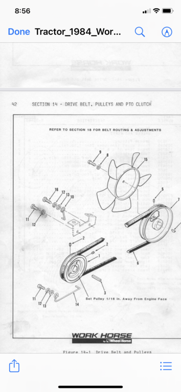

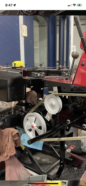

Horse Newbie 7,202 #707 Posted January 26, 2022 Got a question… I seen in the 1984 Work Horse GT-1600 manual, a transmission input pulley that had a fan built with it like the pic shows. Is the 8speed transmission supposed to have a cooling fan ? The color pic is a pulley with built in fan. Share this post Link to post Share on other sites
kpinnc 13,789 #708 Posted January 26, 2022 (edited) 1 hour ago, Horse Newbie said: . Is the 8speed transmission supposed to have a cooling fan ? Nope. But as far back as 1965, WH used the same casts for both hydros and 8 speeds. Probably cheaper. I think it's actually just a little smaller in diameter than the later pullies, so it may make your groundspeed just a little better. Edited January 26, 2022 by kpinnc 1 Share this post Link to post Share on other sites
ebinmaine 70,802 #709 Posted January 26, 2022 5 hours ago, kpinnc said: Probably cheaper. I think it's actually just a little smaller in diameter than the later pullies, so it may make your groundspeed just a little better. Highly likely they're the same for cost and efficiency reasons. Agreed. Pulley size as I understand it: Up to 1967 the transmission had a 4" pulley. After 1967 it had a 6" pulley. As far as I know ALL the 8 speeds through the end of production were the same. The difference in pulley size later on was in the engine pulley. Early ones were all 2". 1967 went to 4". At some point in time the hydros went to ((??)) 5". That may have been right in 67 but I'm not sure. You really want some go-fast fun put a hydro front pulley with an old transmission pulley. 😂 1 Share this post Link to post Share on other sites

Lee1977 7,044 #711 Posted January 26, 2022 There was some one that painted a Work Horse charcoal grey metallic with red decals it really looked sharp. 1 1 Share this post Link to post Share on other sites
kpinnc 13,789 #712 Posted January 26, 2022 1 hour ago, Lee1977 said: There was some one that painted a Work Horse charcoal grey metallic with red decals it really looked sharp. You talking about this one? It's somewhere here on the forum. 1 Share this post Link to post Share on other sites
Thor27 832 #713 Posted January 26, 2022 (edited) 11 hours ago, ebinmaine said: The difference in pulley size later on was in the engine pulley. Early ones were all 2". 1967 went to 4". At some point in time the hydros went to ((??)) 5". That may have been right in 67 but I'm not sure. You really want some go-fast fun put a hydro front pulley with an old transmission pulley. 😂 The GT14 had a big 6" engine pulley #100390, Is it used on anything else? Edited January 26, 2022 by Thor27 1 Share this post Link to post Share on other sites

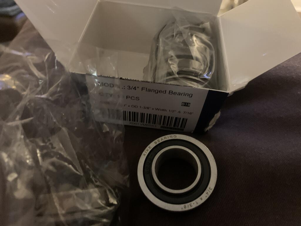

Horse Newbie 7,202 #715 Posted January 28, 2022 On 12/27/2021 at 6:22 PM, Jeff-C175 said: The 1980-ish C series. I've got a 125 and a 175 and they both use the same bearing. Not sure what your machine uses, but these may in fact fit. If you do use these, pop one of the seals, wipe out the vaseline that's in them, and put some GOOD grease in. Leave the inner seal out and fill the hub with grease, or..... leave both seals in place, which is what I did this time and I'm going to see how much life I get out of them without having to fill the wheel hub with grease... such a waste... I bought a 10 pack of these: https://www.amazon.com/gp/product/B01MF5A4GF/ But they're also available as a 'kit' of four with some shims, E-clips, and vinyl boots: https://www.amazon.com/dp/B08R73CWR2/ I received my new wheel bearings for the Work Horse today… thanks @Jeff-C175 for the information on these. I believe I’m gonna try running them with both bearing seals in place and see how they do. Share this post Link to post Share on other sites
Jeff-C175 7,203 #716 Posted January 28, 2022 9 minutes ago, Horse Newbie said: running them with both bearing seals in place I'm doing the same, but I HIGHLY recommend popping the seals, wiping out the vaseline and replacing it with REAL grease. You'll find a small smear of grease on one side only so once you ID which side you only need to pop one seal. 1 Share this post Link to post Share on other sites
Horse Newbie 7,202 #717 Posted January 28, 2022 8 minutes ago, Jeff-C175 said: I'm doing the same, but I HIGHLY recommend popping the seals, wiping out the vaseline and replacing it with REAL grease. You'll find a small smear of grease on one side only so once you ID which side you only need to pop one seal. Would you flush the bearing with brake cleaner, then blow dry, to get all the Vaseline out ? Share this post Link to post Share on other sites

Jeff-C175 7,203 #719 Posted January 28, 2022 2 minutes ago, Horse Newbie said: Would you flush the bearing with brake cleaner, then blow dry, to get all the Vaseline out ? I dunno... I didn't. I used q-tips and got almost all of it out. There's very little in them. 2 Share this post Link to post Share on other sites
kpinnc 13,789 #720 Posted January 28, 2022 (edited) 15 hours ago, Horse Newbie said: You'll find a small smear of grease on one side only so once you ID which side you only need to pop one seal. Or just pop both inner seals and use the grease zerks on the wheels. Edit: I didn't read back far enough. My bad. Edited January 28, 2022 by kpinnc 1 Share this post Link to post Share on other sites
Jeff-C175 7,203 #721 Posted January 28, 2022 Just now, kpinnc said: Or just pop both inner seals and use the grease zerks on the wheels. Uses a ton of grease! Actually a waste of grease IMO. And it's messy, at least for a trailer queen, but even for a worker it can hold dirt. At the speeds those bearings roll I'm sure that repacking with real grease and reinstalling the seal will be fine... I'll find out! 1 Share this post Link to post Share on other sites
kpinnc 13,789 #722 Posted January 28, 2022 1 minute ago, Jeff-C175 said: At the speeds those bearings roll I'm sure that repacking with real grease and reinstalling the seal will be fine... I'll find out! That is true. And repacking does work very well. I've done it many times myself. Mule drive bearings get that treatment here often. 2 Share this post Link to post Share on other sites
Lee1977 7,044 #723 Posted January 28, 2022 (edited) I just installed them as they came came, been on for over three years on the 312 . It likes to get the front in the air with the 25" All Trails II on the back. Edited January 28, 2022 by Lee1977 2 Share this post Link to post Share on other sites
Jeff-C175 7,203 #724 Posted January 28, 2022 (edited) 38 minutes ago, Lee1977 said: installed they as they came Didn't add any 'real' grease at all? Hey PETE! We got us a 'scofflaw' here! Edited January 28, 2022 by Jeff-C175 1 1 Share this post Link to post Share on other sites
Lee1977 7,044 #725 Posted January 28, 2022 You worried about something that cost $1.50 a piece. 2 Share this post Link to post Share on other sites
