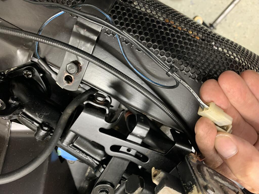

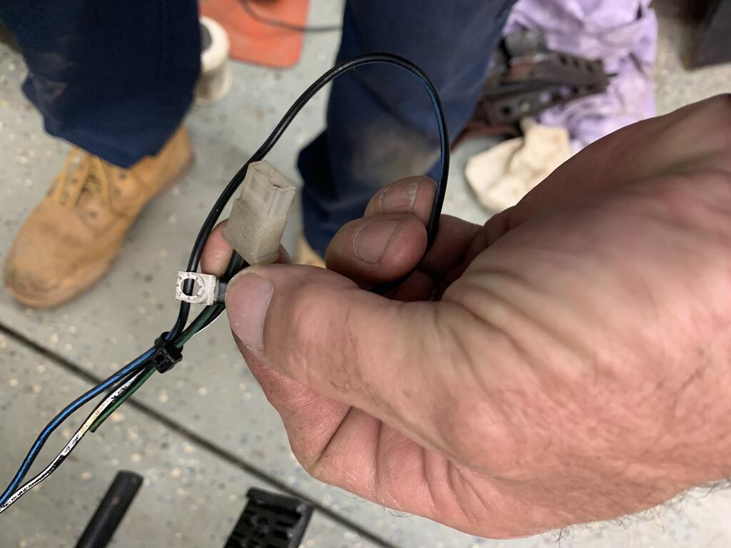

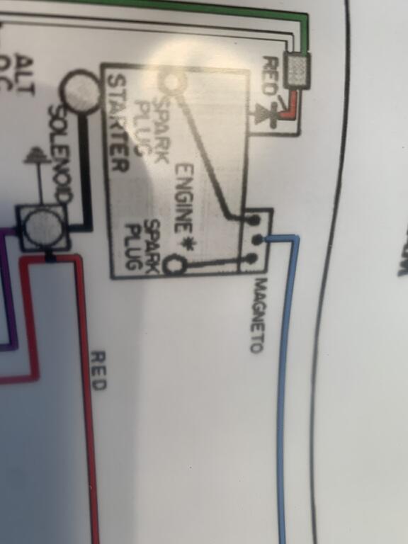

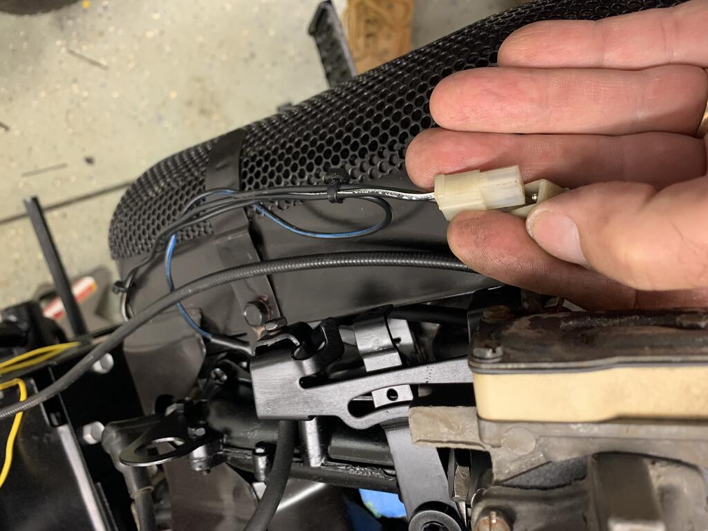

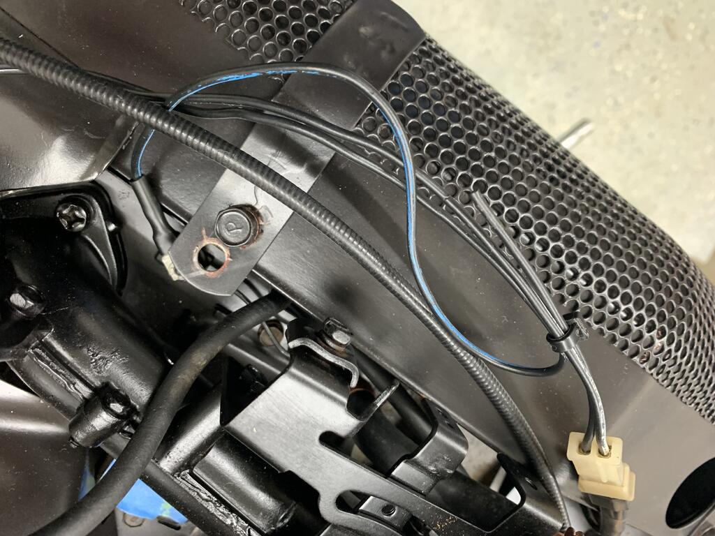

Horse Newbie 7,202 #628 Posted January 22, 2022 Is this the wire stud for the magneto on the twin Briggs ? There is a blue wire that goes to the magneto. I assume it is this blue wire because: a. It’s the only blue wire that I don’t have hooked to something. and b. It is zip tied to the same wire that goes to the two prong socket end that goes to the stator. Both of these are near each other. Share this post Link to post Share on other sites
Jeff-C175 7,203 #629 Posted January 22, 2022 (edited) 10 minutes ago, Horse Newbie said: Is this the wire stud for the magneto on the twin Briggs ? Does the other end go to the key switch? Does it conveniently reach the stud on the magneto? I could go out and look at my pressure washer (same engine) but not sure that would help... I'll head out in a little bit. Edited January 22, 2022 by Jeff-C175 2 Share this post Link to post Share on other sites

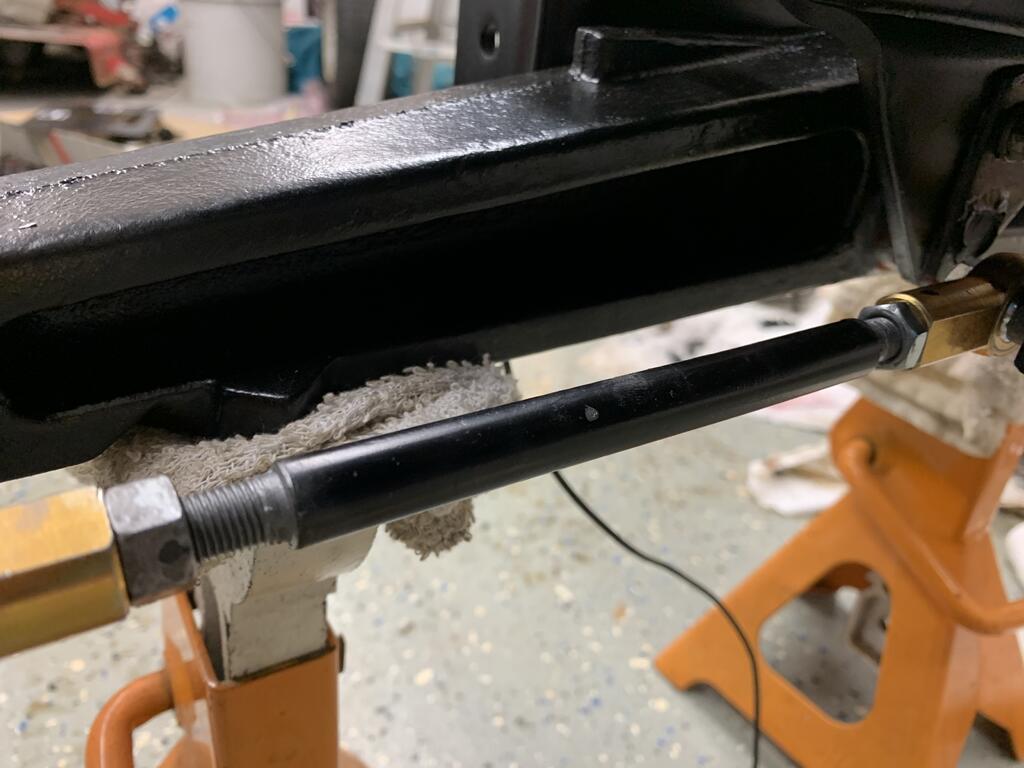

Horse Newbie 7,202 #630 Posted January 22, 2022 (edited) Got the jams nuts on the tie rod ends where @Jeff-C175 suggested… I previously only had jam nuts on one end Edited January 22, 2022 by Horse Newbie 4 Share this post Link to post Share on other sites
Bill D 2,097 #631 Posted January 23, 2022 The blue wire is the kill wire for the mag. The belt cover doesn't have to be on for the clutch to work correctly on the 300/400 series 8 speeds, or the Work Horse series. There is a belt brake bolted to the hood stand. Belt cover should be on for safety. 1 Share this post Link to post Share on other sites

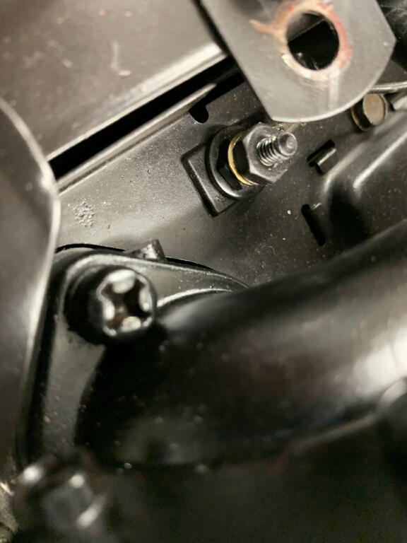

Horse Newbie 7,202 #632 Posted January 23, 2022 4 hours ago, Jeff-C175 said: Does it conveniently reach the stud on the magneto? You mean this stud ?… The one with the 2 nuts on it . Share this post Link to post Share on other sites

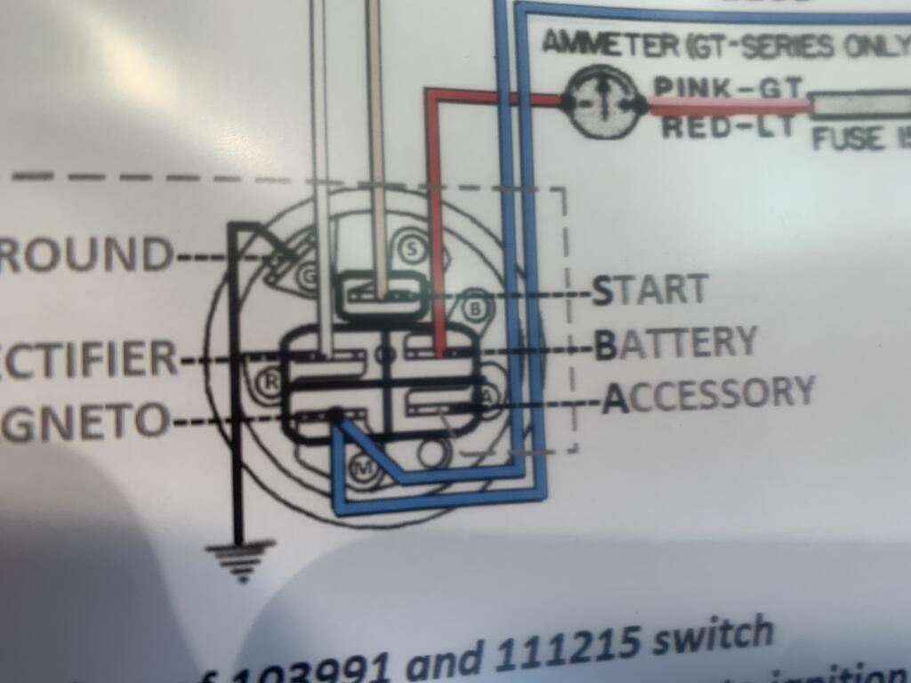

Jeff-C175 7,203 #635 Posted January 23, 2022 1 hour ago, Horse Newbie said: You mean this stud ?… The one with the 2 nuts on it . I believe so. That should be the "ground to kill" post on the magneto. Can't get a good shot on my engine, it's crowded there, but the arrow is pointing to that stud. The wire comes up and goes to that toggle switch which grounds that terminal when OFF. That's what your ignition switch does when it is off. I forget what those other wires are... too cold out there to hang around for long and figure it out again! 1 Share this post Link to post Share on other sites
