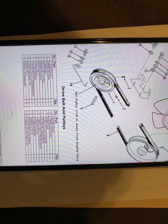

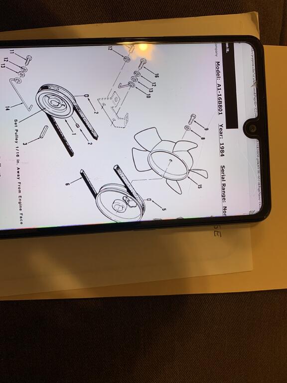

Horse Newbie 7,202 #454 Posted January 9, 2022 I may have asked before, but anyone familiar with the drive belt # for my 1984 Work Horse GT-1600 ? I came up with 2 part numbers, 7473 and 107939… looking at the Toro parts list it is part # 6, but it looks to me as a belt for a hydro, because the 8 speed has no cooling fan. Share this post Link to post Share on other sites
Lee1977 7,044 #455 Posted January 9, 2022 (edited) The belt should be 7473 82" x 5/8" for a 8 speed. Go to Tractor Supply and get one of there blue belts they are half the price of the Toro. Edited January 9, 2022 by Lee1977 1 1 Share this post Link to post Share on other sites
Horse Newbie 7,202 #456 Posted January 10, 2022 On 1/9/2022 at 10:00 AM, Lee1977 said: The belt should be 7473 82" x 5/8" for a 8 speed. Go to Tractor Supply and get one of there blue belts they are half the price of the Toro. @Lee1977 Do you think an 83” would work ? It’s all they have… or an 81”. ? Share this post Link to post Share on other sites
ebinmaine 70,802 #457 Posted January 10, 2022 1 minute ago, Horse Newbie said: @Lee1977 Do you think an 83” would work ? It’s all they have… or an 81”. ? No and no. I've tried. Your clutching action won't function. Share this post Link to post Share on other sites

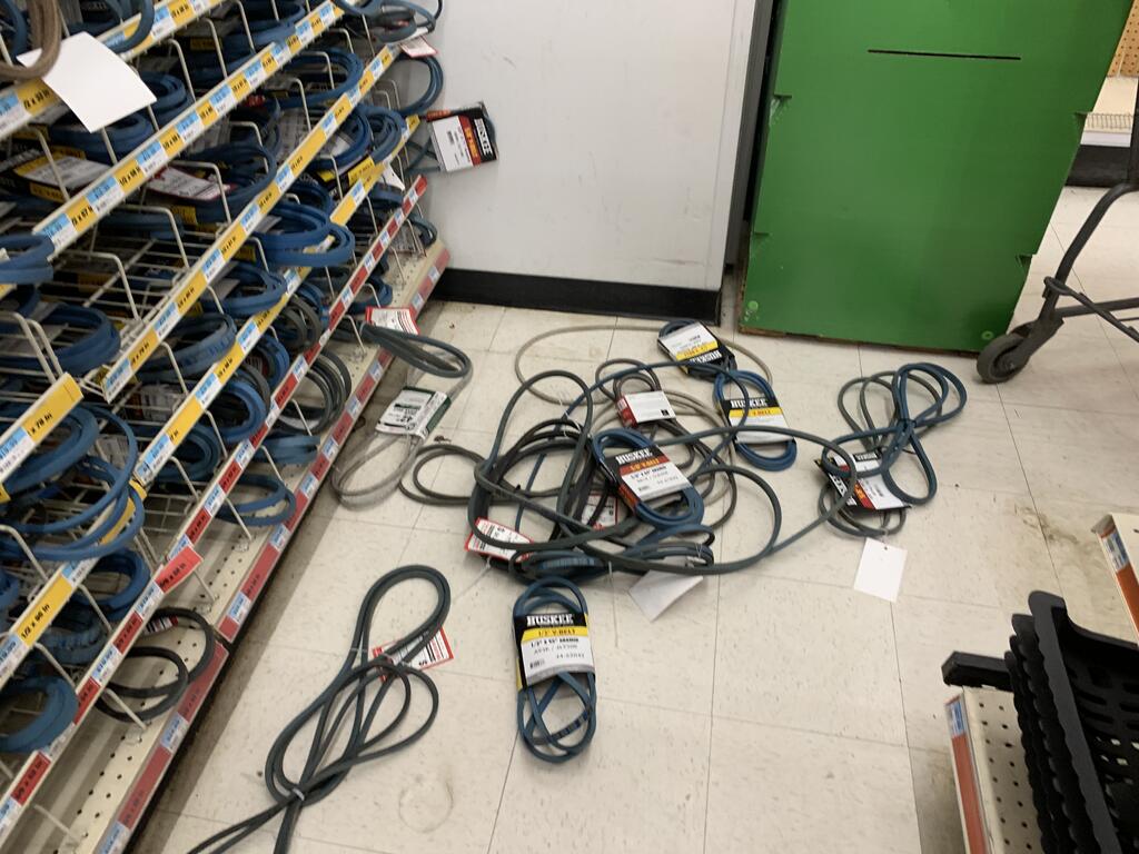

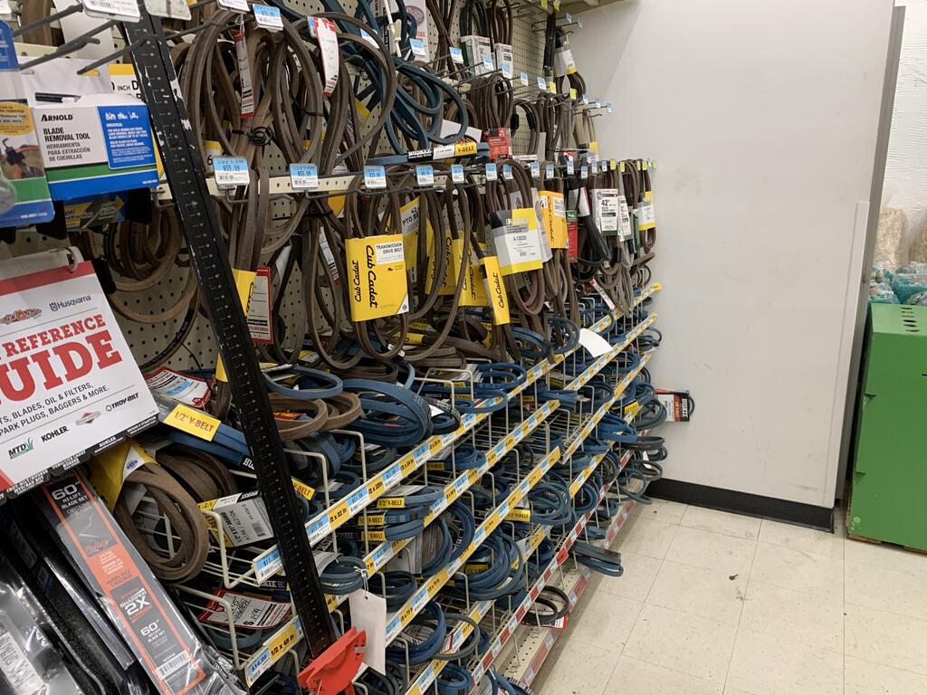

Horse Newbie 7,202 #458 Posted January 10, 2022 What I did at TSC… 1 1 Share this post Link to post Share on other sites
ebinmaine 70,802 #459 Posted January 10, 2022 8 minutes ago, Horse Newbie said: What I did at TSC… Oh wow. That looks like Sooooo much fun. Too bad I couldn't make it. Maybe next time. 2 Share this post Link to post Share on other sites
ebinmaine 70,802 #460 Posted January 10, 2022 (edited) I'd highly recommend ordering a Wheelhorse belt online. Edited January 10, 2022 by ebinmaine Correct autocorrect 1 Share this post Link to post Share on other sites
Horse Newbie 7,202 #461 Posted January 10, 2022 4 minutes ago, ebinmaine said: I'd highly recommend ordering a Wheelhorse belt online. From who ?… Toro… or at least an OEM Toro ? 1 Share this post Link to post Share on other sites
ebinmaine 70,802 #462 Posted January 10, 2022 4 minutes ago, Horse Newbie said: From who ?… Toro… or at least an OEM Toro ? Exactly. I'll PM you a link. 1 Share this post Link to post Share on other sites
ebinmaine 70,802 #463 Posted January 10, 2022 Check with @76c12091520h Brian too. 1 Share this post Link to post Share on other sites

Horse Newbie 7,202 #465 Posted January 11, 2022 I left TSC like this… 1 1 Share this post Link to post Share on other sites
Jeff-C175 7,203 #466 Posted January 11, 2022 14 minutes ago, Horse Newbie said: I left TSC like this… I straightened some of the hardware drawers the other day. 3 Share this post Link to post Share on other sites
Handy Don 13,340 #467 Posted January 11, 2022 (edited) 3 hours ago, Horse Newbie said: What I did at TSC… Looks like someone couldn't be bothered supervising their child(ren)? Edited January 11, 2022 by Handy Don 3 1 Share this post Link to post Share on other sites
Horse Newbie 7,202 #468 Posted January 11, 2022 @Handy Don… Actually I did this… I was looking for an 82 x 5/8 belt for my 1984 Work Horse GT-1600. They had a bunch of misc. belts on top shelf… they had to come down. I looked through all of them and put them back, plus put a few others in their correct slots. 3 Share this post Link to post Share on other sites
kpinnc 13,789 #469 Posted January 11, 2022 (edited) Tim, I do the same stuff. I just can't leave a mess like that, if for no other reason because it makes my search harder too! You gotta get the Work Horse on wheels and post some pics. I need some motivation! What you've done so far is very thorough, and I wanna see it when put together! Edited January 11, 2022 by kpinnc 1 1 Share this post Link to post Share on other sites

Bill D 2,097 #475 Posted January 11, 2022 (edited) The drive belt you need is 93-9809. You have to order it from Toro. It's a 83.5" belt. Whole size belts won't work properly on this tractor. I had an 84" belt ony GT1642 when I first got it. The belt guide was not adjusted properly. That combined with the longer belt allowed it to get jammed between the drive pulley and the clutch disc sending the tractor out of control. I don't want to see all your hard work ruined by running it into a tree by accident. Edited January 11, 2022 by Bill D 2 Share this post Link to post Share on other sites
