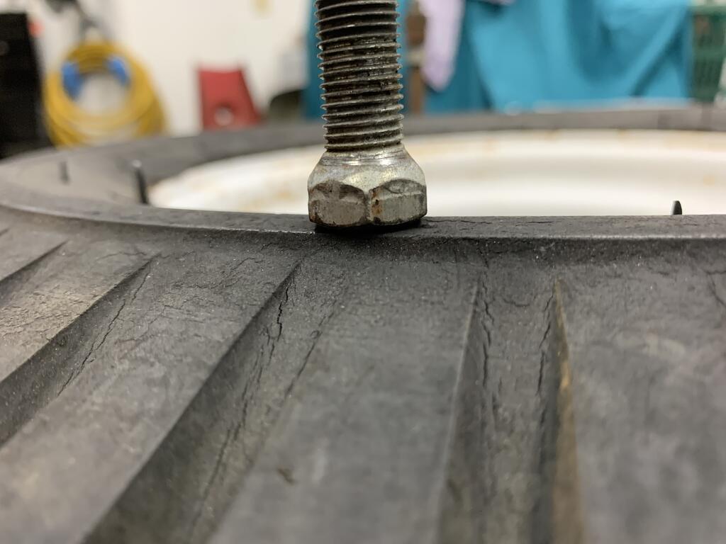

Horse Newbie 7,202 #301 Posted November 12, 2021 1 minute ago, Horse Newbie said: Because my 94 520H has the factory lug bolts with tapers I’ll double check tomorrow, but I could swear the lug “bolts” on my 520H have tapers... albeit small tapers... but I believe I remember seeing them. I’ll double check and let you guys know if my lug bolts have a small taper. Share this post Link to post Share on other sites
Handy Don 13,340 #302 Posted November 12, 2021 5 minutes ago, Horse Newbie said: I’ll double check tomorrow, but I could swear the lug “bolts” on my 520H have tapers... albeit small tapers... but I believe I remember seeing them. I’ll double check and let you guys know if my lug bolts have a small taper. Share this post Link to post Share on other sites
Horse Newbie 7,202 #303 Posted November 12, 2021 I just walked out to my shop and checked the lug bolts on the 1984 Work Horse GT-1600. They are tapered, and I’m almost certain the 1994 520H lug bolts are too... And on the Work Horse, I dropped a lug bolt in a hole while I was out there... the taper goes completely in the hole and does not fill the hole until the bolt head touches the wheel... Share this post Link to post Share on other sites
Handy Don 13,340 #304 Posted November 12, 2021 (edited) On 11/11/2021 at 9:56 PM, Horse Newbie said: I just walked out to my shop and checked the lug bolts on the 1984 Work Horse GT-1600. They are tapered, and I’m almost certain the 1994 520H lug bolts are too... And on the Work Horse, I dropped a lug bolt in a hole while I was out there... the taper goes completely in the hole and does not fill the hole until the bolt head touches the wheel... Yep, you can see the shiny part just a little ways up the taper where it's contacting the hole in the wheel and not the hub. So after all that, we now know that at least some WH wheels are mounted in the reverse of what we would do with an automobile wheel, judging from the hole bevels, but still use tapered bolts, and...it works just fine! Edited November 13, 2021 by Handy Don 1 Share this post Link to post Share on other sites
Horse Newbie 7,202 #305 Posted November 12, 2021 Well I may have spoke too soon on the post # 303... as you can see the shiny spot where the lug bolt bites... 5 minutes ago, Horse Newbie said: And on the Work Horse, I dropped a lug bolt in a hole while I was out there... the taper goes completely in the hole and does not fill the hole until the bolt head touches the wheel... Share this post Link to post Share on other sites
ebinmaine 70,808 #306 Posted November 12, 2021 1 hour ago, Handy Don said: Wheel centering is not the issue, of course, the hub handles that ONLY while installing the wheel. As the lugs are tightened up they group of lug nuts as a whole centers the wheel. 1 hour ago, Handy Don said: Also just realized that my spacer idea would likely move the wheel out from the hub to far to permit the center hole to center the wheel on the hub. This is a non issue. I've used 2" and 3" spacers with NO concentric ring so the wheel CAN'T be lined up in the center. I've done this on tractors and road vehicles alike. As I've been reading down through the above posts I remembered that my own 1974 C160 Cinnamon Horse has the same lug holes that appear to be made wrong. I'd also like to note that I use 1/2" studs. Not the stock 7/16". That leaves even less room to align the lug nuts. That tractor weighs as much as 1300 to 1400 lbs. More than double stock weight. I also regularly pull loads of 1000 lbs or more. When I change tires to go from work to shows/get togethers I retorque after an hour or so, and again later. That's a habit from the trucking world. My wheels. Don't. Loosen. 2 Share this post Link to post Share on other sites
Greentored 3,220 #307 Posted November 12, 2021 This wheel issue is a strange one for sure! I do know those overrated green tractors sometimes run wheels with the deeper dish toward the center, perhaps they came off one of those? FWIW, I installed 1" spacers with 1/2" studs on my off road Horse and had to drill the holes out, losing pretty much all of the taper, and run standard automotive tapered lugs, and have had zero issues. If they're staying put on that thing, believe me, you'll be just fine 2 Share this post Link to post Share on other sites
ebinmaine 70,808 #308 Posted November 12, 2021 5 minutes ago, Greentored said: FWIW, I installed spacers with 1/2" studs on my off road Horse and had to drill the holes out, losing pretty much all of the taper, and run standard automotive tapered lugs, and have had zero issues Same here. No worries.... 1 Share this post Link to post Share on other sites
Gregor 4,847 #309 Posted November 12, 2021 Several of mine are drilled out also. 1 Share this post Link to post Share on other sites
Horse Newbie 7,202 #310 Posted November 12, 2021 1 hour ago, Greentored said:If they're staying put on that thing, believe me, you'll be just fine Thanks for the reassurance guys... I wasn’t too worried about it... just wondered if the wheels were right. The only real concerns I had was those high banked turns at Daytona and Talladega... 1 1 2 Share this post Link to post Share on other sites

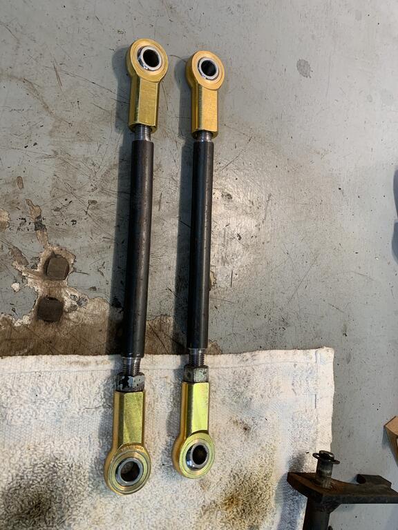

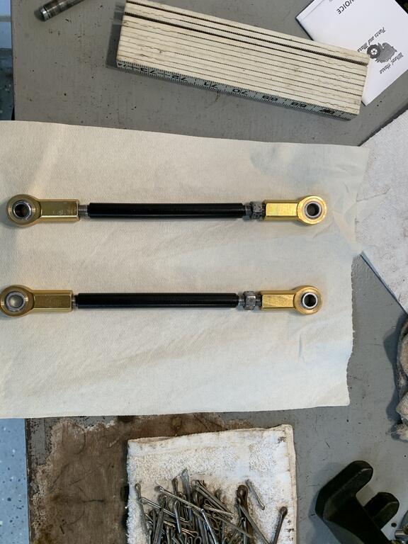

Horse Newbie 7,202 #314 Posted November 13, 2021 Made up my tie rods today... 3 4 Share this post Link to post Share on other sites
ebinmaine 70,808 #315 Posted November 13, 2021 1 hour ago, Horse Newbie said: Made up my tie rods today... Wish we had a lathe.... 1 Share this post Link to post Share on other sites
Horse Newbie 7,202 #316 Posted November 13, 2021 1 minute ago, ebinmaine said: Wish we had a lathe.... I wish I had one too... don’t HAVE one, HAVE access to one... and he’s looking to move away... Share this post Link to post Share on other sites

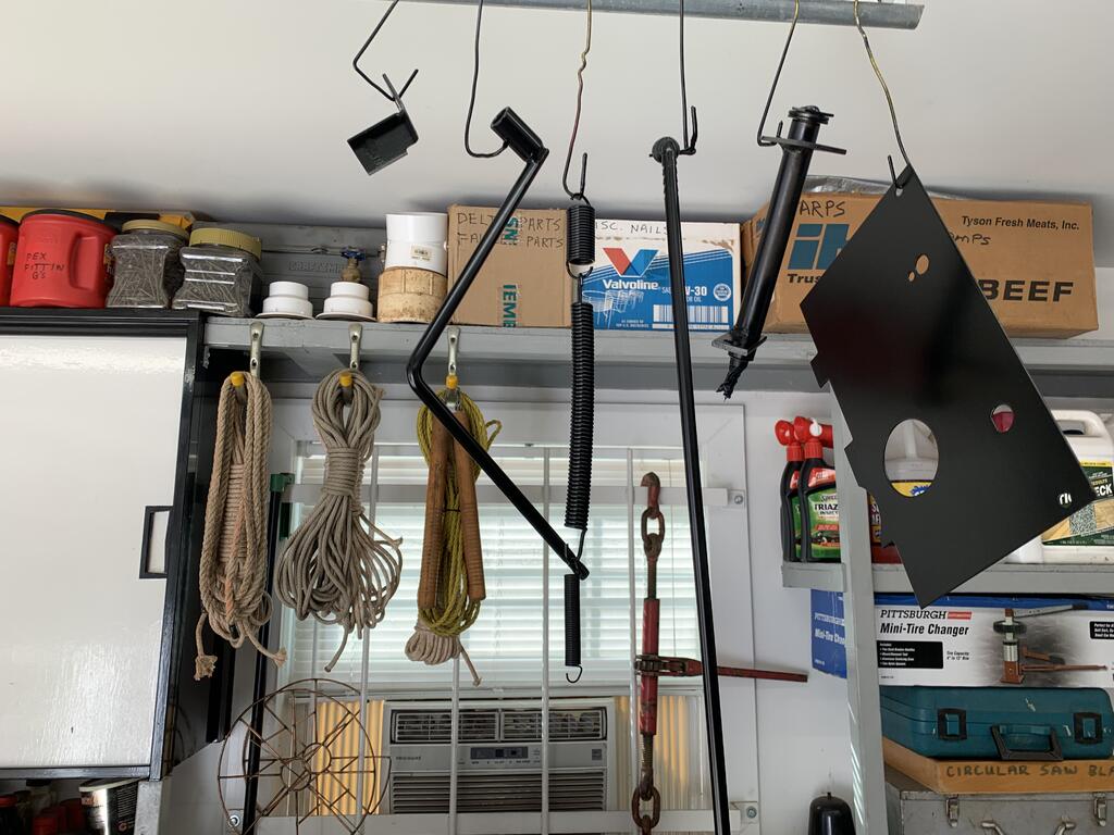

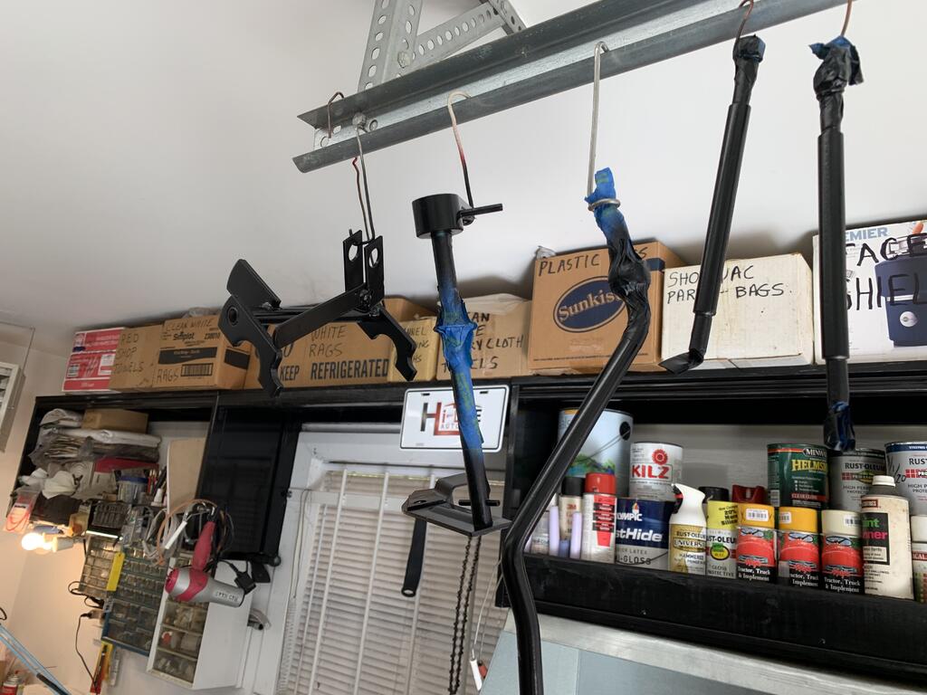

Horse Newbie 7,202 #317 Posted November 13, 2021 I painted some more parts today… reassembly starts next ! 2 Share this post Link to post Share on other sites

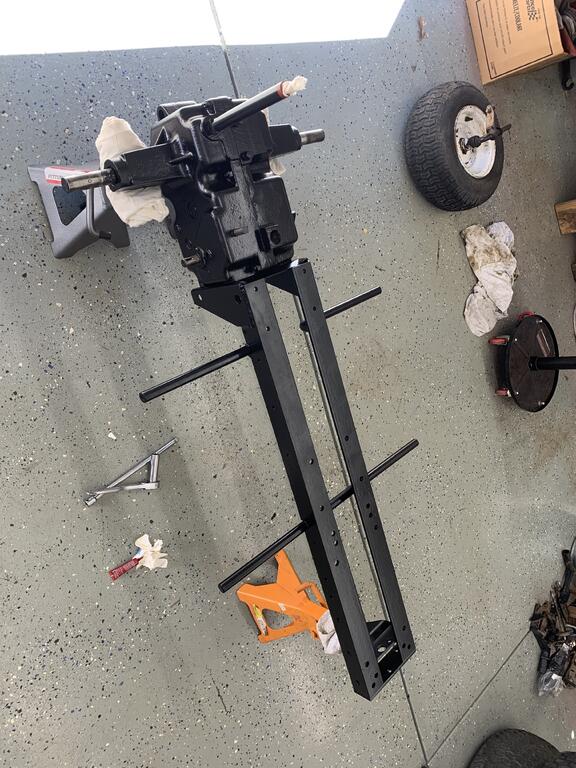

Horse Newbie 7,202 #318 Posted November 13, 2021 Reassembly has begun… 2 4 Share this post Link to post Share on other sites
Jeff-C175 7,203 #319 Posted November 13, 2021 Somebody had to do it. You probably knew it would be me! I love them coffee containers for storage too! 3 Share this post Link to post Share on other sites

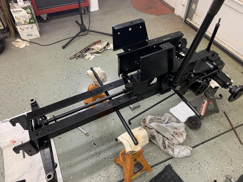

Horse Newbie 7,202 #320 Posted November 14, 2021 This is about how far I got on the reassembly… 2 3 Share this post Link to post Share on other sites

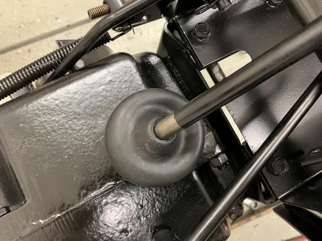

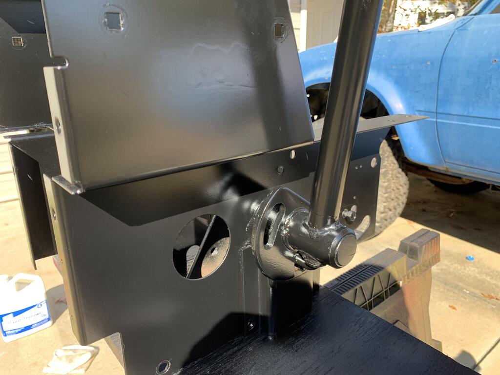

Horse Newbie 7,202 #321 Posted November 14, 2021 (edited) Is the shifter boot supposed to go over the detent screw ? Edited November 14, 2021 by Horse Newbie 2 Share this post Link to post Share on other sites
AMC RULES 37,147 #322 Posted November 14, 2021 Yes. 3 1 Share this post Link to post Share on other sites
Horse Newbie 7,202 #323 Posted November 14, 2021 Got my tie rods painted and the ball joints on… 1 2 Share this post Link to post Share on other sites
WheelHorse520H 708 #324 Posted November 14, 2021 8 minutes ago, Horse Newbie said: This is about how far I got on the reassembly… Lookin’ mighty slick. 2 1 Share this post Link to post Share on other sites
Horse Newbie 7,202 #325 Posted November 14, 2021 23 hours ago, Horse Newbie said: Is the shifter boot supposed to go over the detent screw ? I put the boot over the detent screw and now it looks like the screw may poke a hole in the boot… 23 hours ago, AMC RULES said: Yes. Share this post Link to post Share on other sites
