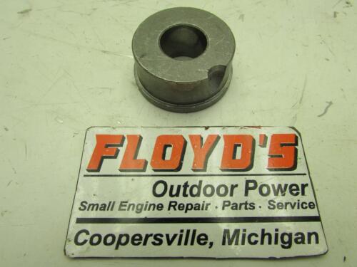

Snoopy11 5,714 #24 Posted October 14, 2021 (edited) Here is a picture of a new bushing... Don Edited October 14, 2021 by Snoopy11 1 Share this post Link to post Share on other sites
Snoopy11 5,714 #25 Posted October 14, 2021 Some people go with bronze... and other types... Don 1 Share this post Link to post Share on other sites
