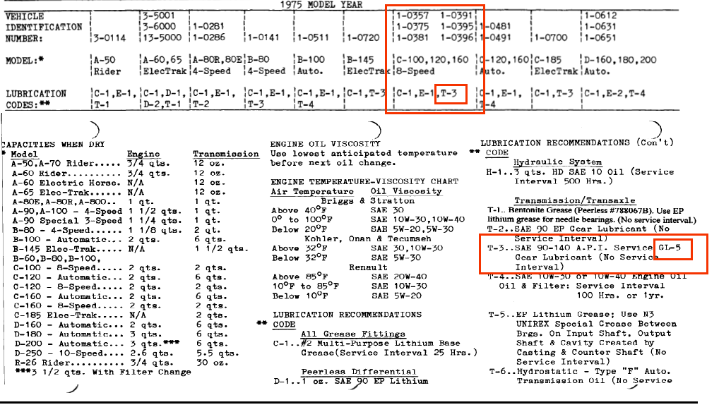

rmaynard 15,927 #7 Posted September 16, 2021 Straight from the Toro/Wheel Horse Lubrication document, with 1975 C-160 highlighted: Since these transmissions have lasted all this time, I will follow what the Ponds decided was best. 4 Share this post Link to post Share on other sites
