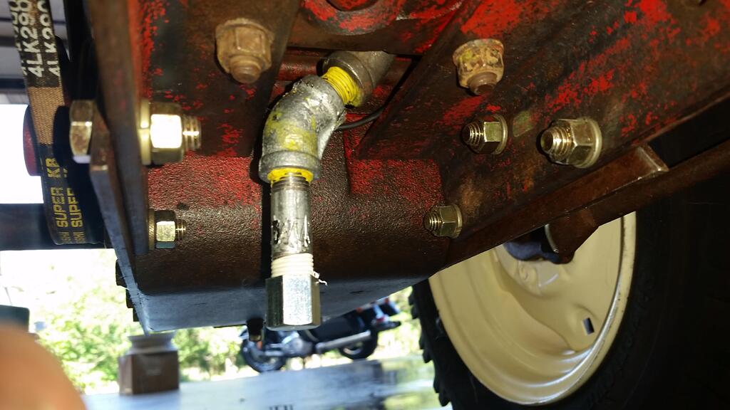

Need help adding oil drain piping to Koehler K241 with 1/2” drain plug
A 1/2" street L 90, a nipple long enough to clear the frame and a pipe cap should do the trick.

Jeff-C175
Don't most all small engines use 3/8" pipe thread?
I can't recall owning one that used 1/2" pipe, but i believe the wrench size on the square head 3/8" pipe plug is 1/2".
Edited by Jeff-C175
Every Horse I have is 3/8"

@squonk , simple . 3/8 " ball valve , with matching  3/8 plug , make up a screw in hose for plug removal , pete

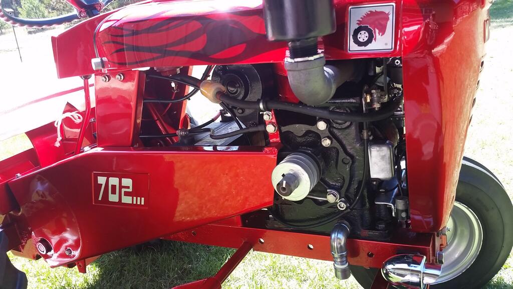

This my friends is 1/2 on a 161
Ohhhh you wanted stainless.... $XX times 30 horses = yah not gonna happen. I could see Squonkys valve for a special horse tho. Say a good worker or plow mule that requires frequent changes.
Seriously pretty sure a 241 is 3/8 NPT &  got a little fancy with this one. My life's goal is change oil someday with out making a mess or spilling one single drop. Prolly never gonna happen..... :lol:

Nail down the size Woodbird and plan your routing. Then go and go visit Ace is the friendly place and pick up some black fittings & nipples. Don't be afraid to get multiple length  nipples they are not real pricey.

I put the EZ on the C-160. It does the mowing and with the hose extension I don't have to take the heavy Recycler Deck off

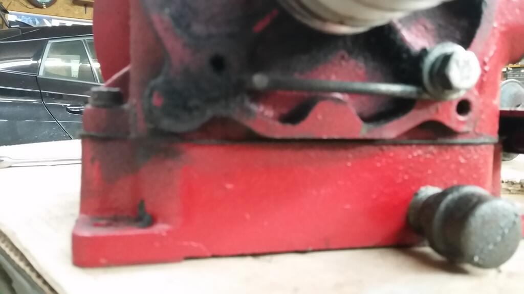

      Info needed.
      Going to put a oil drain on this engine next oil change and don't really know what I need to start. Trying to get parts ready before time.
      I don't know what size the existing plug is ( see photo ) 3/8" 1/4" ? Getting tired of taking the deck down every time I change oil. Any input welcome.
