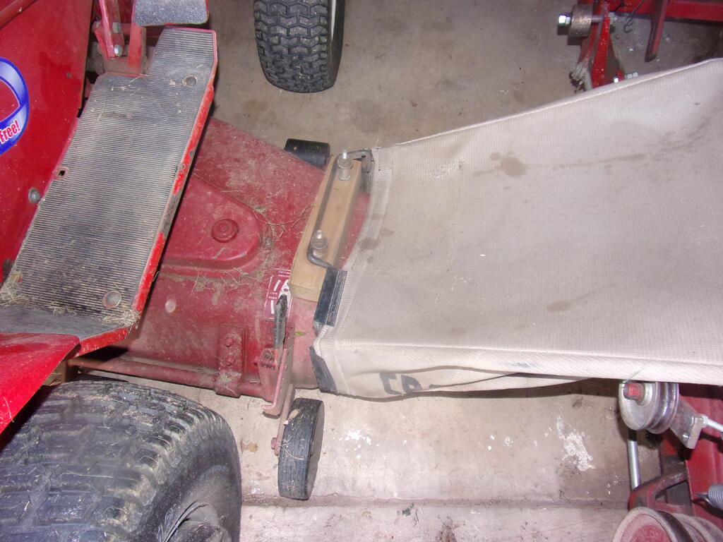

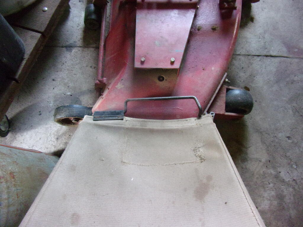

Ed Kennell
I have a side bagger on my 42"SD.   A couple bolts and a spacer block.  It  does fill quickly, but I actually dump it in my cart w/o leaving the seat.    Works great.
The same arrangement would work on my 48"SD as well.
Edited by Ed Kennell
D.College
Ed - THANKS - Looks like exactly what I had in mind.  I was looking at it with the bag off of my Honda 216 - attaches differently, no rod.  But now I know what can work and will be looking for one with some type of bar.  Looks like your Craftsman fits the bill 100%.  Thanks for the photos......Dave
