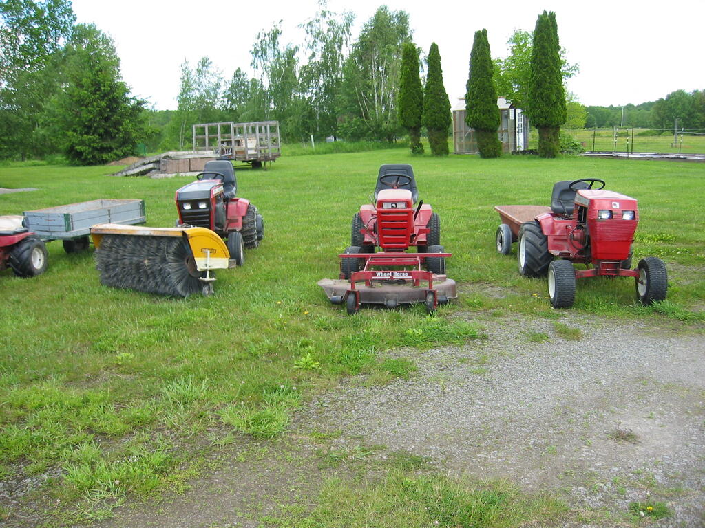

pfrederi
You might want to start with a front mount mower.  I use mine sort of like a bush hog. Since it gets to the stuff before the tractor has run over it knocking it down it does better job.  Since it is out front you could cut off the front lip if the deck (Just don't tell OSHA)
