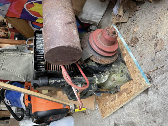

AHS 1,491 #1 Posted August 28, 2021 Ok, so the M16 was on a Massey Ferguson….. wrong motor.. as is was supposed to be an Onan 20hp. And, the M16 had a Wheelhorse red clutch on it!! Well, I traded the M16 for about 3 hours worth of work!! It’s going back on a Wheelhorse😀!!! SO… Now for the bad part… the motor has been sitting outside with no air filter on it. That means just carburetor + rain = rust on the inside of the motor. I know, I know! It turns over smooth. First thing I’m going to do is drain the oil and see how much water is in it, and I’m going to remove the head, and see how it is in there; along with a new head gasket. The motor is covered up by a tarp at this point! The motor will be used for snowblowing, (I’m sure!) and other things. The snowblower is gonna put the biggest tax on it!! Any other known problems with the M16? As you can tell I’m excited to get into the build!!😀 2 1 Share this post Link to post Share on other sites
953 nut 57,969 #2 Posted August 28, 2021 I would remove all the engine tins, bound to be some critters nesting in there under the tarp. Do this before you bring it in the shop so the critters don't have a nice new home. Check for spark, sand the rust off the flywheel and magnets. Block off the fuel pump opening and get an electric fuel pump. 3 Share this post Link to post Share on other sites

AHS 1,491 #11 Posted September 1, 2021 The M16 is home! I have changed the oil and there is no water in there! No begin un tinning the motor! 3 Share this post Link to post Share on other sites
