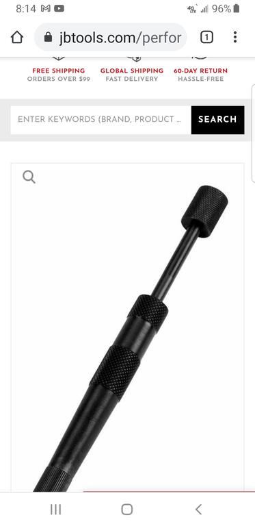

gt14rider
Try one of these, hit this tool with hammer clears out old grease. Grease fitting clean out tool
c-series don
I have one and I must say that for the most part they do work. Sometimes that and some heat does the trick!
