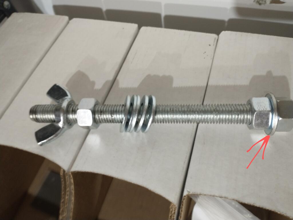

ebinmaine 68,639 #4 Posted August 23, 2021 18 minutes ago, stevasaurus said: Make sure you account for all 12 balls in that bad bearing Actually Steve now that you bring it up... That by itself would be a good enough reason to lift the gears out for just a minute. I've found roller bearings in transmissions that weren't missing any roller bearings. 19 minutes ago, stevasaurus said: use a bearing puller to pull out the #1533. I learned a neat trick to do that from Lincoln at A to Z. You can make a driver out of a large bolt and correctly size washers. Takes a little patience but I was successful and I've done it multiple times. I can share a picture and dimensions later if you like. 1 2 Share this post Link to post Share on other sites
OutdoorEnvy 1,598 #5 Posted August 23, 2021 18 minutes ago, ebinmaine said: I learned a neat trick to do that from Lincoln at A to Z. You can make a driver out of a large bolt and correctly size washers. Takes a little patience but I was successful and I've done it multiple times. I can share a picture and dimensions later if you like. I think I'm following the idea here...did you also use it to press the new one in? I did something similar a couple times to put the power steering pulley back on some old chevy 350's. Share this post Link to post Share on other sites
ebinmaine 68,639 #6 Posted August 23, 2021 2 minutes ago, OutdoorEnvy said: I think I'm following the idea here...did you also use it to press the new one in? I did something similar a couple times to put the power steering pulley back on some old chevy 350's. In that particular case I had a bearing driver set on hand but if I don't have that with me I've been known to use an old bearing housing as the driver against the new bearing with an appropriate sized block of wood above it to span the bearing surface and absorb the impact of the hammer. 1 Share this post Link to post Share on other sites

David414 289 #14 Posted August 23, 2021 4 hours ago, ebinmaine said: Actually Steve now that you bring it up... That by itself would be a good enough reason to lift the gears out for just a minute. I've found roller bearings in transmissions that weren't missing any roller bearings. I learned a neat trick to do that from Lincoln at A to Z. You can make a driver out of a large bolt and correctly size washers. Takes a little patience but I was successful and I've done it multiple times. I can share a picture and dimensions later if you like. I would really like to see those pictures please. Sounds interesting! 2 Share this post Link to post Share on other sites

tunahead72 2,446 #17 Posted August 24, 2021 10 hours ago, ebinmaine said: ... I learned a neat trick to do that from Lincoln at A to Z. You can make a driver out of a large bolt and correctly size washers. Takes a little patience but I was successful and I've done it multiple times. I can share a picture and dimensions later if you like. Yes, please. Share this post Link to post Share on other sites

ebinmaine 68,639 #19 Posted August 24, 2021 13 hours ago, David414 said: I would really like to see those pictures please. Sounds interesting! 7 hours ago, tunahead72 said: Yes, please. I don't have an open transmission right now to demonstrate exactly where the bolt goes. If you look at the picture below you'll see the bolt I use. Basically what you do is either flip the wing nut upside down or use one of the other nuts and put it right at the top end of the bolt or threaded rod. You'll be tapping on that end so it keeps it from banging up the threads. With the differential removed I put the bolt from the inside out through the housing where the axle goes out to the outer wheel bearing. The washer that I have called out with a red arrow should fit through, and then, just behind the inner wheel bearing. The 1533 ball bearing. You just give it a little tap on one side and slowly work your way around the circle a couple times and it will usually loosen things up a little. Keep repeating this with slightly increasing tapping pressure. As you work your way around in the circle the 1533 bearing will gradually come out. I've done this four or five times now and been successful. I'm not sure I would recommend doing this on a bearing that you are trying to save... I have, and it worked okay but you do run the risk of separating the inner bearing shell from the outer bearing shell. 2 Share this post Link to post Share on other sites
