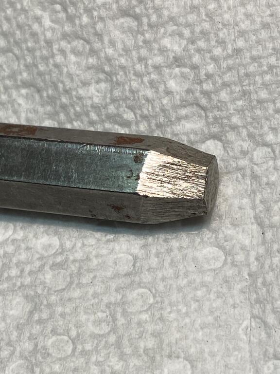

lynnmor 7,478 #12 Posted August 22, 2021 (edited) I get a piece of hex key wrench that is one size larger and then grind the flats at a taper till the end is the correct size. Then I hammer it into the knackered hole and use a socket to turn it out. Here is one example, others that I use have less taper. Edited August 22, 2021 by lynnmor Added photo. Share this post Link to post Share on other sites
