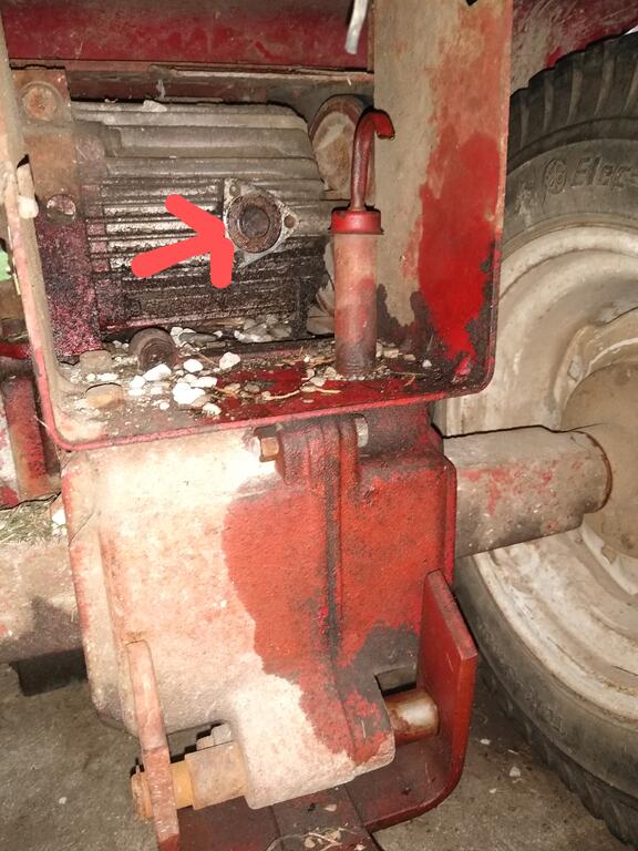

I was pulling a roller and thatch rake the other day with my c120 hydro and noticed oil on the back of the fender. On looking closer I saw the plug thing on the back of the pump leaking oil. Any advice on how serious this will be to repair? Anything helps

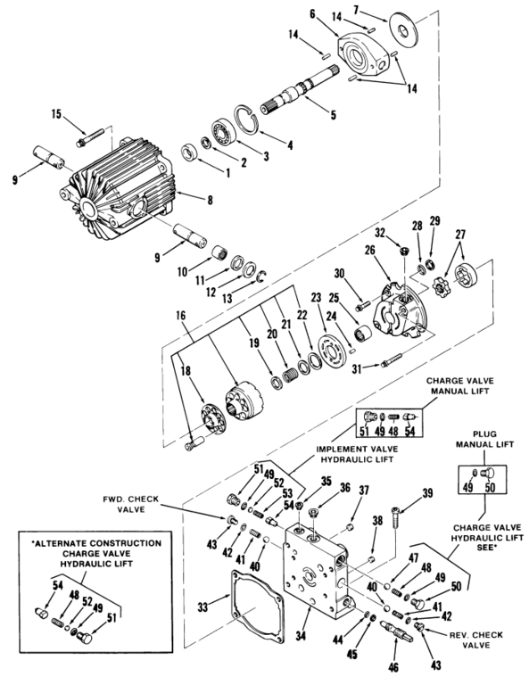

There is a 'lambert ring' (13) and behind that is a washer(12), then a seal (11) behind that.  You MAY be able to replace the SEAL ----IF-----you can get to it without taking the pump off.  MAYBE.  This pic in this schematic should help.
