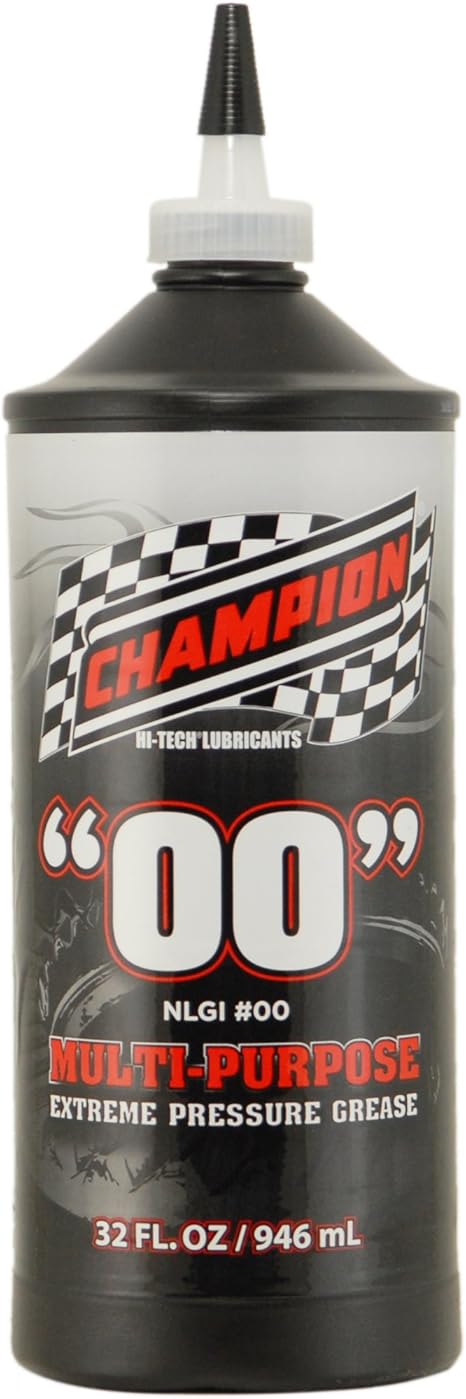

squonk 44,860 #3 Posted August 18, 2021 Ariens uses this grease in their gear boxes. Also available from aftermarket suppliers. "Ariens Knows Snow" Share this post Link to post Share on other sites

David Portenier 8 #6 Posted January 20 Only use this in the 44 inch two stage blower main gearbox and auger gearbox. There is "yellow" gears/metal used in them,.,,,,,and you want a gear oil that's ONLY GL-4. Share this post Link to post Share on other sites
