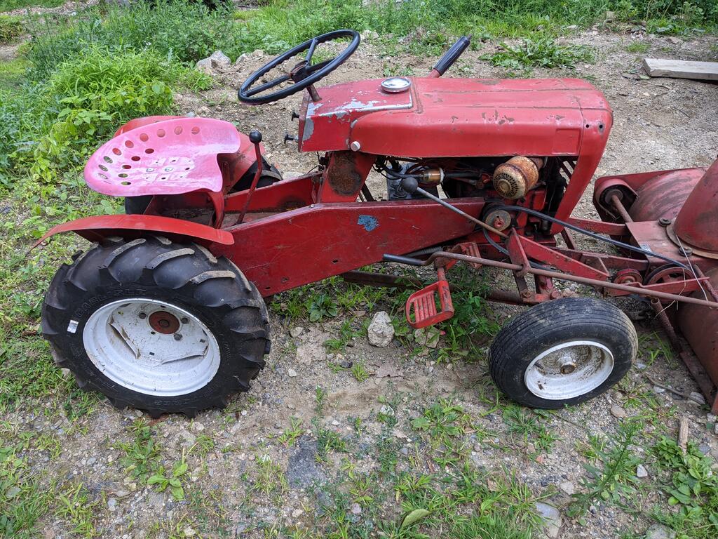

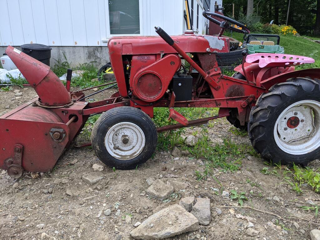

Beezer00 5 #1 Posted August 17, 2021 (edited) Picked up my first wheel horse, not sure of any information on it. I Believe it has a thrown rod. Any information of year or model would be greatly appreciated. Thanks! Edited August 17, 2021 by Beezer00 2 Share this post Link to post Share on other sites
rjg854 11,732 #2 Posted August 17, 2021 We need pictures or lot more information to be able to help you Share this post Link to post Share on other sites
Ed Kennell 39,829 #3 Posted August 17, 2021 to the Beezer. Can we see a pic of the belt guard ? Share this post Link to post Share on other sites
Pullstart 63,633 #4 Posted August 17, 2021 under the gas tank from the seat there should be a shift patter decal with a serial number. Round hoods are come of the best hoods! Share this post Link to post Share on other sites

Beezer00 5 #8 Posted August 18, 2021 On 8/17/2021 at 6:38 PM, rjg854 said: We need pictures or lot more information to be able to help you 1 Share this post Link to post Share on other sites
Beezer00 5 #9 Posted August 18, 2021 Will this help any? 1 Share this post Link to post Share on other sites

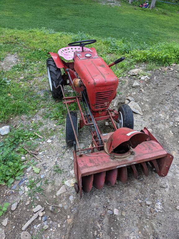

Shynon 7,474 #10 Posted August 19, 2021 1962 702 with a 701 drive belt guard Share this post Link to post Share on other sites
Retired Wrencher 5,592 #11 Posted August 19, 2021 Beezer You came to right place for this. Share this post Link to post Share on other sites
rmaynard 15,819 #13 Posted August 19, 2021 (edited) Thanks for the extra pictures, but a better picture of the generator belt cover would answer some questions. Need to be able to see it from the front to see how wide it is. There is no left side cover (701), the drive belt cover is a 701. Dash is 701. No parking brake (701). Rear fender support (tool box) is 702. Stirrup foot rest is 702. Edited August 19, 2021 by rmaynard 1 1 Share this post Link to post Share on other sites
