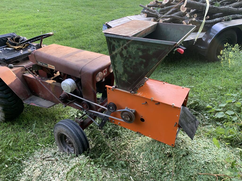

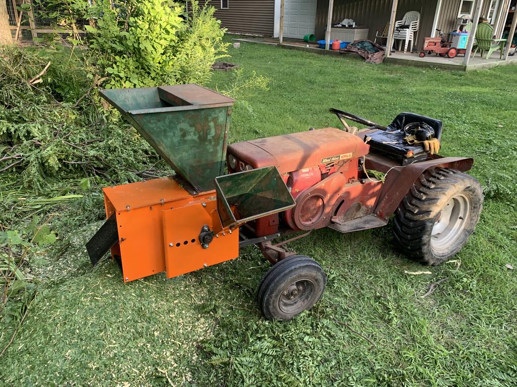

JUSS10 250 #1 Posted August 15, 2021 Recently picked up an old mackissic chipper/shredder with the intention of converting it to 3pt for my kubota. Well I started looking it over and frankly got impatient to build the 3pt setup so I adapted it to my 1054. I know they made these for later model tractors in the 70s and on but never saw one on a 1054. Worked out pretty easy actually. The 1054 outside frame width is 8” and the inside width of the chipper is 9. I took two pieces of bar stock that were 1/2” thick and made a “H” bracket by welding them together with a piece of 1x1 tubing. It bolts to the front of the frame and to the back of the chipper no issue. Next I needed to figure out belt routing. Had a mower deck for a 1054 I wasn’t using so I grabbed the two idler pulleys off that. The grooved one I bolted in to the side of the grill piece where there was already a hole. The flat pulley I mounted to a piece of flat stock and welded that to a sleeve bushing that ties to the H bracket with a bolt. Finally I used a spring pulled back to the frame under the engine to keep tension. thw whole setup works surprisingly well with little effort. I still may make it 3pt to have the added horse power but thought I’d share it. 9 8 Share this post Link to post Share on other sites
gwest_ca-(File Mod) 11,844 #3 Posted August 15, 2021 Nice setup. It may work better if the spring loaded idler was on the bottom belt span. The top span is the load side and as the load varies the belt tension changes. Easier to take up with the idler on the bottom. Garry 3 3 Share this post Link to post Share on other sites
kpinnc 16,181 #4 Posted August 15, 2021 Very nice! 2 Share this post Link to post Share on other sites
JUSS10 250 #5 Posted August 15, 2021 9 hours ago, gwest_ca said: Nice setup. It may work better if the spring loaded idler was on the bottom belt span. The top span is the load side and as the load varies the belt tension changes. Easier to take up with the idler on the bottom. Garry yup you are right. That said, I needed something on the top to pull the belt down a little as it was wanting to rub on the side of the grill housing. may have to add a fixed flat pulley on top to keep it down and then a tensioner on the bottom as well. this was a “toss it together with what I have” sort of deal. Work in progress for sure! 4 Share this post Link to post Share on other sites
