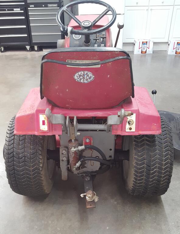

Gregor 4,847 #1 Posted August 14, 2021 I have a Massey Ferguson 16 with a start of a 3 point hitch. Are 3 point hitch parts specific to tractor brands, or are they pretty much generic for most garden tractors? 2 Share this post Link to post Share on other sites

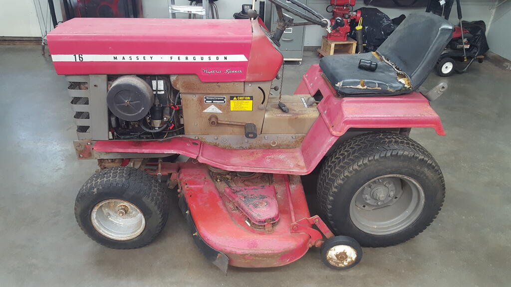

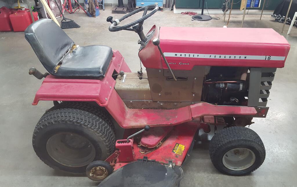

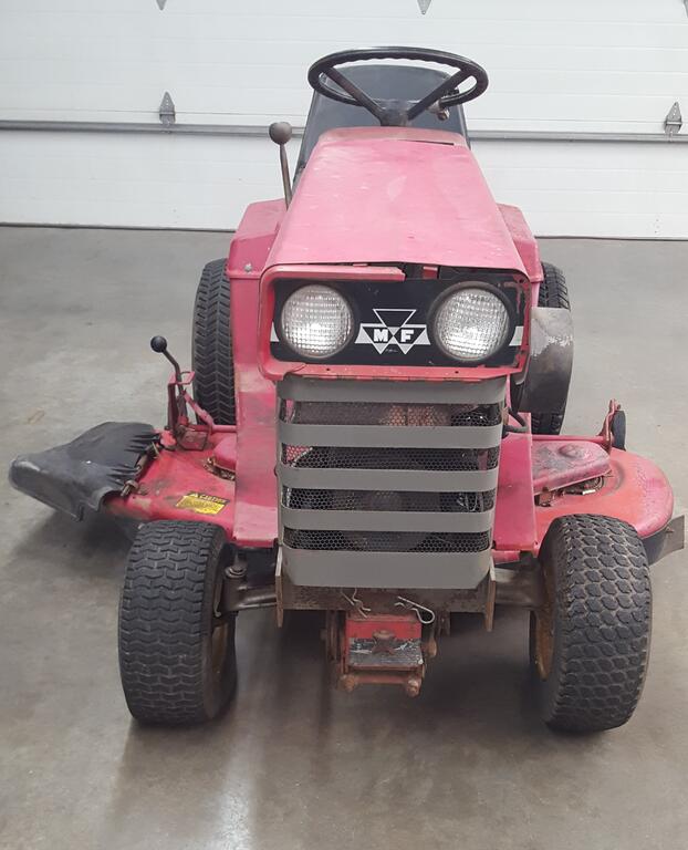

Gregor 4,847 #7 Posted August 15, 2021 1975 (?) MF 16. Probably the most complete older tractor I have bought. Everything is there, save the rest of the 3 point hitch. I replaced the coil and condenser, cleaned the points, thoroughly cleaned the fuel system with new lines, and filer, mounted the solenoid to the frame, and put on a China carb. It fired right up. I have 2 14's and have been looking for a 16 for several years. This one popped up on FB, and I was able to snag it up. It needs a little spit and polish, but I will get to it eventually. Now I just need to find my Senior, or lever steer. 1 Share this post Link to post Share on other sites
