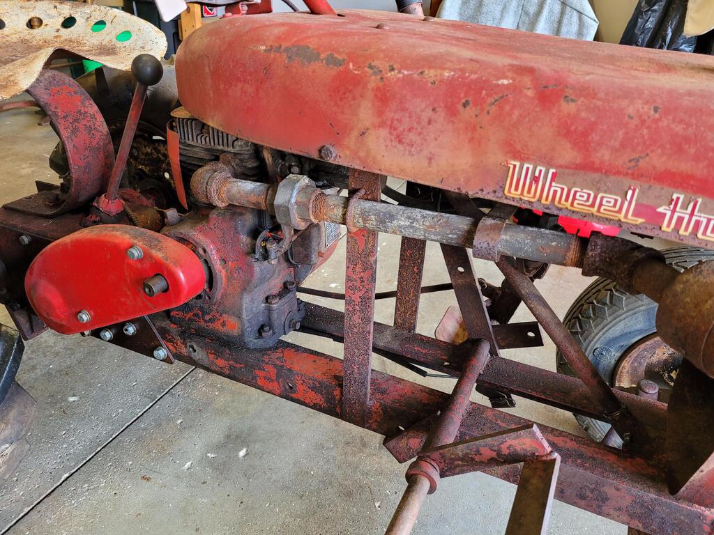

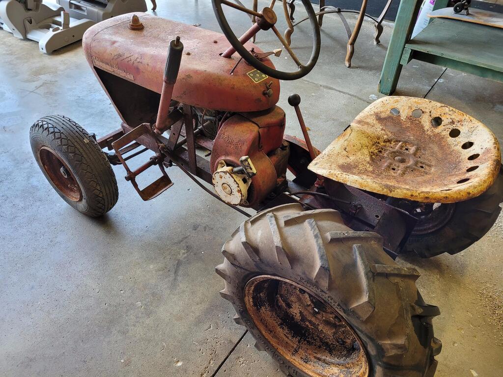

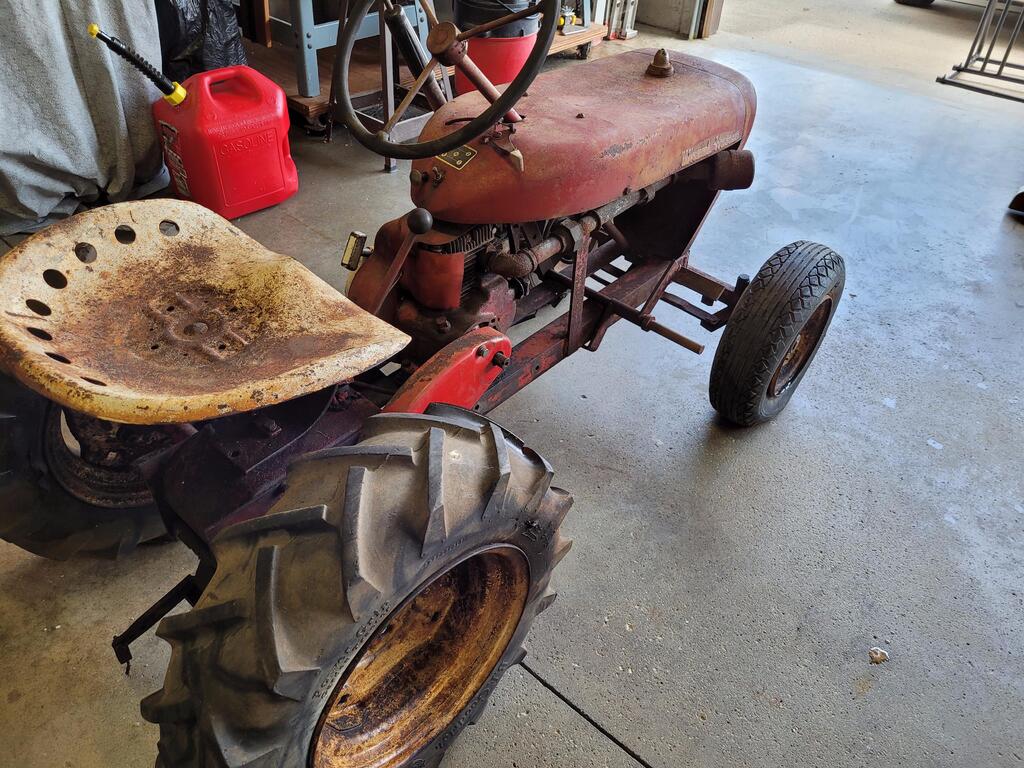

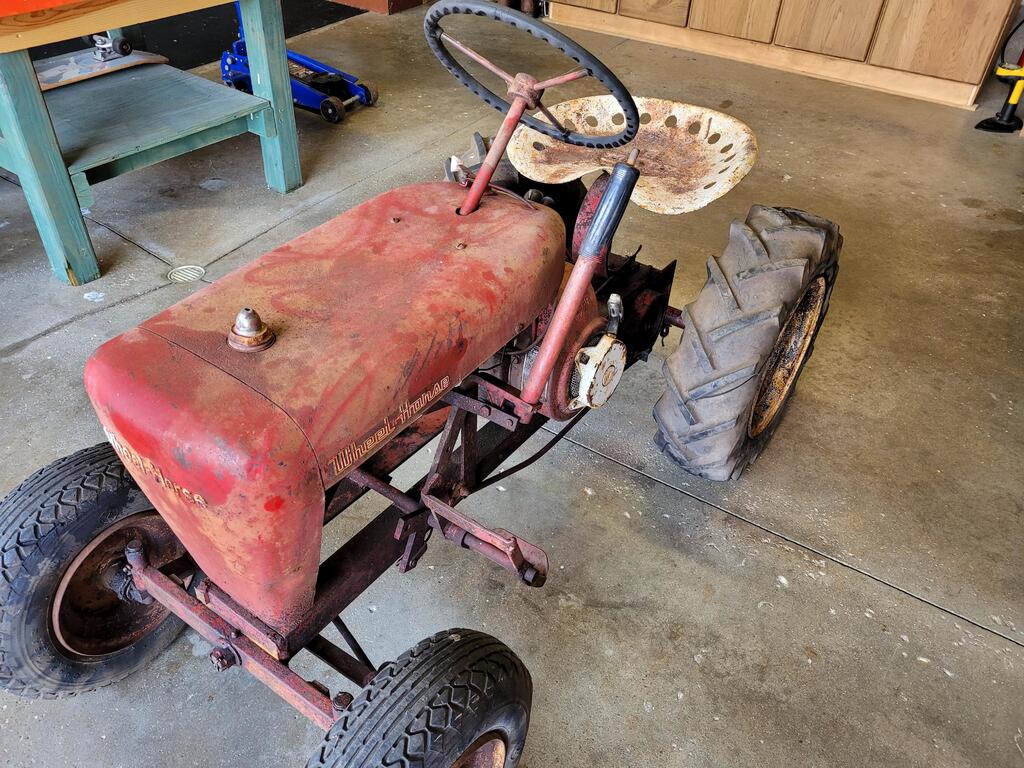

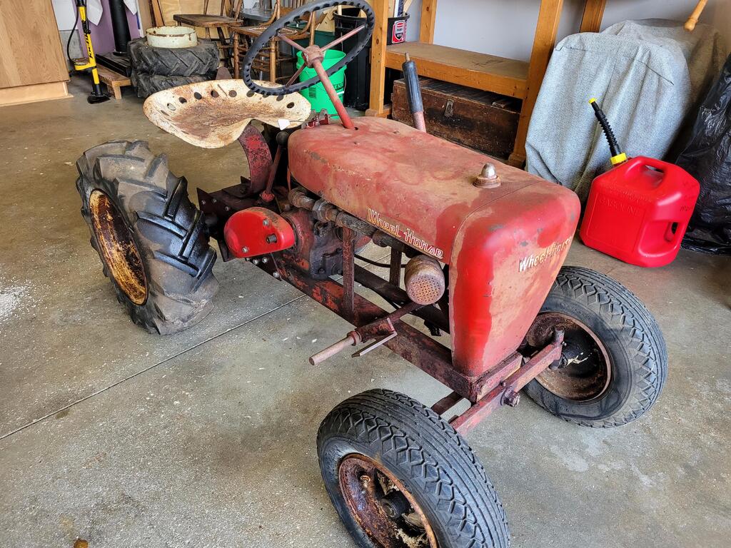

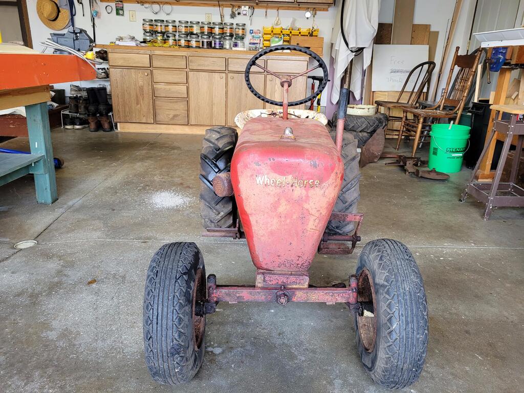

RichJ 29 #1 Posted August 13, 2021 Hello All, Here are a few pics of my first tractor (and first post), an RJ58 that I recently acquired from another member here in Illinois. It's in pieces now, while I scour the forum for info on how to restore or preserve it. The transmission is locked but it seems to otherwise have good basic bones, with no deep corrosive rust. I'm sure all the bushing and bearings will have to be replaced. The engine does turn. Opinions wanted. Should this be preserved or fully restored? What are the pros and cons of each philosophy? 20210810_171530.heic 20210810_171448.heic 20210810_171441.heic 20210810_171557.heic Share this post Link to post Share on other sites
RichJ 29 #2 Posted August 14, 2021 (edited) OK. I see my pictures didn't upload properly from my phone. My new S20 smart phone is saving pictures in Apple's HEIC format instead of Windows JPG format. I''ve got my phone set to convert them when I use the "share" icon, but it's not converting them when I just use the "upload" feature on the forum. I'll try to convert them manually later tonight when I get home and then re-upload them. Sorry for the inconvenience. I'm new to the forum and I still need to work the bugs out. Edited August 14, 2021 by RichJ 9 1 2 Share this post Link to post Share on other sites
Pullstart 71,078 #4 Posted August 14, 2021 @RichJ! An RJ58 is an awesome first garden tractor! As for preservation vs restoration… they are only original once. If it’s been repainted before, it’s fair game to do it again. Looking forward to seeing your new machine! round hoods rock! 2 Share this post Link to post Share on other sites

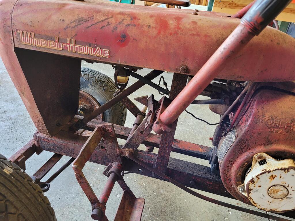

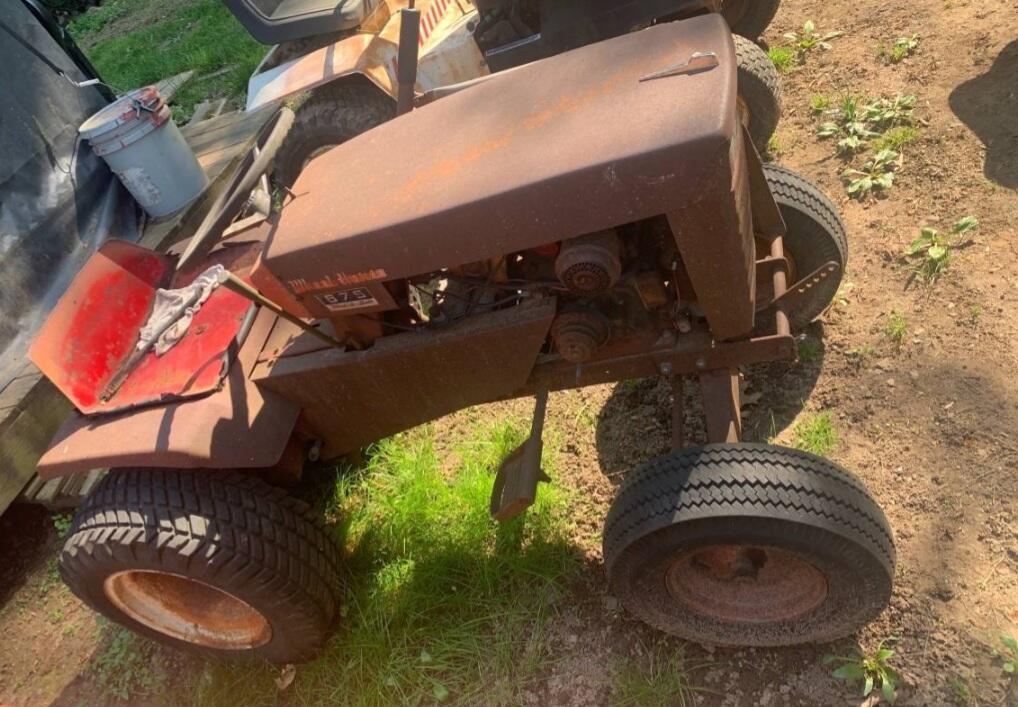

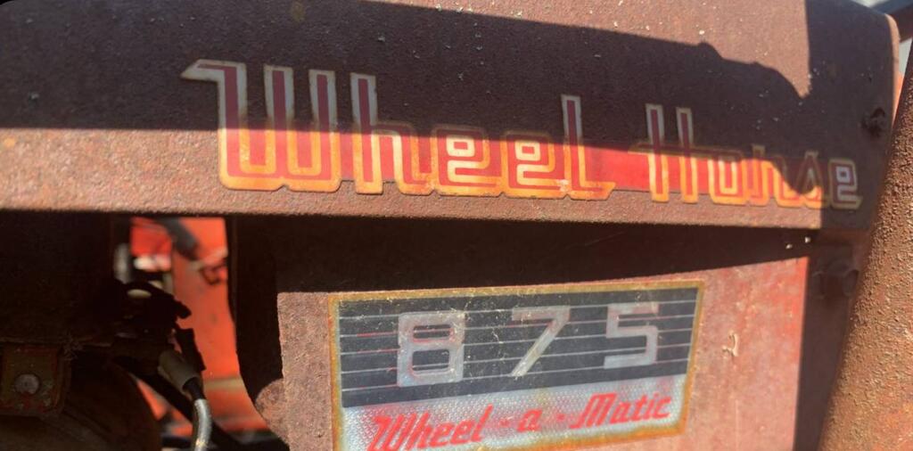

RichJ 29 #5 Posted August 14, 2021 (edited) My hood decals look different than others I have seed on RJs. Are they original? If not, what model and year are they from? Edited August 14, 2021 by RichJ Share this post Link to post Share on other sites

953 nut 68,442 #7 Posted August 14, 2021 7 hours ago, RichJ said: My hood decals look different than others I have seed on RJs. Are they original? If not, what model and year are they from? The question of restore or embrace the patina comes up quite often and my opinion is it is your and your decision. The hood side decals are from 1965 and would not be correct for a restoration, but as a survivor tractor the help tell the story of the RJ's life. 2 Share this post Link to post Share on other sites
AMC RULES 37,259 #8 Posted August 14, 2021 '65 example here. 1 Share this post Link to post Share on other sites
WHX?? 57,753 #9 Posted August 16, 2021 On 8/14/2021 at 6:52 AM, 953 nut said: but as a survivor tractor the help tell the story of the RJ's life. Never quite thought of it that way Richard thanks. What's not to like about the onion in the exhaust.... easy engine removal perhaps? Rich plenty of help here to fix any problem you have with her. 1 Share this post Link to post Share on other sites

RichJ 29 #11 Posted August 23, 2021 Yes, I've already ordered a repro heat shield and two axles for the 5003 transmission. Also found some nice rear hubs on ebay. The set screw on one of my hubs worked loose and was driven that way. Thus, the axle end was grooved and the keyway damaged. The ballast in one of the front tires was leaking pretty badly. The bead seat and valve hole are compromised. Will be looking for new front rims too. The engine rebuild is on the back burner for now. 1 Share this post Link to post Share on other sites

953 nut 68,442 #14 Posted August 24, 2021 17 hours ago, RichJ said: The ballast in one of the front tires was leaking pretty badly. The bead seat and valve hole are compromised. Will be looking for new front rims too. If it isn't to the point of being completely gone a rim can be saved with JB Weld. Here are a few threads to look at on saving a rim. https://www.wheelhorseforum.com/search/?q=JB Weld rim&updated_after=any&sortby=relevancy&search_and_or=and Share this post Link to post Share on other sites

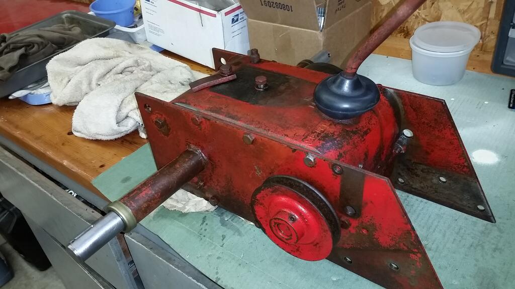

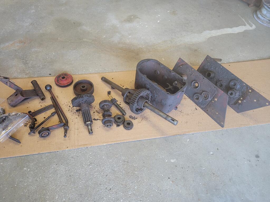

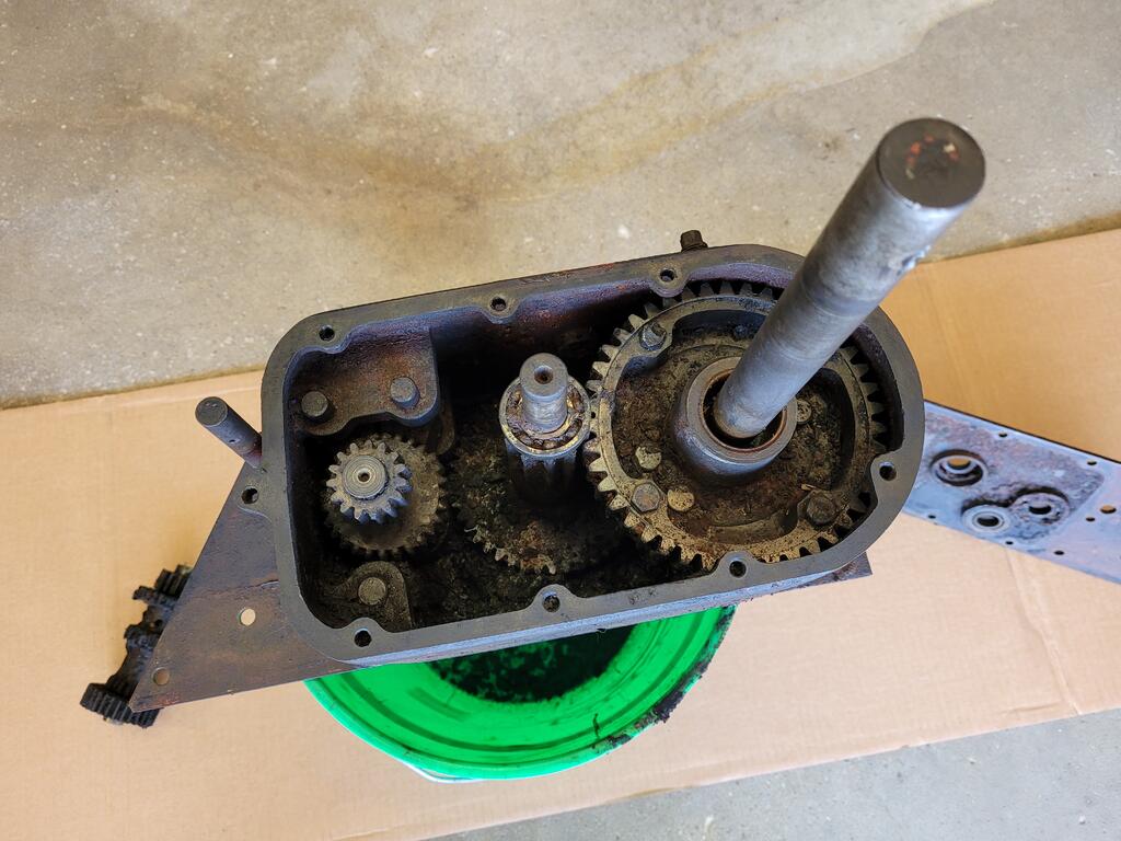

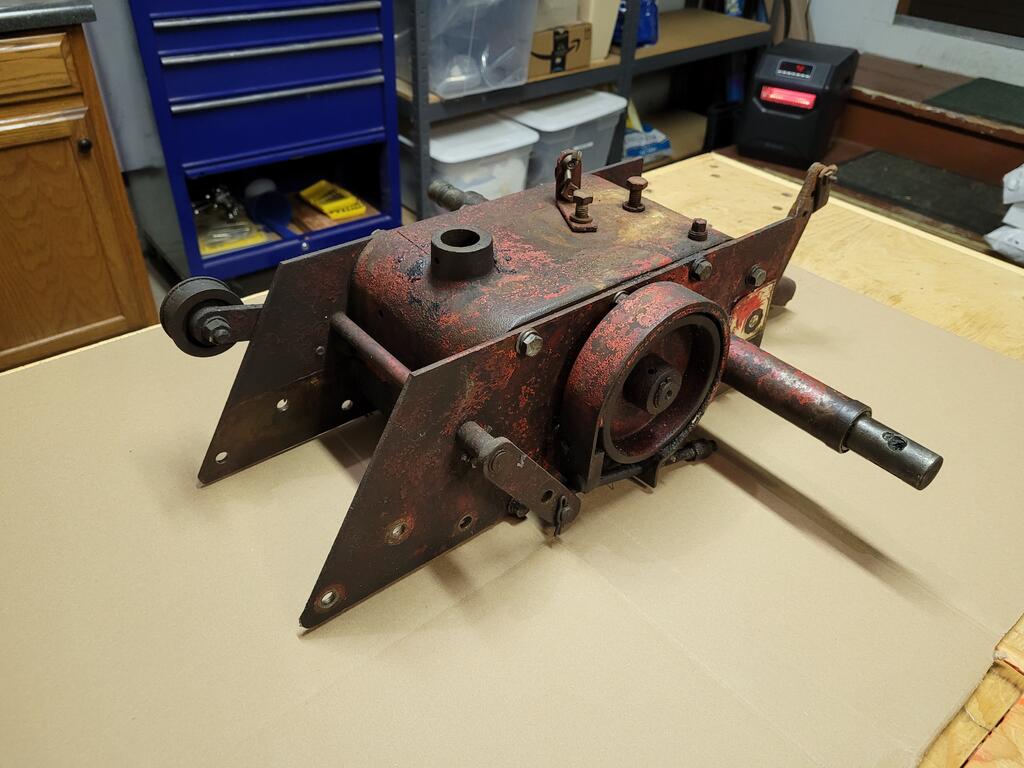

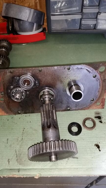

RichJ 29 #16 Posted March 21, 2022 Spring is here. The saga continues... The shifter fork on the outer pin slides forward and backward and right to left freely. The fork and whole pin move. The fork on the inner pin slides forward and backward but not right to left. The inner pin doesn't move right to left like the outer pin does. Is this normal or is the inner pin frozen? Is the inner pin supposed to be fixed? 3 1 Share this post Link to post Share on other sites

953 nut 68,442 #18 Posted March 21, 2022 8 hours ago, RichJ said: The inner pin doesn't move right to left like the outer pin does. Is this normal or is the inner pin frozen? Obviously the transmission has seen better days and will need a lot of love along with some bushings and bearings. Too bad you didn't do this tear down last fall so that the parts could soak in a bucket of diesel fuel all winter long (price was lower then too). I don't think heat or using force would be the answer. Put everything in a five gallon bucket and add enough diesel to cover what were supposed to be moving parts, cover it so critters don't get in and check the progress in a month or so. 1 Share this post Link to post Share on other sites
Racinbob 13,106 #19 Posted March 21, 2022 I replied in your other thread on this. You are correct that, at this point, it's more appropriate in the transmission section. Maybe the mods can help out here. 5003 Trans Forks - Transmissions and transaxles - RedSquare Wheel Horse Forum Share this post Link to post Share on other sites
stevasaurus 23,802 #20 Posted March 21, 2022 @RichJ I combined your 2 threads and moved the (now 1) thread into the "Transmission Section". This is a long thread, but it is all here about the #5003. Take the time to go through this thread. I see you are in Sycamore, Elgin here. We may have met at the Pioneer Tractor Show sometime. Did you buy that RJ from Joe??? 1 Share this post Link to post Share on other sites

WHX?? 57,753 #23 Posted March 21, 2022 Bearings & seals can be had here https://wheelhorsepartsandmore.com/product-category/manual-transmissions/ 2 Share this post Link to post Share on other sites
RichJ 29 #24 Posted March 22, 2022 Thanks for all the information, guys. I'll need it. Dino, I don't think we've met because I've never been to the Pioneer Tractor Show. Got my RJ from a guy in Peoria, but I don't remember his name. He said he bought it a larger lot of other Wheelhorse stuff that he was more interested in. This is my first tractor, but I'm fairly comfortable tackling something like this. I worked on lots of mini bikes and mopeds as a kid, and I worked in a bicycle shop for nine summers. From what I can tell so far, rust may be more of a problems than actual wear. Many of the gears look really nice, but others have a little corrosion. Somebody has probably been in this case before because the side plate bolts had mis-matched washers. In any case, I'll update this thread as I make progress. 1 1 Share this post Link to post Share on other sites
oliver2-44 11,694 #25 Posted March 22, 2022 Your front rims were only used from 1958 to 1961. They are getting harder $ to find. Most were shipped from the factory with calcium chloride for ballast which is corrosive. I’ve used fiberglass to repair some really bad ones. LB Weld or just Bondo works on the heavily pitted ones. Post some pictures when you get to that part. Also If you haven’t already bought new axles you can flip then and drill new roll paint n holes. When you get your gears all cleaned up post closeup pictures of each one. These guys can tell you what will work. For a show cruiser you can put up with a little pitting. 1 Share this post Link to post Share on other sites
