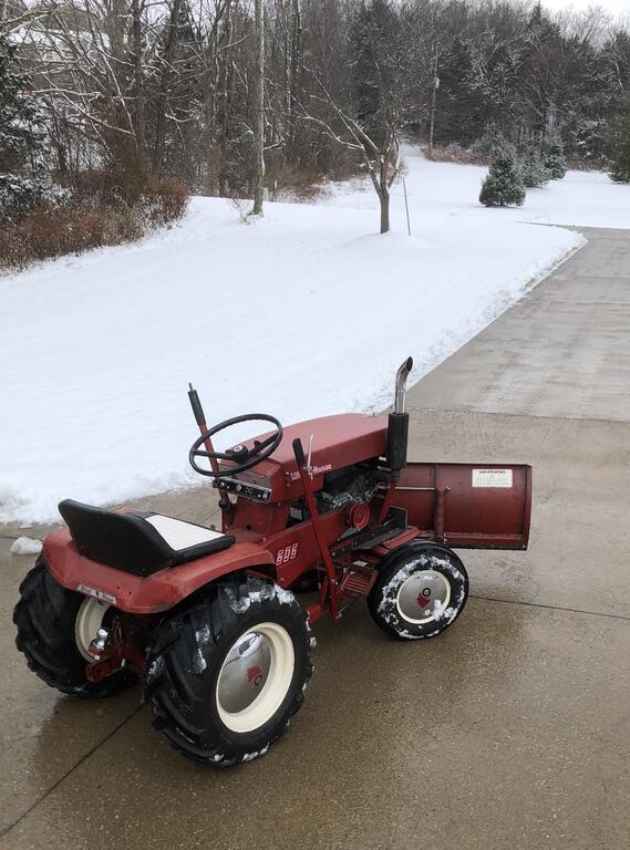

Vurge 158 #1 Posted August 7, 2021 (edited) Thanks to the advice of the friendly folks here, my 656 is done. Currently has a 6.5hp Predator engine with a golf cart starter generator and a small ATV battery. Drive pulley increased to get a maximum speed of about 8mph. Last week I installed a Delco copy mechanical voltage regulator and mounted an inch thick steel plate for the front weight. Here's a pic from this morning. That's a homemade 35 gallon tank traiker. I sprayed two tanks yesterday and three this morning in our 25 acre orchard. ZERO problems. Used less than 2 gallons of gas too! Edited August 7, 2021 by Vurge 7 7 2 Share this post Link to post Share on other sites

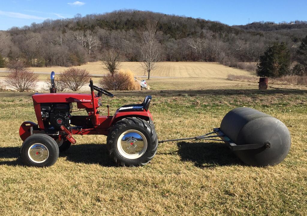

cschannuth 3,819 #2 Posted August 7, 2021 (edited) Very nice. You are going to love that Predator. Had mine for years and it still starts on the first pull every time. I upsized the pulley too and it has tons of power and torque and easily pushes heavy snow at 8 mph as it sips fuel. It easily pulls my 700lb lawn roller too. Edited August 7, 2021 by cschannuth Photos 8 Share this post Link to post Share on other sites
