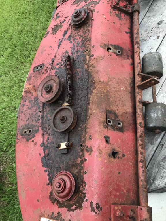

Has anyone rebuilt a 42” Side Discharge Deck with new spindles and pulleys? I’m looking around at OEM and the ones I am seeing are in no better condition than mine. I would think someone has done this. Thank you for any help!

I have rebuilt a deck in near similar shape as yours. The pitting on the top will take some work. It's best to take a abrasive disk to the entire deck to get rid of all paint and loose rust.
The most challenging part was filling in the pitted area on top with jb weld and sanding in all down smooth so the slider bar will function correctly. Shown are before and after.
As for spindles I went away from the DD style you have now  and went to the 3/4" keyed style.  I believe K and B horse parts is a good source  and A-Z  tractor were my best sources for replacement spindles and pulleys. Someone correct me but I think @Lane Ranger makes the slider blocks you need.

I think I’m going with POR15. Should flow out pretty smooth enough.
