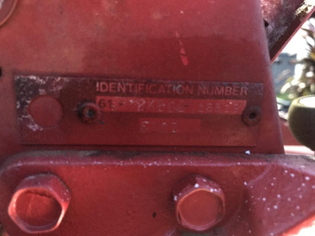

Ben Anderson 1 #6 Posted August 7, 2021 (edited) I feel like I’m getting closer but I’m still confused on what I’m looking at. How do I know the number? Edited August 7, 2021 by Ben Anderson Share this post Link to post Share on other sites
Jeff-C175 7,199 #7 Posted August 7, 2021 14 minutes ago, Ben Anderson said: How do I know the number? Clean the paint off with some acetone and the numbers are stamped into that metal plate. Share this post Link to post Share on other sites
Ben Anderson 1 #8 Posted August 7, 2021 (edited) 61-24802-16519 610Z Edited August 7, 2021 by Ben Anderson Share this post Link to post Share on other sites
gwest_ca-(File Mod) 11,033 #9 Posted August 7, 2021 The tractor model number is 61-12K802 which is a 1976 model. The 1976 42" side discharge deck was model 65-42MS01 or 65-42MS02. The tractors did not come with a deck so the dealers would add what they had in stock at the time. It could be a 1975 model deck or one later if the original sale was not made in 1976. These decks all look the same including the last in 2012. It is the bearings that changed the most other than the hole in the blade. In the mower spindle charts if you click on a model number it will take you to a page that shows the original spindle and any replacement designs that followed. Garry Share this post Link to post Share on other sites
