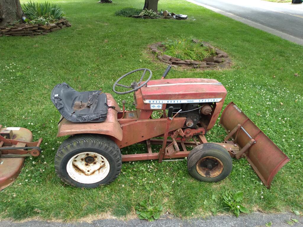

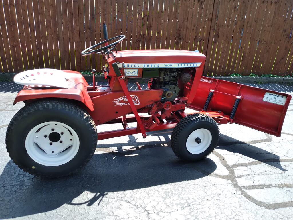

D_Mac 9,136 #1 Posted August 4, 2021 Well here is a photo of when I went to see it and a photo of as it is today. In between then it received... New head gasket New points, condenser, and coil Cleaned and rebuilt carb Air filter 4 New tires with tubes New fuel lines and tank cleaned New engine and transmission oil New drive belt New spark plug New seat Drive belt cover welded Paint touched up 6 9 1 Share this post Link to post Share on other sites
SylvanLakeWH 27,498 #2 Posted August 4, 2021 Nice job! 1 Share this post Link to post Share on other sites
ebinmaine 70,696 #3 Posted August 4, 2021 Fantastic transformation!! 1 Share this post Link to post Share on other sites
Retired Wrencher 5,635 #4 Posted August 4, 2021 D_Mac nice job on the resto. Looks much better. How does the Tecky run? Share this post Link to post Share on other sites
Pollack Pete 2,273 #5 Posted August 4, 2021 Sure was a sad sack when you got it.Sure is purdy now!!! I like it. 1 Share this post Link to post Share on other sites
D_Mac 9,136 #6 Posted August 4, 2021 1 hour ago, Retierd Wrencher said: D_Mac nice job on the resto. Looks much better. How does the Tecky run? It runs great. Always starts on second pull. Steering is nice and tight. The brake band came unglued, I need to take care of that. It really is a nice machine. Share this post Link to post Share on other sites
