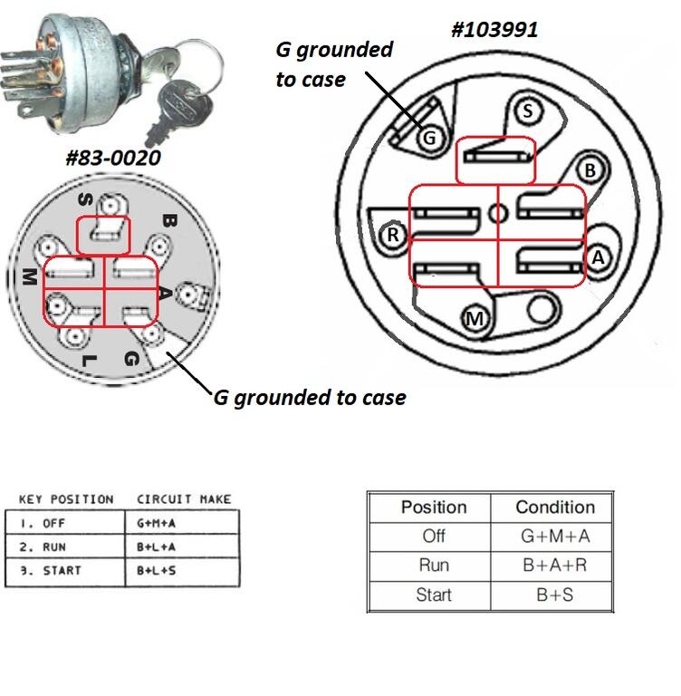

TC10284 119 #1 Posted August 1, 2021 Just fixed up a 1987 312-8 with model number 21-12K804 Runs great. Issue I have now Is that the original key switch will allow the voltmeter to work, but the seat switch and the parking brake lights stay on constantly and as soon as I turn the key to Run. The other issue with this key switch is that it does not kill the engine when I switch to off. OK, so I swapped the key switch with another NEW, 5 pin key switch. That fixes the seat switch and the parking brake light issue, and the test switch lights up all lights correctly. However, with the new key switch, the voltmeter refuses to work, and turning the switch to Off still does not kill the engine. I have checked and cleaned the negative battery ground to the chassis. The two fuses are new, not blown. I'm not sure what else the issue could be at this point. Share this post Link to post Share on other sites
gwest_ca-(File Mod) 12,471 #2 Posted August 1, 2021 The parking brake light and the voltmeter are powered by the same circuit. The common between the voltmeter and the ignition switch is the ground. What part number ignition switch did you use? Garry Share this post Link to post Share on other sites
TC10284 119 #3 Posted August 1, 2021 I have been using one of these on this specific one, but similar have worked OK in my others WH that require 6 terminals on the key switch. https://www.amazon.com/dp/B073GCH7LV/ref=cm_sw_r_cp_apa_glt_fabc_YT7VQTVK33ZG3TVD76WJ?_encoding=UTF8&psc=1 Share this post Link to post Share on other sites
953 nut 68,615 #4 Posted August 1, 2021 Check out this thread; 1 Share this post Link to post Share on other sites
gwest_ca-(File Mod) 12,471 #5 Posted August 1, 2021 You have the wrong switch. I am surprised you have not smoked the ignition coil. Should be using the 103991 switch. Added the unique 5-wire connector in red. 1 Share this post Link to post Share on other sites
