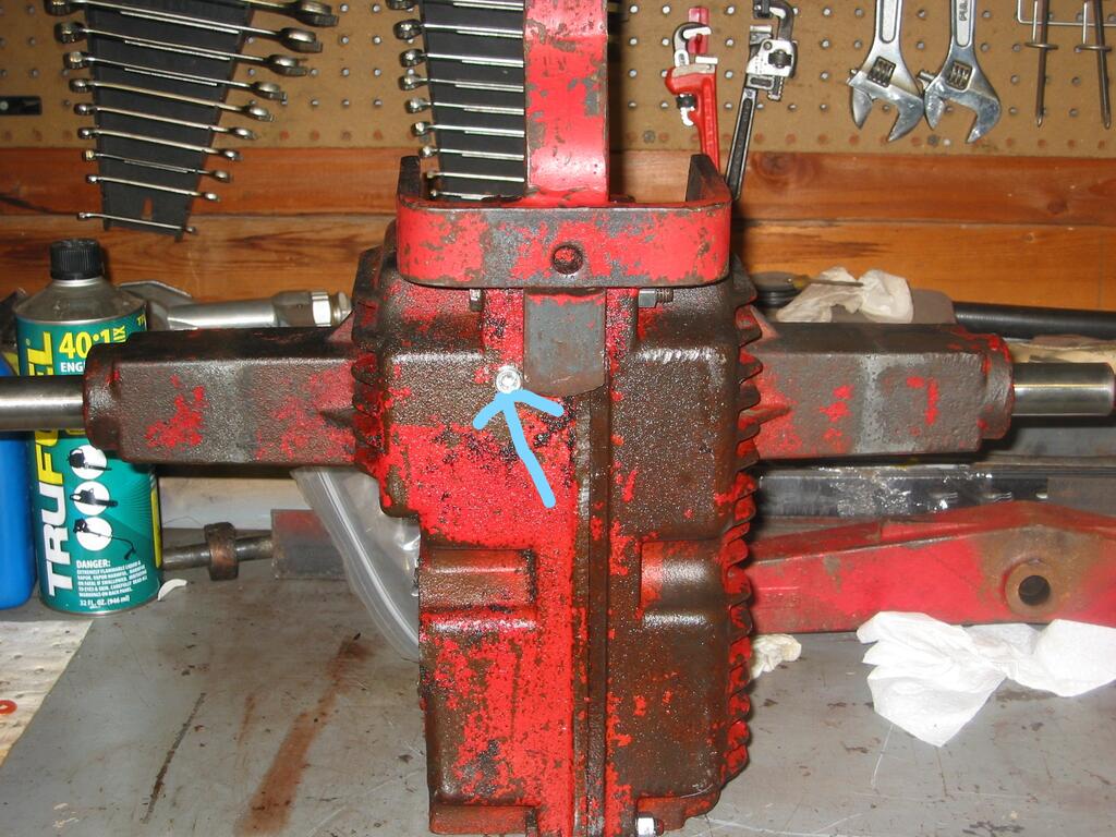

ebinmaine 69,707 #2 Posted July 27, 2021 Drain plug is on the very bottom right next to where the hitch contacts the case bottom. 8 speed fluid is 2 qts of the least expensive 80W90 gear oil you can find. If it's muddy or has water be sure to replace the shift boot too. 👍 2 1 Share this post Link to post Share on other sites
pfrederi 18,178 #4 Posted July 27, 2021 1/4" allen wrench needed 3 1 1 1 Share this post Link to post Share on other sites

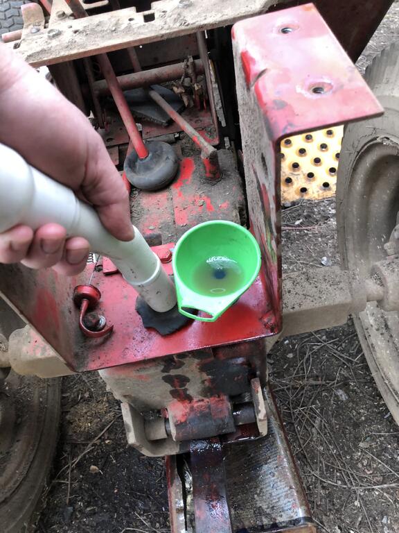

EB-80/8inPA 1,753 #11 Posted August 20, 2021 (edited) The flow rate of the gear oil into that tiny dipstick opening was so frustratingly slow, I removed one of the nuts and stuck a vacuum hose over that hole. This worked surprisingly well. Caution: unless you can get the input line way down in there, some of the oil will get sucked directly from the funnel into the hose, and cleaning that is probably impossible. Use the Crapvac®️. This will save time. Edited August 20, 2021 by EB-80/8inPA Dupe 1 Share this post Link to post Share on other sites
EB-80/8inPA 1,753 #12 Posted August 20, 2021 (edited) I suppose it’s possible the oil could get sucked into the works and catch fire, so you might want to consider that risk as well. And that “gasket” under the hose is the old shift boot repurposed. Edited August 20, 2021 by EB-80/8inPA 1 Share this post Link to post Share on other sites
ebinmaine 69,707 #13 Posted August 20, 2021 8 minutes ago, EB-80/8inPA said: vacuum hose Interesting idea. Share this post Link to post Share on other sites
