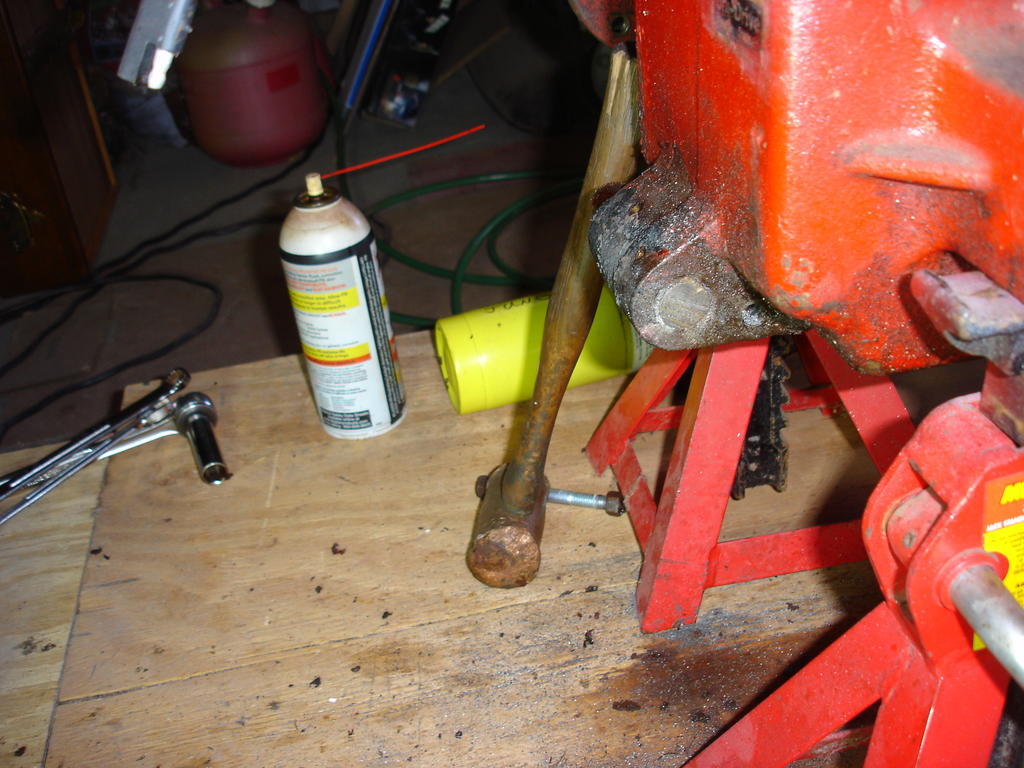

vogli 86 #1 Posted July 22, 2021 So I removed my transmission from my tractor...but, before I can split it, I have to take the rear lift thing off (clevis?). What exactly do I call it? Anyway, it spans both sides of the transmission, and with it in place, I can't open the transmission. I don't see how it comes off. I don't *see* any roll pins. The lift isn't like any of those shown on the IPLs I've looked at. See picture. The pin extends out from the left side of the clevis, and is flush on the right. The visible part of the pin apears to have a groove, as if maybe it was supposed to have a snap ring or something on it - it doesn't now. I can't drive the pin through the clevis. I've not tried really hard yet, but it does appear slightly mushroomed as if someone tried that in the past. Anyway, I thought I'd ask for advice before I do something stupid. Is there some obvious trick to this that I'm overlooking? Share this post Link to post Share on other sites
RandyLittrell 3,887 #2 Posted July 22, 2021 (edited) It normally has 2 E clips and you push it out from one side or the other. Somebody has already beat the daylights out of it from what I can see. I would douse it in Kroil or PB blaster over the next few days. you can heat the case up too, just don't get carried away. If you have a sawzall, I would turn it over and cut that pin on the inside of the lift to free it, then work on the pin. Randy Edited July 22, 2021 by RandyLittrell 3 Share this post Link to post Share on other sites
