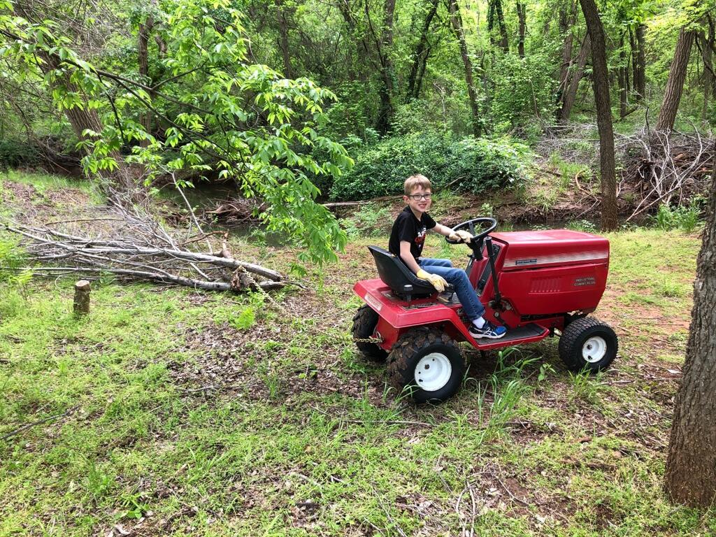

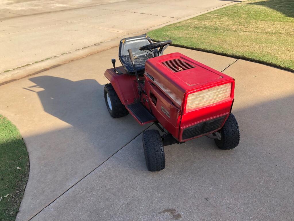

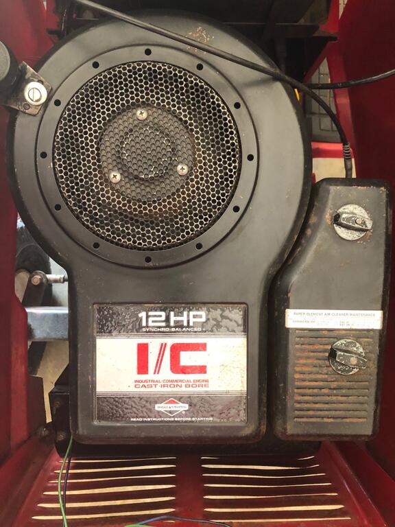

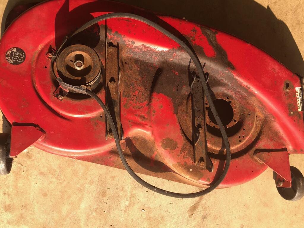

OutdoorEnvy 1,733 #1 Posted July 21, 2021 This was a fun save project with my 8 year old son, Jack. This would be his tractor so he can have some fun and help out with yard/land work...and have a good learner tractor that if he crashed into something or whatnot I wouldn't lose my mind over it! Ha! So we picked up this MW 12/38 Industrial Commercial series lawn tractor for $40 over this past winter. Had the good Briggs flathead cast iron series engine. Typical story of hadn't ran in who knows how long and owner needed it gone. It was all there so we picked it up. Didn't take much really to get it going, we rebuilt the carb, replaced fuel lines and cleaned out the gas tank, basic oil change, air filter, and spark plug, new battery. Once we knew we had a solid runner we did pull the head and clean it, set the valve clearances and new head gasket. Really the biggest expense was 4 new tires. We did use some ATV style ones for the rear just for some added traction. We'll save the 38" deck project for later, it needs rebuilt but we'll let Jack get used to driving it for now. Overall the tractor turned out good and Jack loves it! It was a fun project with him. My wife joked that I must be getting impatient for a first truck project when he's 15, LOL! She's probably right...Well anyways here's some pics after we were all finished up. It is red so thought it would be okay to post it up here! thanks for looking! 7 3 1 Share this post Link to post Share on other sites

Jeff-C175 7,203 #3 Posted July 21, 2021 (edited) Dig that Yuge headlight lens! Need some cool multi-color LEDs behind that! Jack would love that! Edited July 21, 2021 by Jeff-C175 2 Share this post Link to post Share on other sites
OutdoorEnvy 1,733 #4 Posted July 21, 2021 35 minutes ago, Jeff-C175 said: Dig that Yuge headlight lens! Need some cool multi-color LEDs behind that! Jack would love that! He really would. We did replace the lights and they do work. Didn't think thoug to do multi-color...we'll add to the list for future upgrades 1 1 Share this post Link to post Share on other sites
