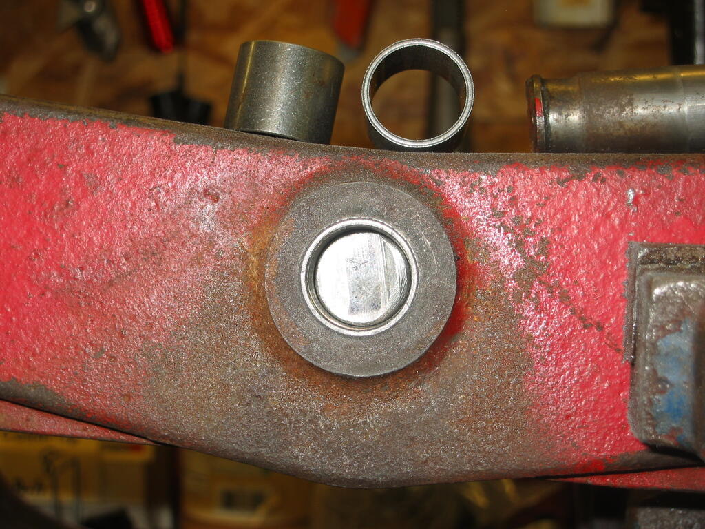

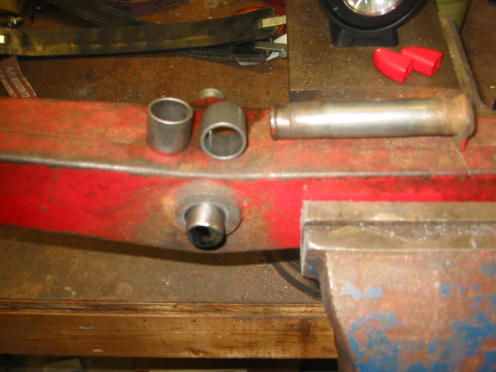

pfrederi 18,108 #4 Posted July 18, 2021 Probably worn pivot pin for the front axle. Pull the pin and see if it has grooves worn in it. I redid a Charger. Made a new pivot pin out of 3/4 stock. Drilled out the center hole in the front axle to 7/8" and pressed in to sleeve bearings (7/8 OD 3/4 ID) now nice and tight 5 7 Share this post Link to post Share on other sites
